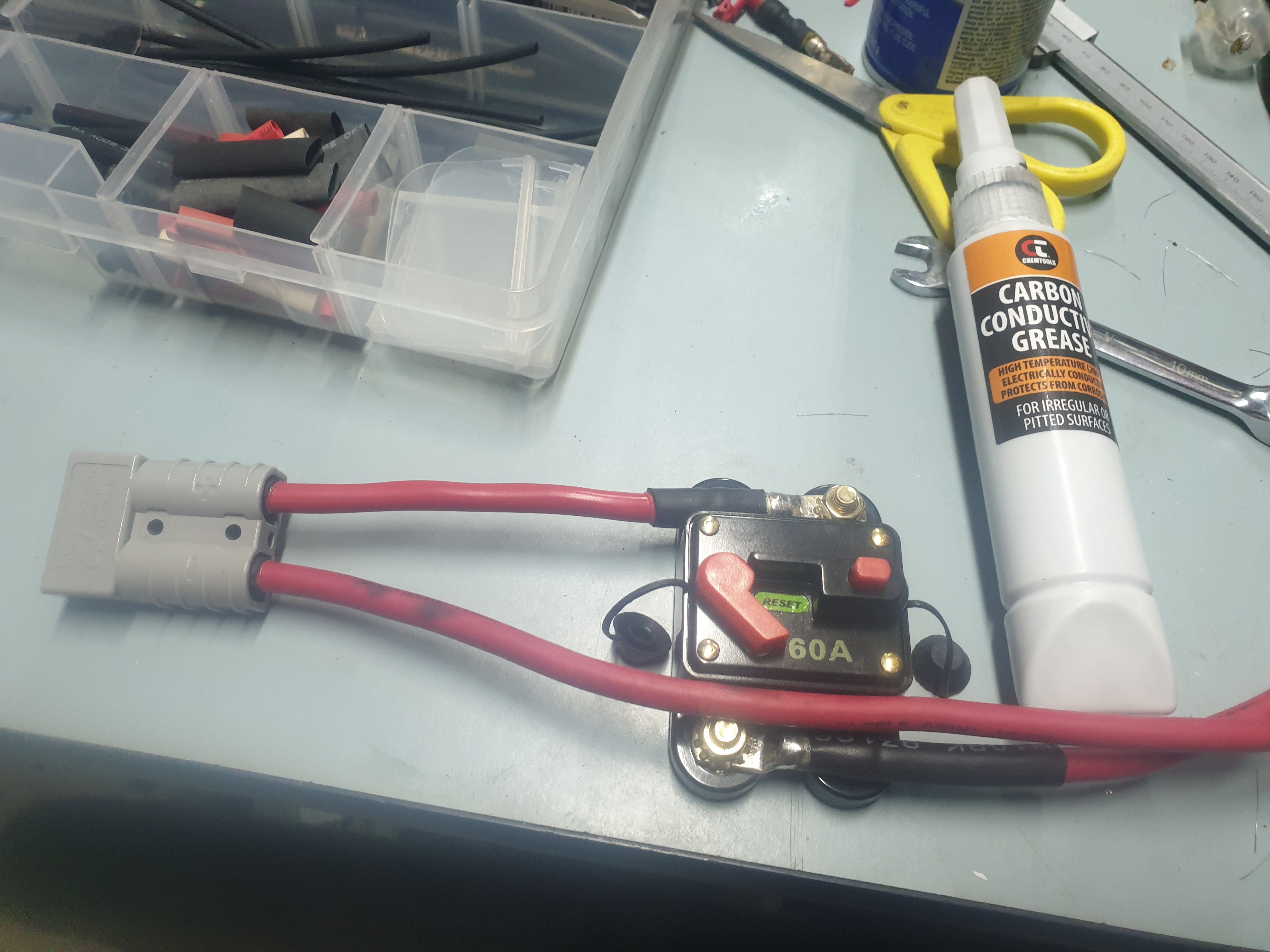

Re-doing my pot winch connections as they had corroded badly.
I have an inline circuit breaker which attaches via an anderson plug on the removable winch switch to a permanently mounted anderson plug on the boat.
I am considering using a bit of carbon conductive grease under the nuts on the breaker and then coating the nuts and posts with a sealer - possibly starbrite liquid electrical tape - which I already have.
Also thought of using a drop of carbon grease on the anderson connectors.
Any thoughts of pros or cons on the above

Finished the re-wire of the winch
Sun, 2021-08-01 10:15
 Finished the re-wire of the winch. Ended up going with soft seal and It looks like it will work well. Also used the anderson rubber boots with a cap. They look like they will keep water out when connected as well as own their own.Link to a picture below -  Had a spare breaker Stevo so will use it till it fails. Last one got 2 seasons. Winch seems to be winding faster now as well with all connections free of corrosion. Looked up Filko and will definitely get next breakers from him. Keep one on the boat for when this one fails  Link address https://imgur.com/a/RvgVGB3.  Cheers - Eric
