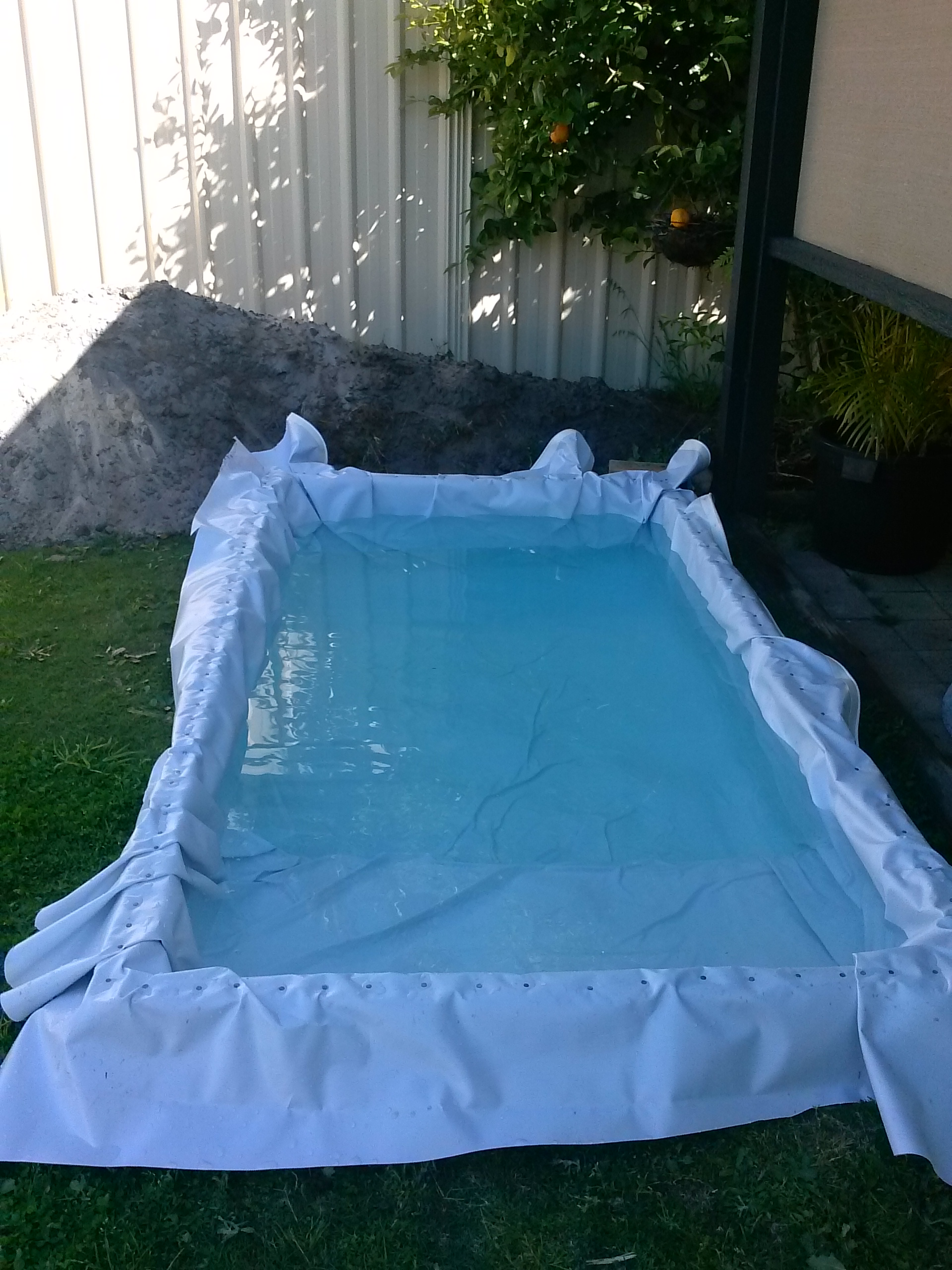

Liner laid. Filled and testing for leaks:

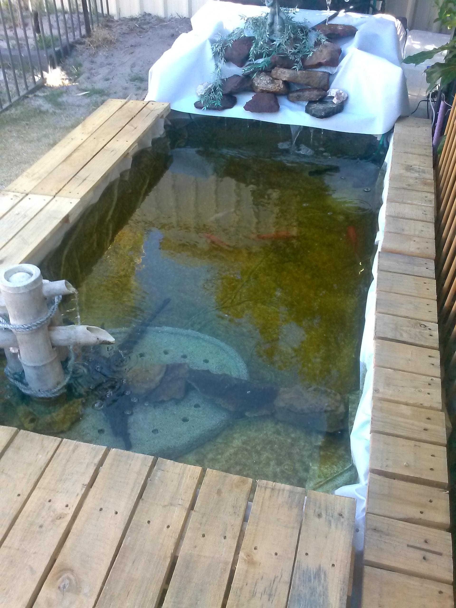

Nearly finished.  The "decking" is made from raw pine pallets which I got from work. Will be painting them a grey slate colour to match the Patio.

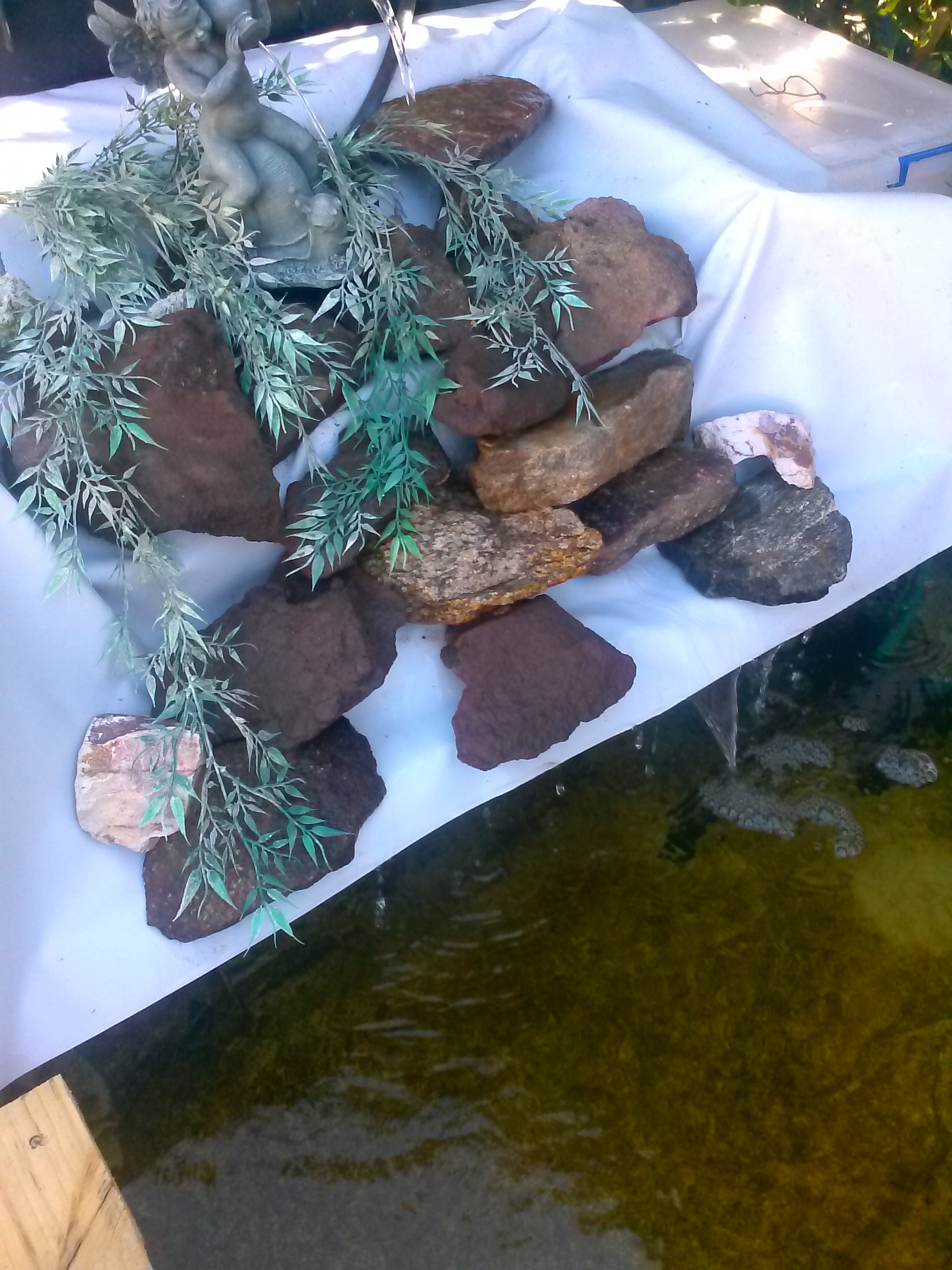

Waterfall & filter. The filter is a large black tub which sits behind the waterfall.  Water is pumped from the pond using 2 pumps. Will be buying a larger pump to increase waterfall flow.

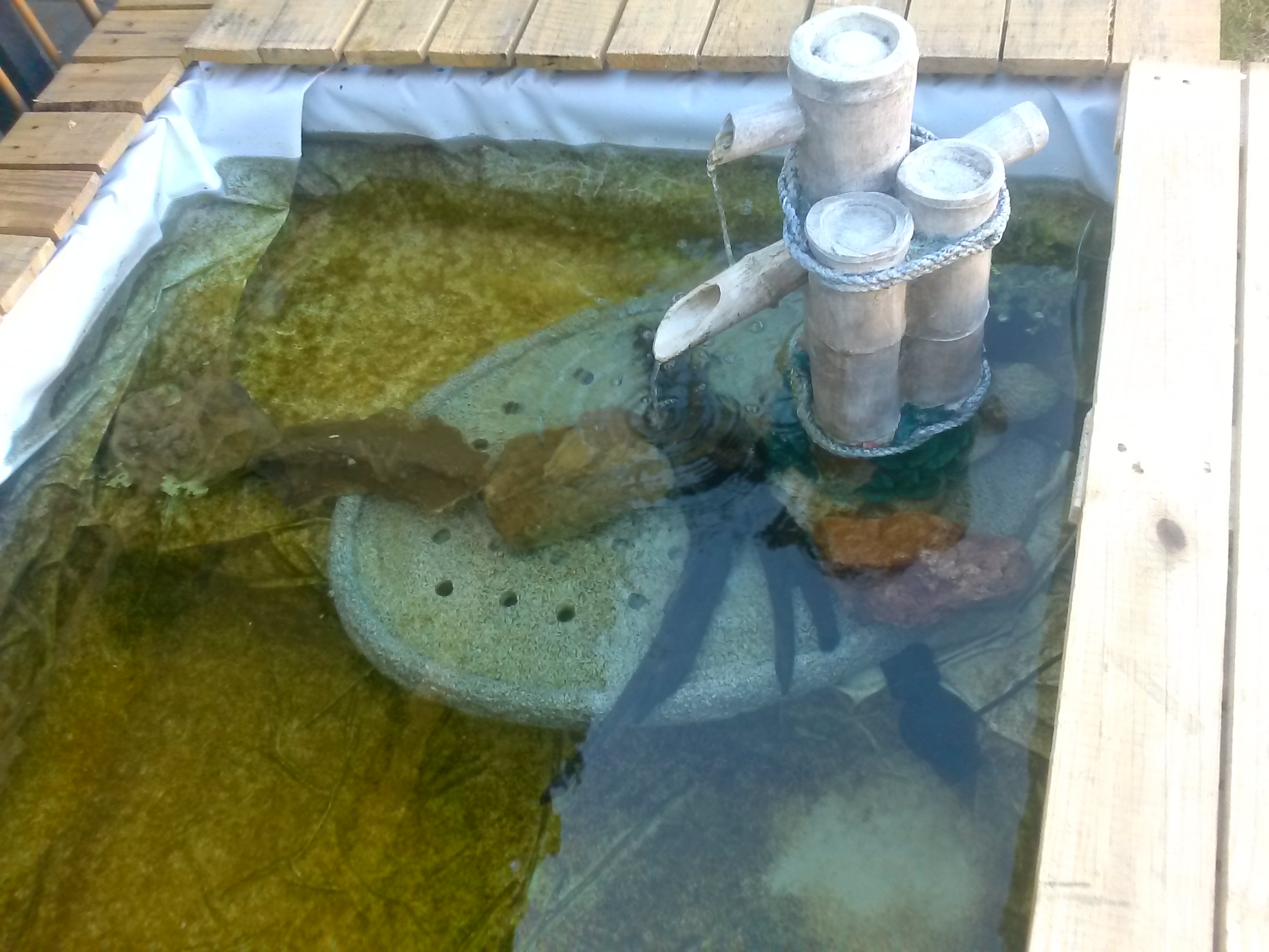

The shallow end. I'll be adding river pebbles to this section to add abit of contrast to the main pond area.
Inhabitants: 4 baby koi and 4 large goldfish.
Plants: Some duckweed and elephant ear plant in the filter box and a Blue money wort in the shallow area. Will be adding water lillies in the main section.
