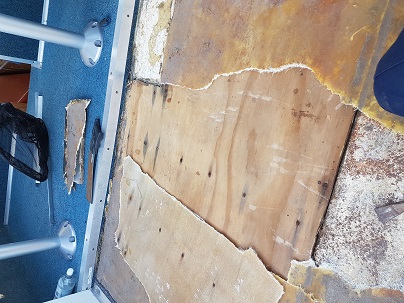

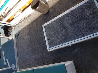

Unnoticed during purchase, and all through last season boating and fishing, the floor was just some wood thrown over the original rotted floor and screwed down onto it. Carpet over the top and no one even noticed.
Up came the fake floor, big holes and splits in the original floor underneath.

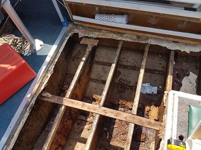

Through one of the holes in the floor I can see water trapped between bulkheads with no way out and the bulkheads feed spongy too.

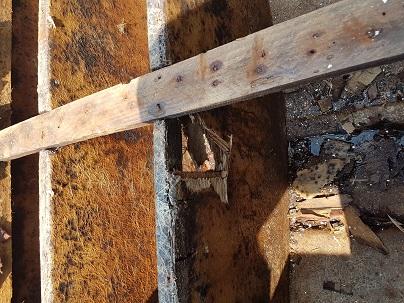

Original floor mostly out I removed a bulkhead and yes they all need replacing.

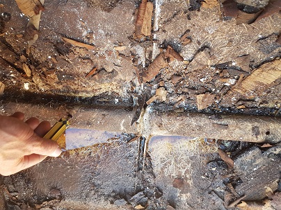

One strange thing I found was that the main stringer down the middle of the boat is hollow. I find it hard to believe that the wood could completely dissolve and noticed a small hole between each bulkhead. Passage for water to move to drainage point?
Wondering if anyone has ever seen anything like this before?
Photos of progress so far and plans ahead are to add storage and better drainage.
