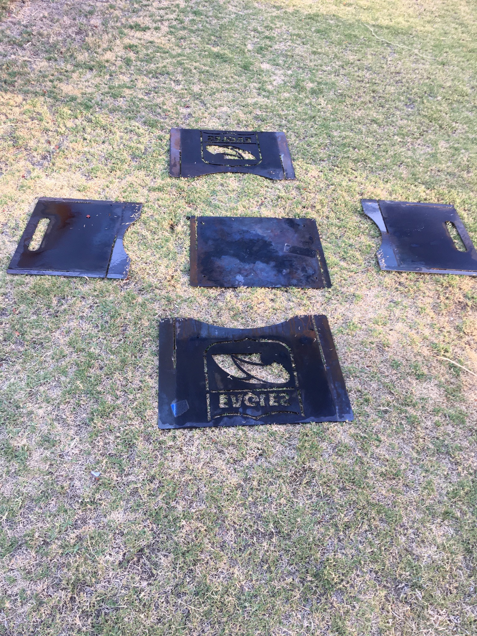

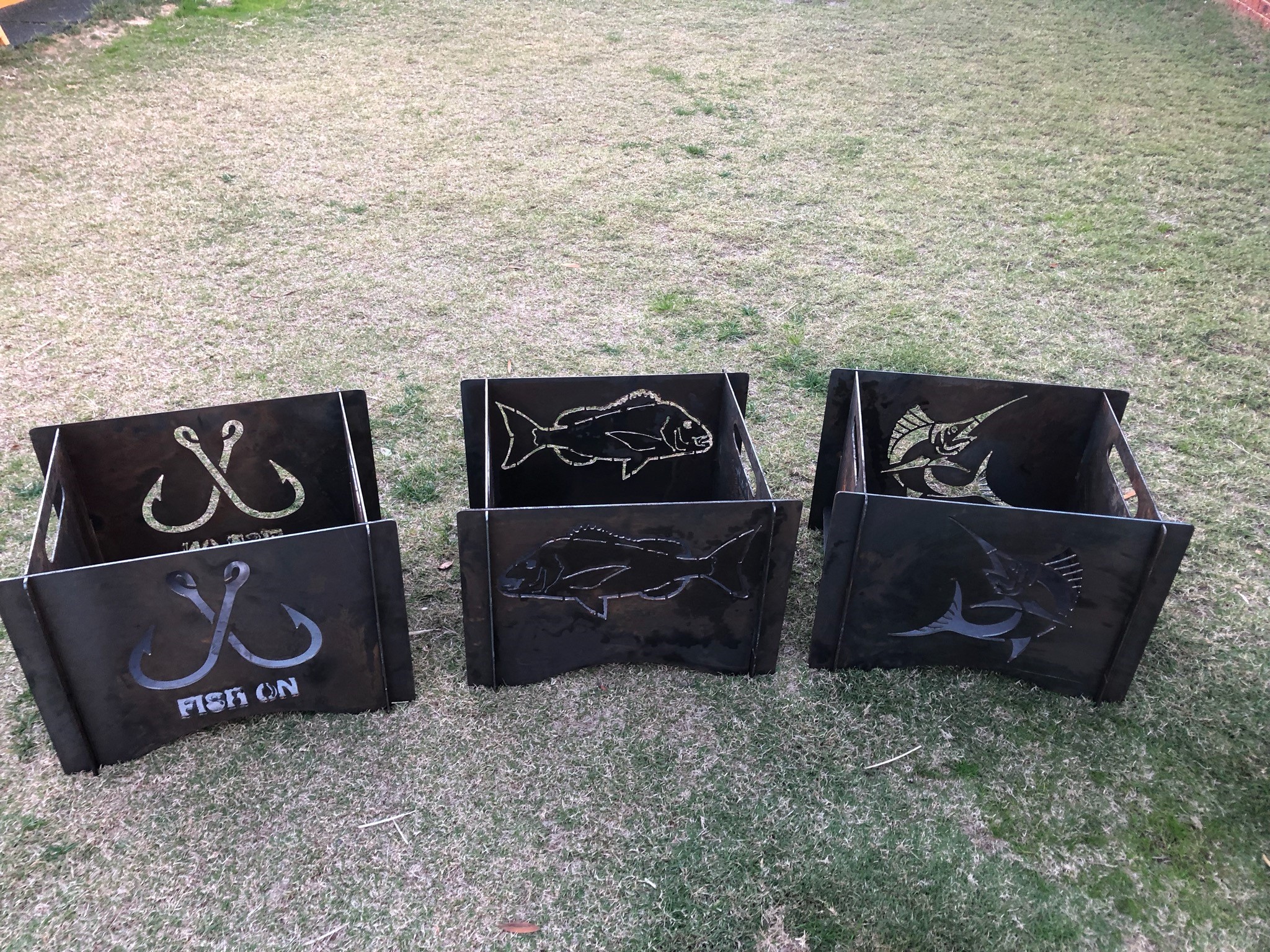

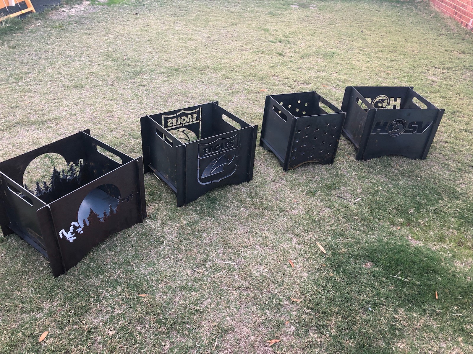

I recently started making a few of these collapsible fire pits.
Made from 3mm steel, 500w x 500d x 400h. Once you are finished, the fire pit can be collapsed into 5 pieces for easy storage.
Perfect to take camping or for your backyard. A standard from bunnings grill can also fit on top for a perfect BBQ cook up.
Currently I have most AFL teams, car brands and a few fishing outdoor designs available.

 You get someone to laser cut/water jet cut them? A bloke I was camped near at Ningaloo last year had one he'd made himself, just got the local fab shop to cut out  and add patterns of his design, but it cost him more than you are asking for yours.

 We do them up in auto cad
Sat, 2019-06-22 19:12
 We do them up in auto cad and cut out on a plasma cutter.

 Hi Russ, we actually started
Tue, 2019-06-25 18:14
 Hi Russ, we actually started with 5mm steel but the weight for  portable colapsable pit was way too much so brought it down a bit.
also being corten steel its ends up with this nice surface rust look but will not rust through.
