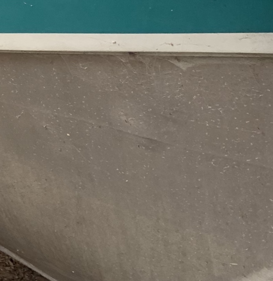

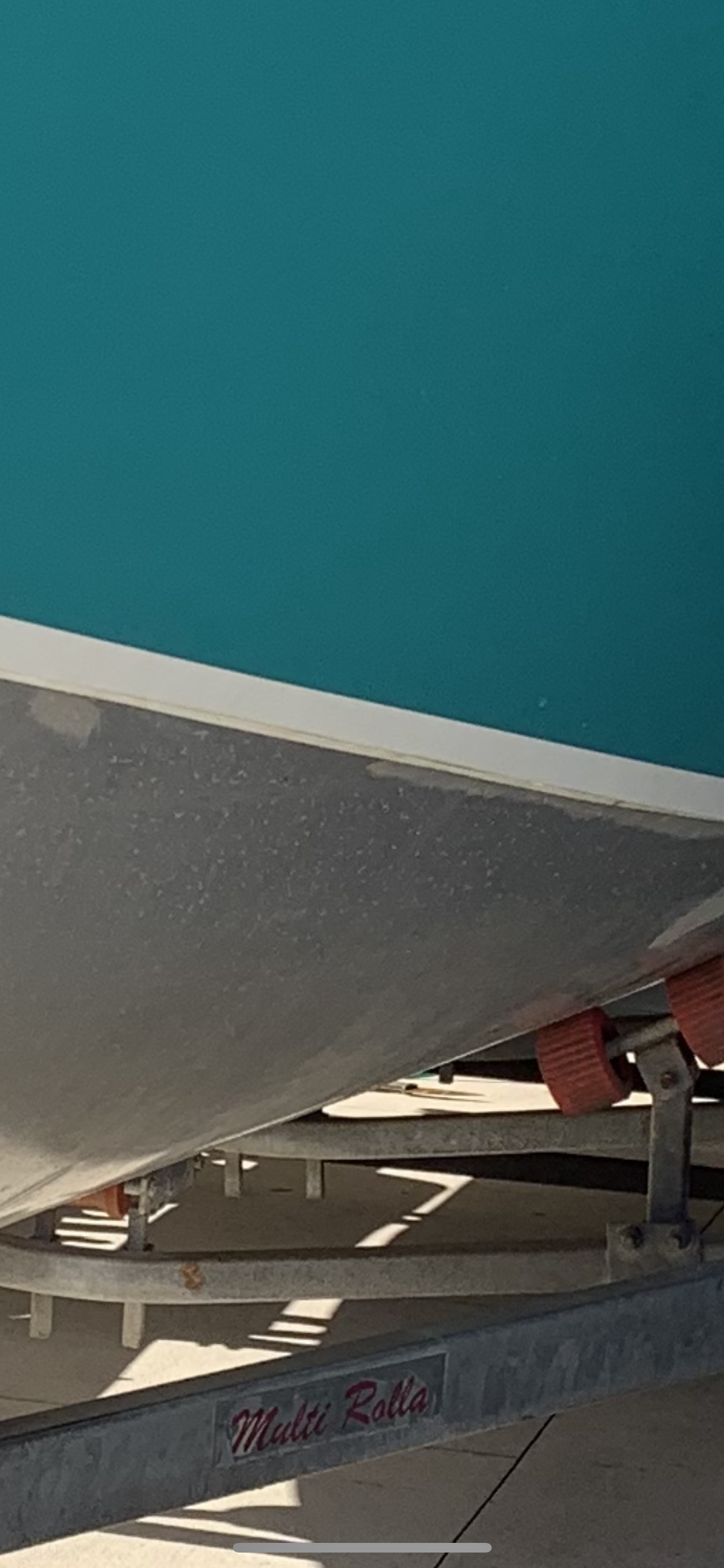

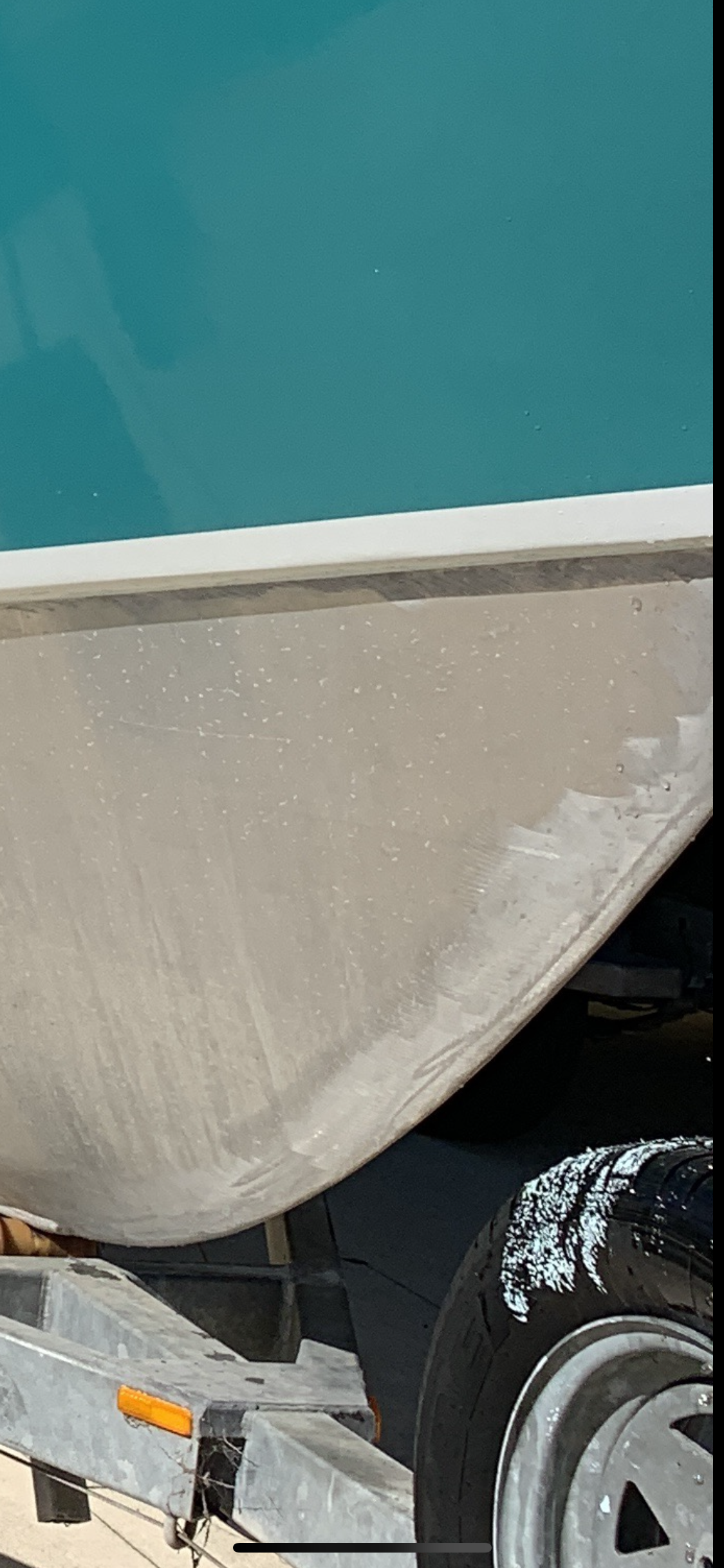

hey guys,
after doing slme reading and getting paranoid now im
curious if these spots on the bottom of the hull is a cause of electrolysis. I bought this boat after it was sitting in someone’s backyard for around 6 years and had this in there where I bought it. Help would be great also how do I remove it too :)

Looks more like tiny stone chip damage
Mon, 2019-12-09 13:59
Does the pitting reduce as you head further back on the hull if so this would pretty much confirm that conclusion.
Posts: 290
Date Joined: 22/05/19
 Nah it’s literally all over
Mon, 2019-12-09 14:39
 Nah it’s literally all over the bottom of the hull. I thought it was just salt crystal build ups nah nah. Might get some salt away on it and see if that works. But it’s not localised to one area

 run you fingernail over it
Mon, 2019-12-09 16:20
 run you fingernail over it if you get a small amout of "white rust" (looks and feels like a salt build up) then it is electrolysis.
areas like in your pic are usually only formed when the boat has a stray current IE some wiring is faulty and has earthed to the frame.  Multimeter time.
do you have a SS prop ?   if so is it getting pitted?

usually the SS prop is the first to show a stray current.  will turn white in a day of boating.  but if the current and wiring has been sorted you may need to just treat the affedted area.  (google)
corrosion is caused by contamination with another metal (sinkers, iron fillings, etc), a build up of gunk (alge etc in the bilge) .....both of these localise to a specific area and of course start from the inside out.  To combat this its a good idea to put some boatwash in the bilge at the ramp (bung in) put 20-50 l fresh water in and drive it home .....then rise at home.  do this every now an then.
but if you have corrosion starting on the outside it's almost always stray current.  (I guess.. was ...in your case)

Just got some hull acid wash
Wed, 2019-12-11 15:46
Just got some hull acid wash and all clean now. Found out the stabicraft  get this alll the time. But if ally cleaner and happy days
