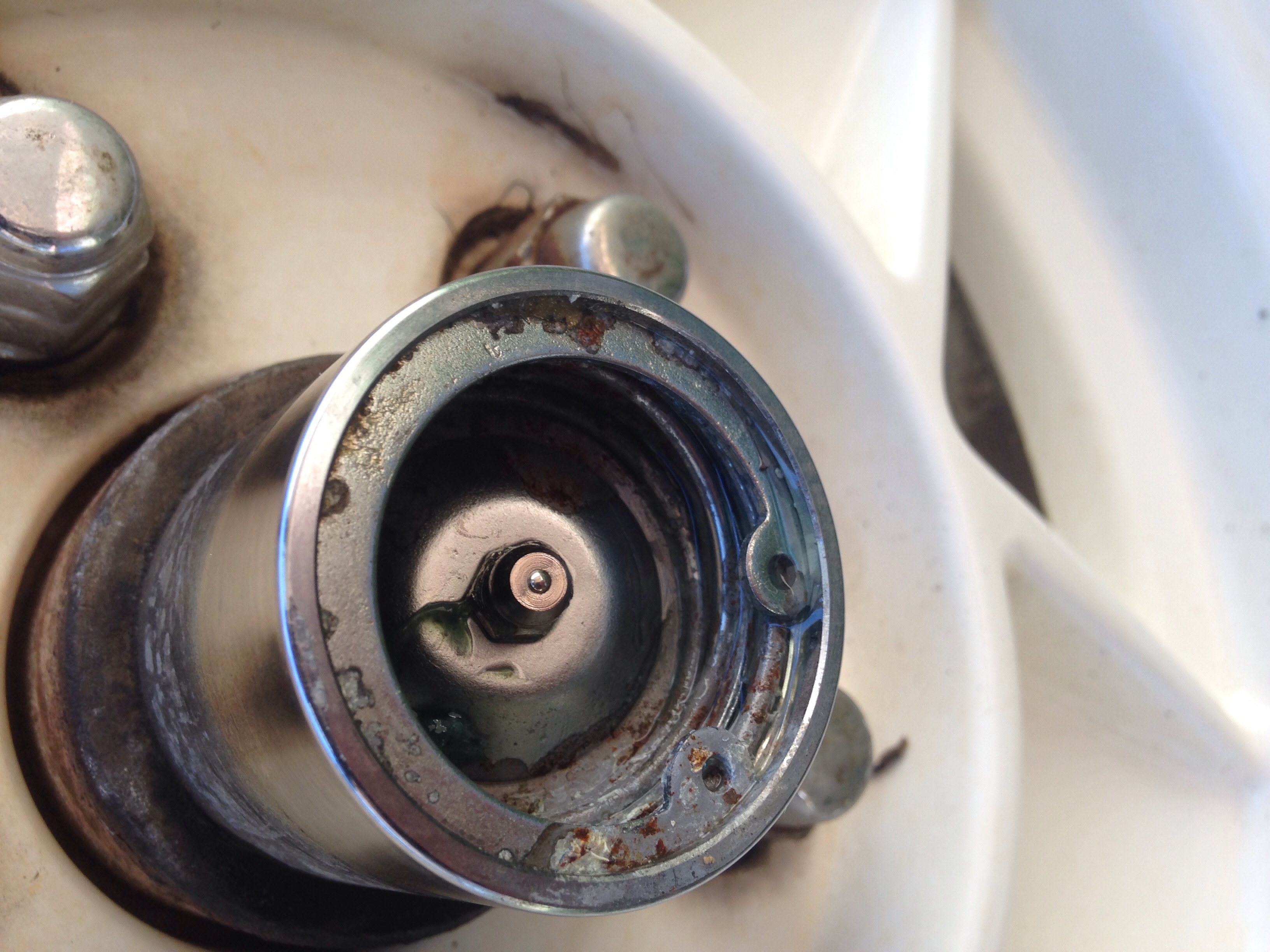

 Hey guys.
Lost the cap off my bearing buddy unknowingly. There's some slight corrosion on the outside around the spring of the bb. Do you think the bearing would be compromised?

on my current trailor I cant get the caps to stay on so I just gave up, easy way to check is- take the BB off and inspect the colour of your grease if its brown then it is time to change your bearings, note you will only be able to see the outside bearing without taking the hub off so if your rear seal has failed water can get in that way too.  I usually change mine annually regardless as I do a few kilometeres
it might be the angle of the photo but it looks like you may want to pump some grease into then as they look a bit empty

only way to tell if waters
Wed, 2015-01-07 17:13
only way to tell if waters gotten in is to pull apart as above.

 yeh cheers guys.took  the
Thu, 2015-01-08 15:54
 yeh cheers guys.
took  the bearing buddies off. one was quite empty and had brown/black grease around the periphery. the other was fine.
think it'll be my next little mission to change the bearings next rnr.
cheers for the help lads
