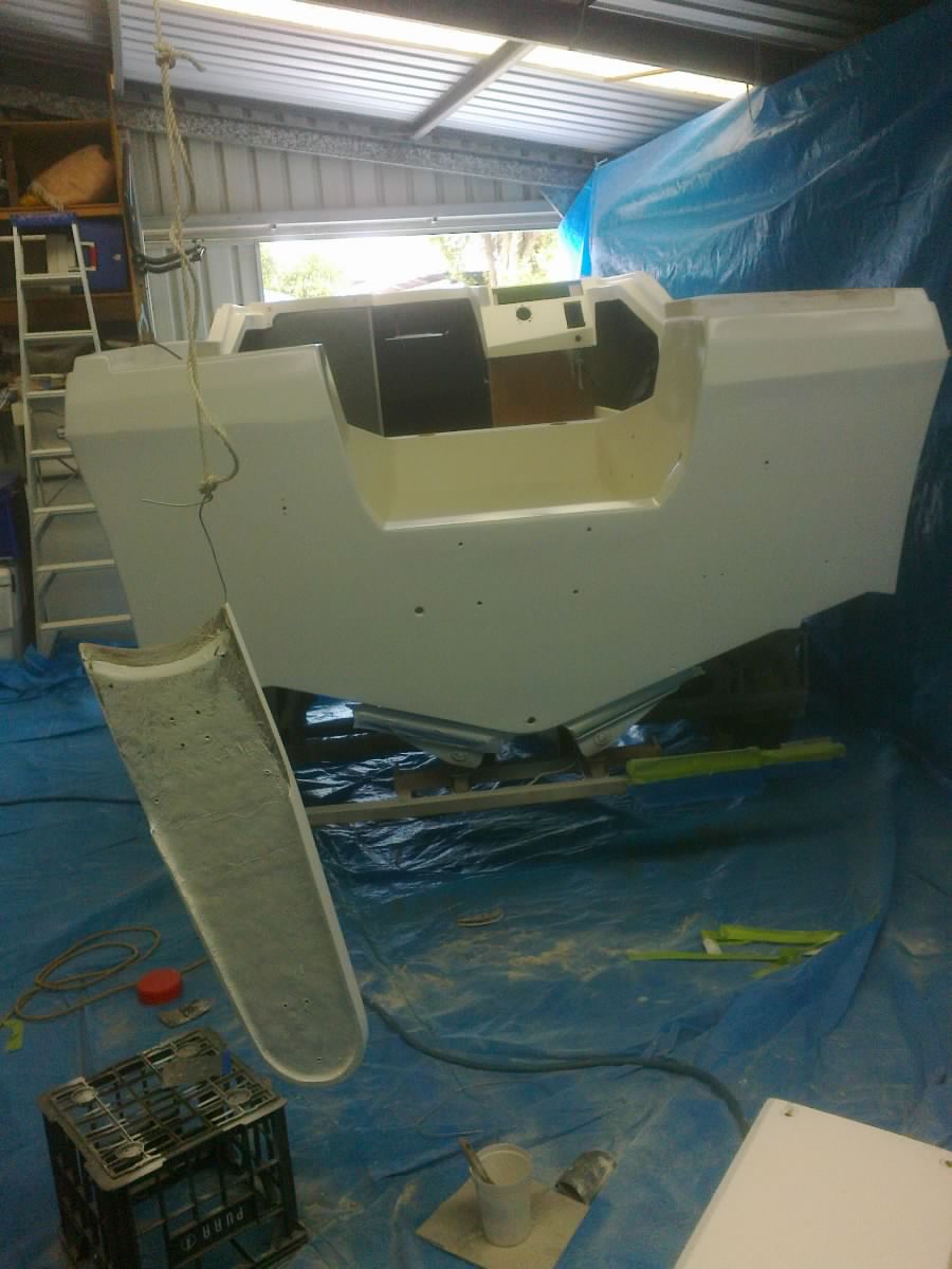

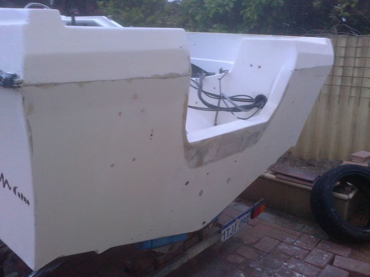

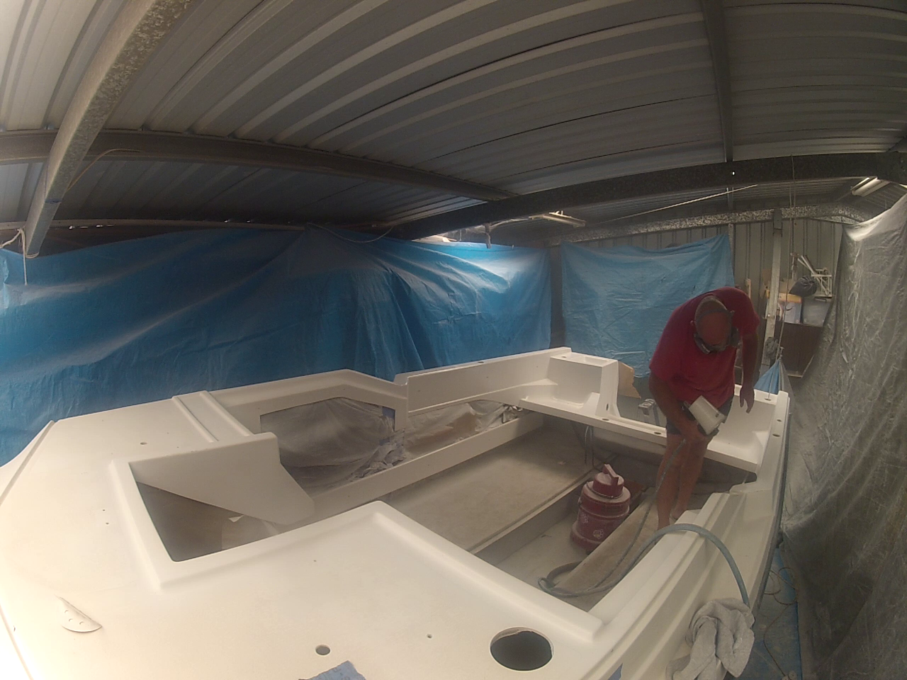

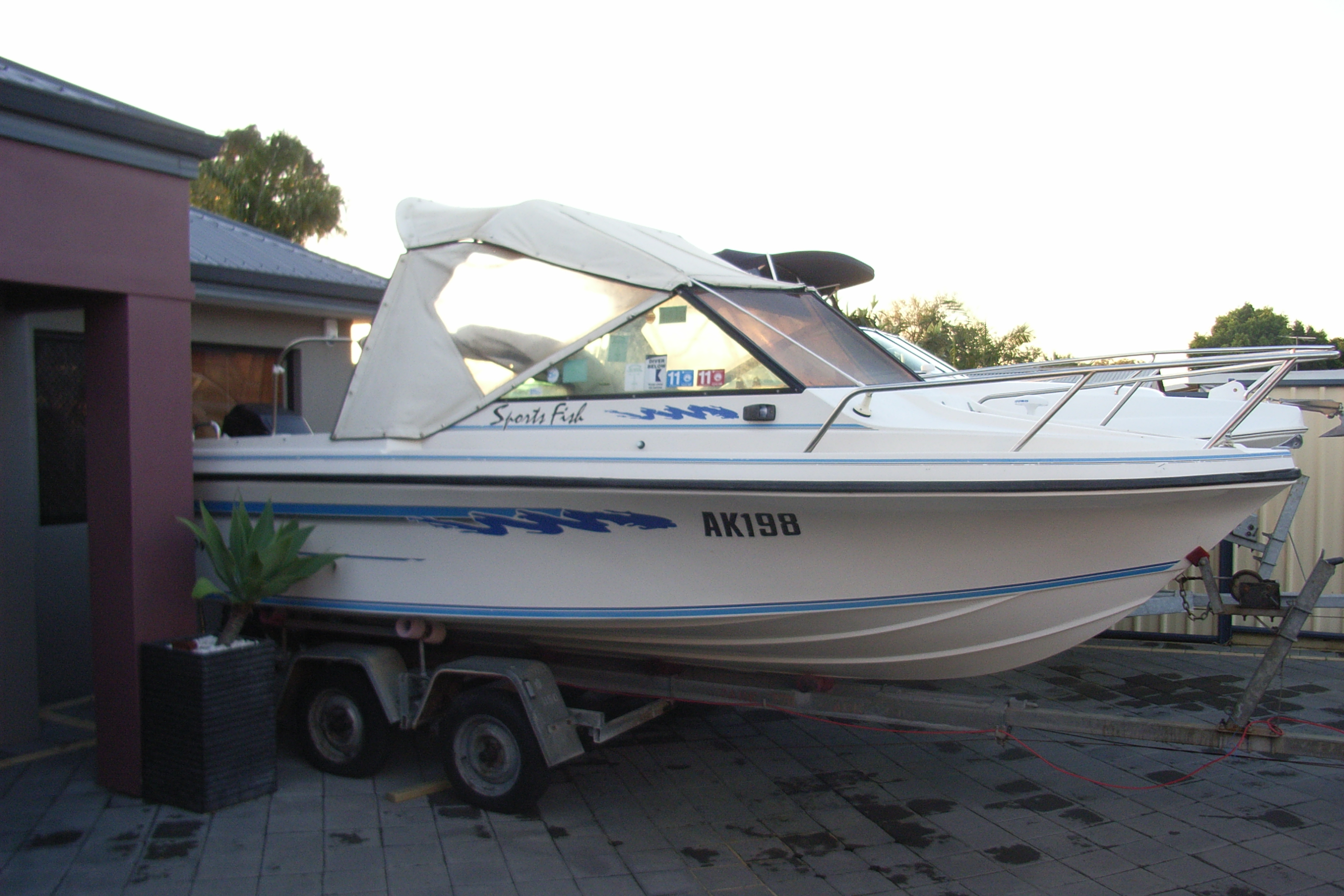

Been working on my Baron Sports since Oct 15 2013. Had to strip it, prep, sand, spray gel coat, sand some more, polish and refit. I finished about a month ago and still the wind hasn't stopped! Bottom pic is when I bought it 6 years ago

not the 1st time I've done glassing, but learning to spray out of the new gel coat gun was a challenge, worked it out in 20 mins tho, not like using a HVLP gun. Spraying is the easy part, sanding is what takes the time.
Yes I see plenty of projects(crap)on Gumtree, but by the time you put your time into them it's not worth it. When I see something worth doing I'll grab it hopefully

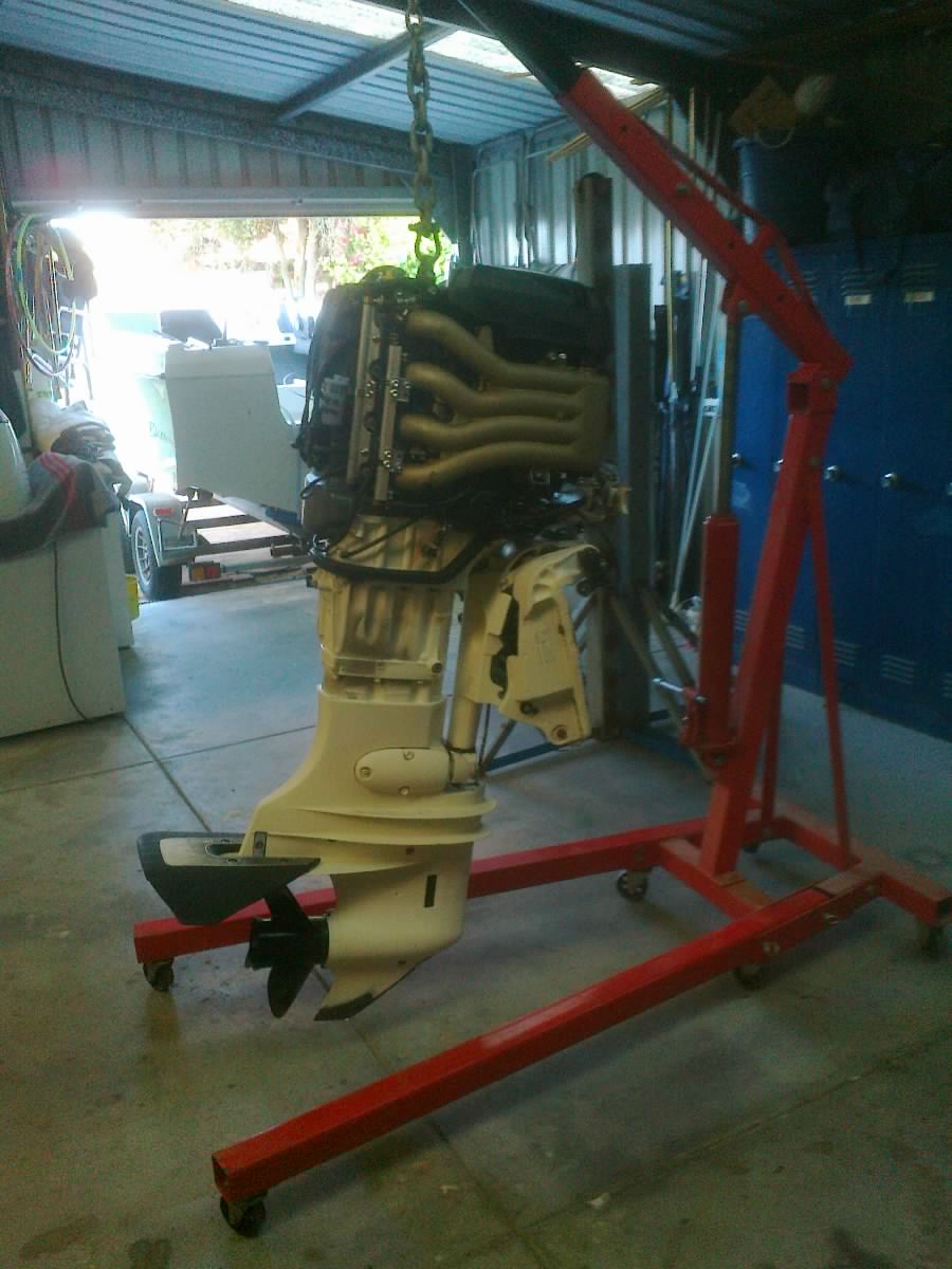

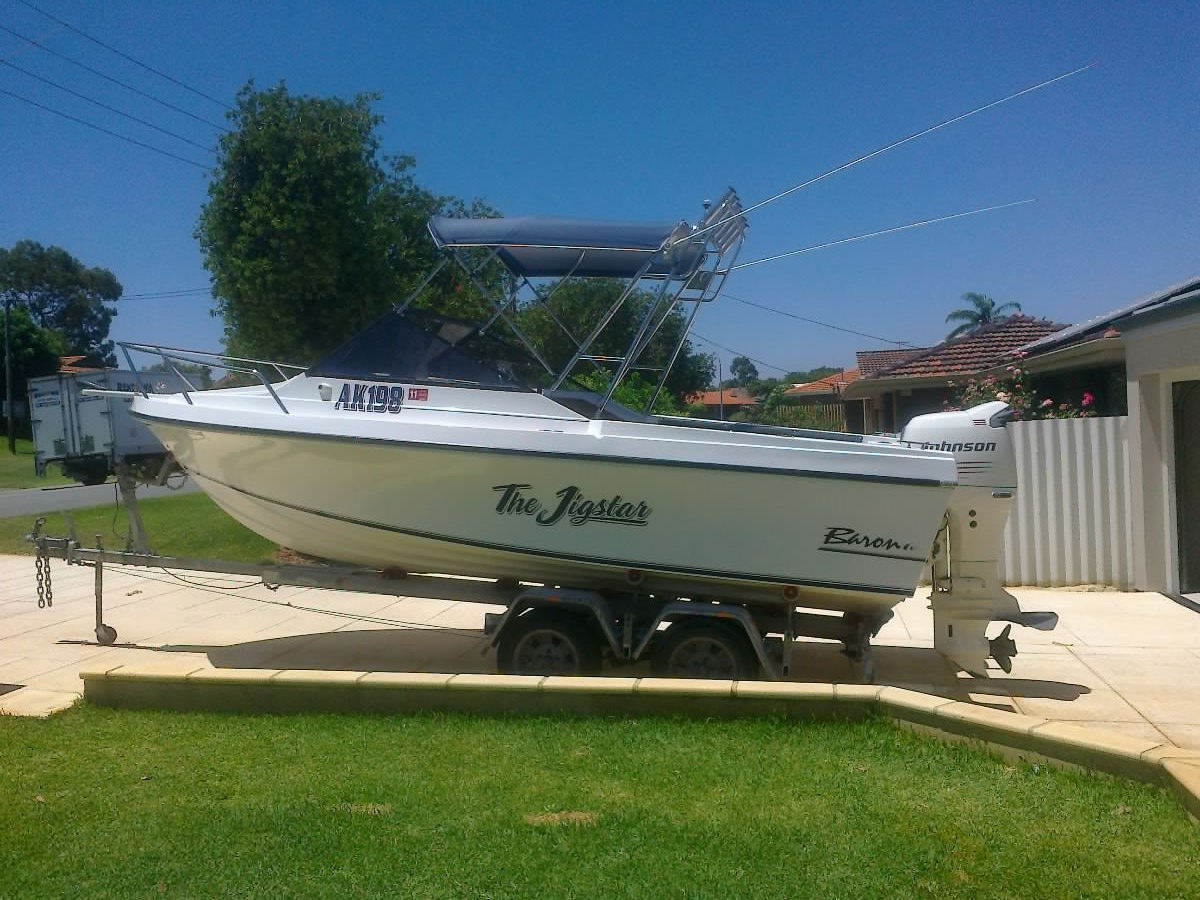

What motor and prop are you running?
Thanks
Bob
wangler's picture
Posts: 607
Date Joined: 26/04/08
Motor is a Johnson 140hp
Sun, 2014-02-09 20:00
4 stroke and prop is 19 and bottom cav plate pretty much inline with bottom of hull. I get WOT 5800, 65kmh/ 35knots with full boat ( 3 ppl,their fishing gear and about 100kg of fish, ;) )
