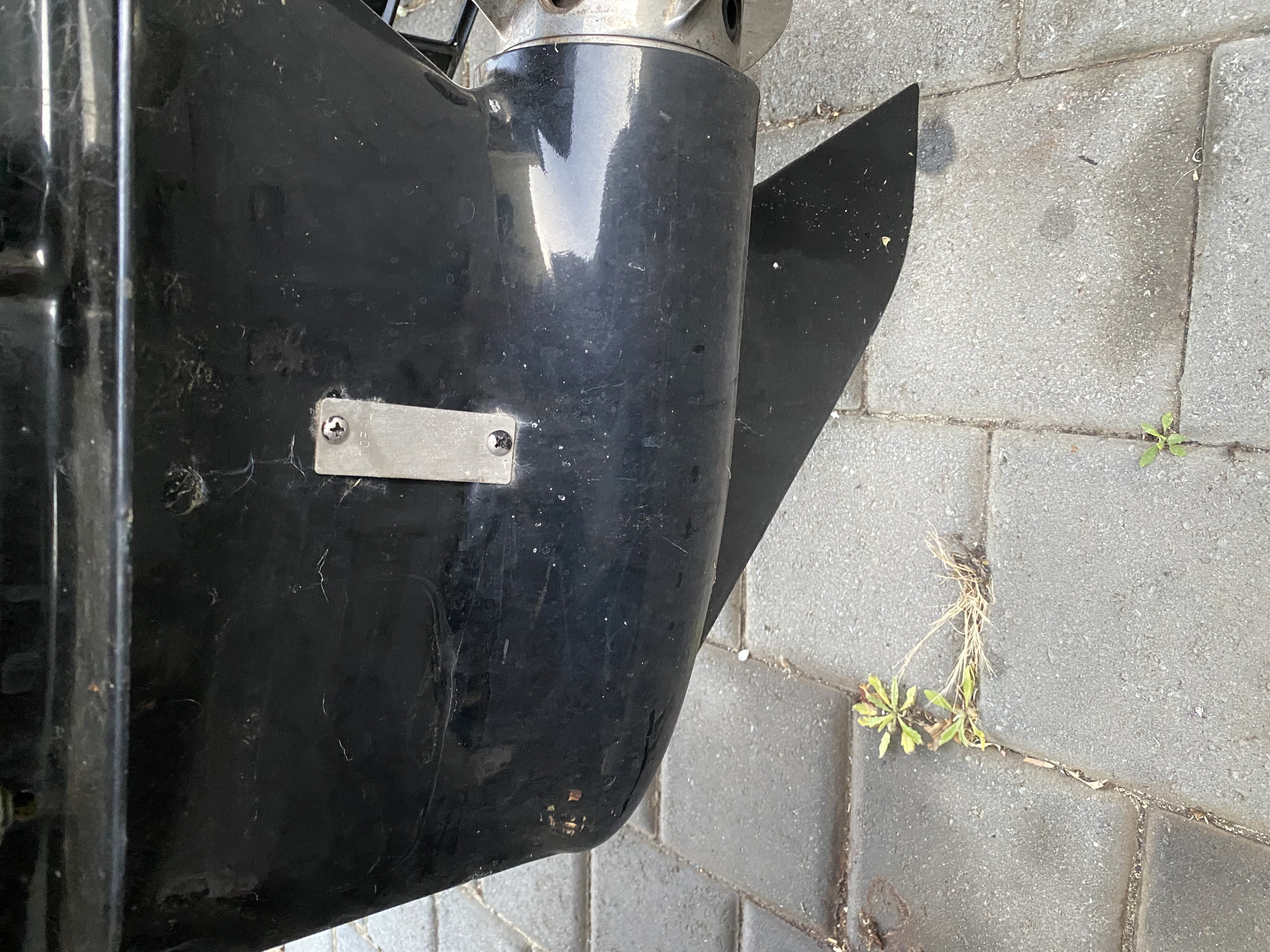

Anyone seen this done before
 Anyone seen this before? I figure it's to force water through the motor?

 Nope, should have a plastic screen that broke, so they put that on.

 its on both sides and teh
Fri, 2020-10-30 19:33
 its on both sides and teh screws are pretty tight. need a bit of force to remove them.

I'm pretty sure that should
Sat, 2020-10-31 07:48
I'm pretty sure that should be the intake for the water pump... if that's the case you definitely don't want it blanked off!!

I would say
Sat, 2020-10-31 17:24
the water pump is pretty stuffed and that forces the water in at speed.

plate is engraved...
Sat, 2020-10-31 17:32
 If you enlarge the pic, the plate has 'TOP' stamped on it. The plate seems to be flush with the motor and not 'proud' to catch water.

 If you can get a picture of
Mon, 2020-11-02 11:43
 If you can get a picture of the front, might be a custom cutout on the front for Running in skinny water. Yanks do it on the flats skiffs. That plate would stop the water running straight out the side.

 It's a high speed water
Mon, 2020-11-02 12:43
 It's a high speed water pickup and they were fitted as a merc option on some engines. See them mostly on performance hulls that run fast with jacking plates.
Don't really need them on your Reefy. Maybe that engine was on a bass style boat before.

 cheers Dodgy i thought it
Tue, 2020-11-03 10:59
 cheers Dodgy i thought it was for forcing water through the motor. not my boat but my mates. its on a 225 mecury 2 bannga on a 6.0mtr swifty. the thing would absolutely piss

 I recently sold a Swifty
Wed, 2020-12-02 09:05
 I recently sold a Swifty with a 225HP Mercury fitted with those. It came off a dealers Speedboat, Dodgy is on the money.
