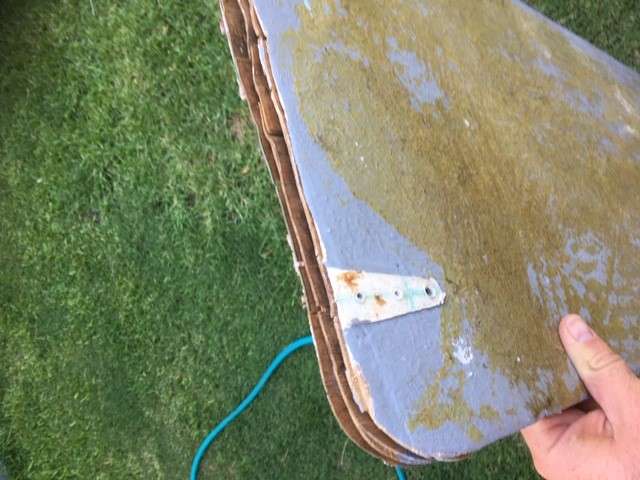

Swompa's picture
Posts: 4038
Date Joined: 14/10/12
 photo added...
Mon, 2020-01-06 11:07
 photo added...
Posts: 2145
Date Joined: 16/05/09
 Definately not marine
Mon, 2020-01-06 14:17
 Definately not marine ply....not enough layers and the ones that are there are too thick for marine ply.
Swompa's picture
Posts: 4038
 It's 12mm on an angle. Some
Mon, 2020-01-06 19:11
 It's 12mm on an angle. Some of the layers have fallen out...
