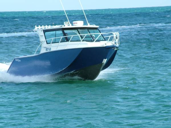

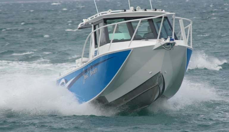

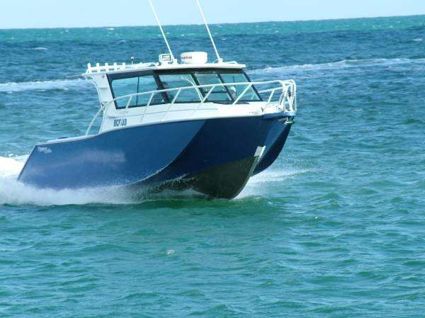

hey mate, my mate has 7.8 air rider an it is a really nice boat. look up on utube air rider. joint venture that light blue one tell me what other ally boat can 30kn in the rough like that ......
Posts: 4588
Date Joined: 01/02/10
 That’s the one in the bottom
Mon, 2017-10-16 20:49
 That’s the one in the bottom picture. Impressive rig. The builder did that one as his own personal rig.
