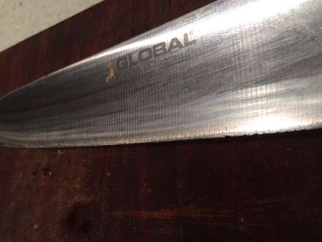

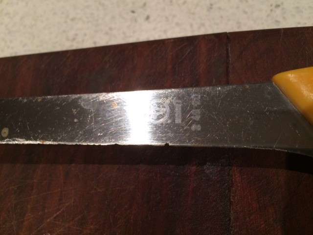

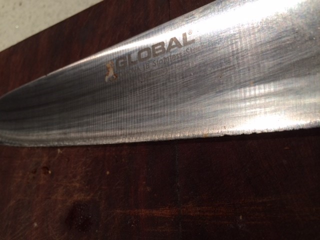

I have a few knives that are about as sharp as a plastic ruler - edges are damaged and yes they frequent the dishwasher everytime they need a wash
I have a mix of Swibo and Global with stuffed edges
What is the best way to repair them DYI? assume it would be with wet stones but I do have a bench grinder :-)

 No expert but with that notch on the swibo , I’d be tempted to grind it initially you’d be there awhile trying rub that out on a stone .. we always had a grinder at the abattoir to address notches or broken knife tips or wanting a particular edge .. I remember some boners used to custom shape the blade on a grinder as soon as they brought them . The Global you could most probably rub that out .

Use a good quality sharpening stone and make sure you work on each side equally. Start on the coarse side giving a minute or so on each side of the blade to keep it even.
When you get all the nicks out and cannot see any of the old edge remaining then turn the stone over and start to polish the edge. Some like to increase the angle so that you get a chisel type edge so you don't roll the edge over if it gets too thin.

If you use a belt sander, go really really slow, don't use too much pressure, and keep some water nearby. It's easy to overheat the edge, where the steel is thin, and that will soften it, which is not good at all. Whatever you do, do not use the bench grinder. The big chip will take time, you may even want to work it out over several sessions if you can get the rest of the blade in usable shape.

Don't forget that Jap knives like Global are sharpened at around 10-15 degrees compared to your Swibo which is sharpened at 22.5 degrees.

The chips on these knives need to be dressed out, new shoulder on a stone then hit with the steel.
