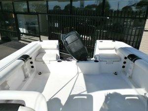

Time to upgrade from my Baron sportsman, I cant justify pumping another $15K into it to upgrade the inboard as I just don't trust it anymore to head out far. I am considering a 23' Pro Line but am concerned about the transom in a following sea, seems to me it could be a concern considering the large gap. I was hoping any Pro Line owners or those familiar with transoms like this could give me some advice.

Main things you want to
Main things you want to consider is
Broaching per say would not be the problem but taking a wave over the stern
1. Height of the gap at the front (as in spilling water into the cockpit) above the water line and the ability of the engine well to catch any water before it spills into the cockpit including through holes made for steering cables etc. and their height (ideally any steering cable holes should be as high or higher then the front part of the engine well).
2. Height of the suppers above the water line (ABYC standard states the length of the boat in metres x 1.83 gives you the height the deck (or scuppers) should be above the water line (with the boat at its normal waterline position) - i.e a 7.31m boat (7.31 x 1.83 =13.37) should have scuppers sitting at least 13.3cm above the waterline.
The above design would certainly rule out heavy reversing into a sea.
Apart from that its not what I'd call a great transom design for fishing (the back corners).

Thanks for that Paul H. I
Thanks for that Paul H. I agree and will continue searching. I've been really happt with the old baron and will look for something with a similar transom. Some Trophy's look good, except those with that euro transom or whatever they call it.

hey mate... i had a pro
hey mate...
i had a pro line...went all the way to the trnech, and did numerious northern island missions. never had a issue with broaching or waves comming over the stern and i had been insome narly stuff!!!
