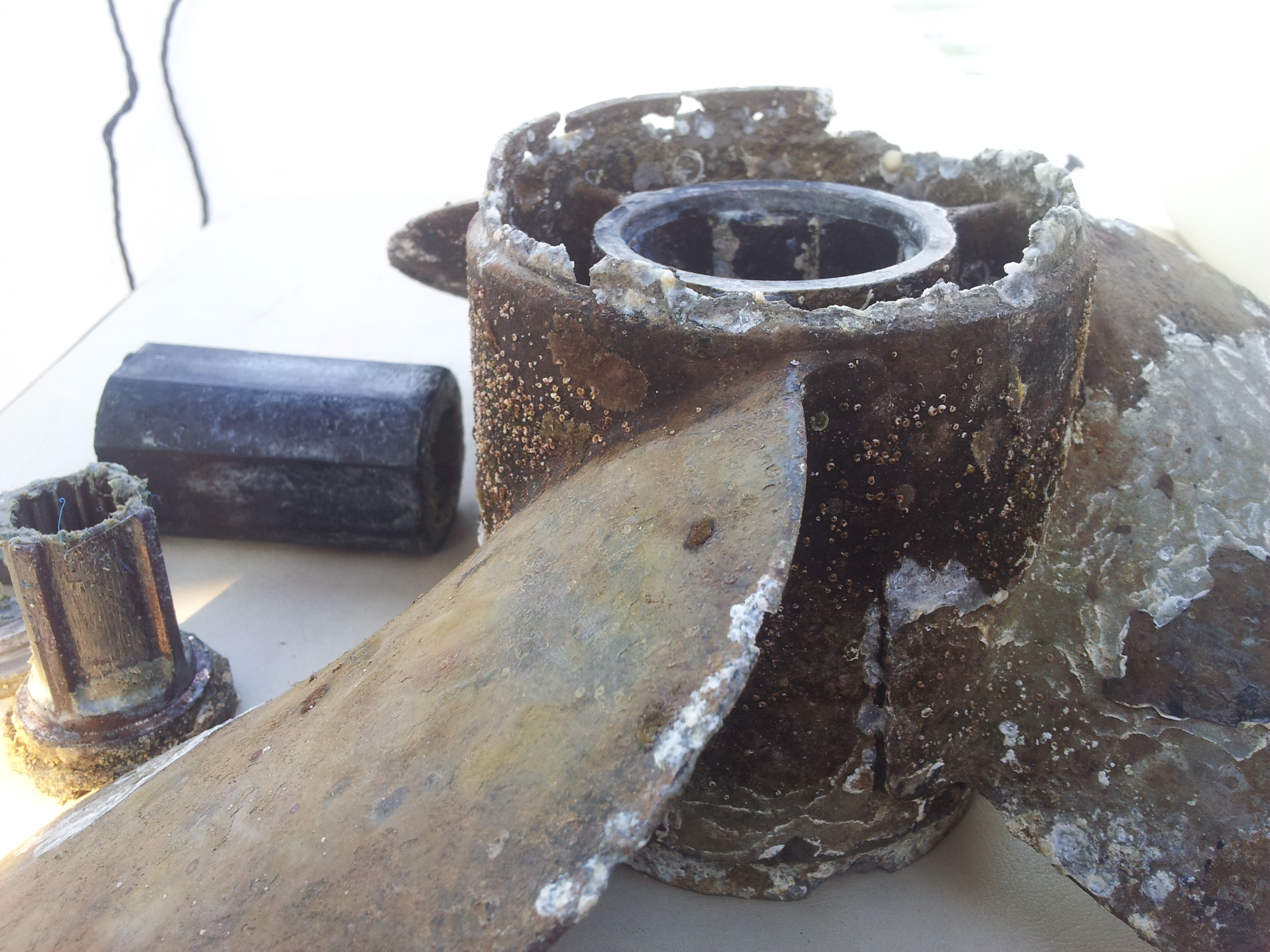

So I broke out the tools and started on some maintenance items. I replaced the engine hatch gas strut that broke a few weeks ago with one I bought in Repco. Found them on special on Saturday for $30. It fitted fine and was much stronger than the old one so it was a bit of a win. Next job was to remove the offending prop for an inspection to see what was required. I raised the leg and when I laid on the swim platform I was easily able to reach the prop. The trouble was my shifting spanner was too small. Off to supercheap auto up the road for another. Managed to find a 1 and 1/16th spanner as well so back to the boat. The prop nut fought me all the way due to drowth on the threads but eventually it was released from its resting place and onto the boat. The hub actually didn't seem too bad but the prop was in terrible condition so not sure if exhaust leaking out near the leg is causing cavatation instead or if the culprit will be the engine coupler.

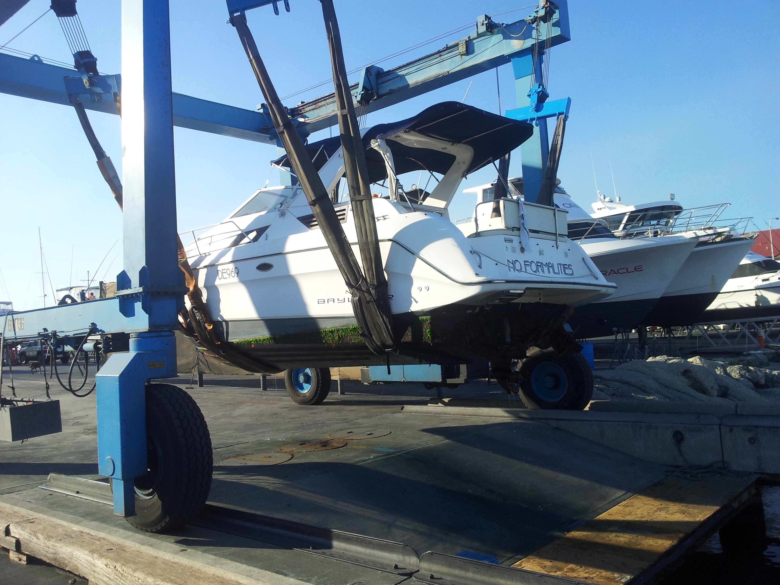

The plan was to leave the prop off and then scour around for a used replacement to get me by until I could finalise plans for rebuilding the transom assemblies and a noisy leg. Things went a bit downhill when after feeling victorious and taking some pictures of the prop and then I heard the bilge pump come on. Ok, maybe a bit from the normal leak but then it went again. Opened the engine hatch and I can hear water running. Uh oh.
A quick call to the guys at Hillarys lifting service and I was motoring my way down the coast from Mindarie to get the boat lifted. It was a beautiful afternoon with light winds and a slow old drive down at 7 knots. 90 minutes later the boat was in the soothing grip of the slings at Hillarys. I figured it best to be safe than sunk in the pen.
So she needs some love, might have a lead on some second hand drives and transoms, need to fix the oil leak, clean the bilge, tidy up some wiring, new antifoul, a new toilet and I can finally install my sounder. Might even be able to get the bent section of bow rail replaced!

Looks more like electrolosys
Mon, 2014-07-14 09:38
 On your prop may need a few new anodes to fix that before it stuffs anything else

Yep, the boat wasn't loved in recent years by the previous owner so the anodes are all gone and the bellows were so brittle they broke when I lifted the leg!

you are very lucky you caught
Mon, 2014-07-14 09:53
you are very lucky you caught that before it went to the bottom
As Neil said, you will need to look very closely at the condition of the leg as there is a good chance it also has some savage wastage on it.

From the amount of weed growth ,it looks like it hasn't been out for quite some time.
Good clean up and new bellows, check the uni joints, replace anodes, renew water pump impellor and some antifoul and she will be good for another 12 months

 Believe it or not but I had the divers scrape the hull 2 months ago. The weed seems to grow on everything at Mindarie pretty quick. Hopefully the antifoul will stop it.

Here in Carnarvon, we had to pull the boat out every 6 weeks to clean its bum of barnacles, weed and oysters due to the warmer waters in an effort to keep it up to speed.
Since getting an airberth maintenance is zero and any growth of the airberths can be cleaned off with a good whack with a hammer causing most of it to simply drop off. Expensive at first but well worth it in the long run, 3 minutes to launch and about 4-5 to lift up

 I could be completely wrong but it looks like that prop has a crack in it... Starting at the second blade in the bottom right hand side of the pic... Could just be designed like that though

 If the props are original that makes them 23 years old so they have given their service. The plan is to replace them with new 4 blade props.

Well done on the fix, but bloody hell that prop was truely plucked. I wonder how it wasnt noticed?
