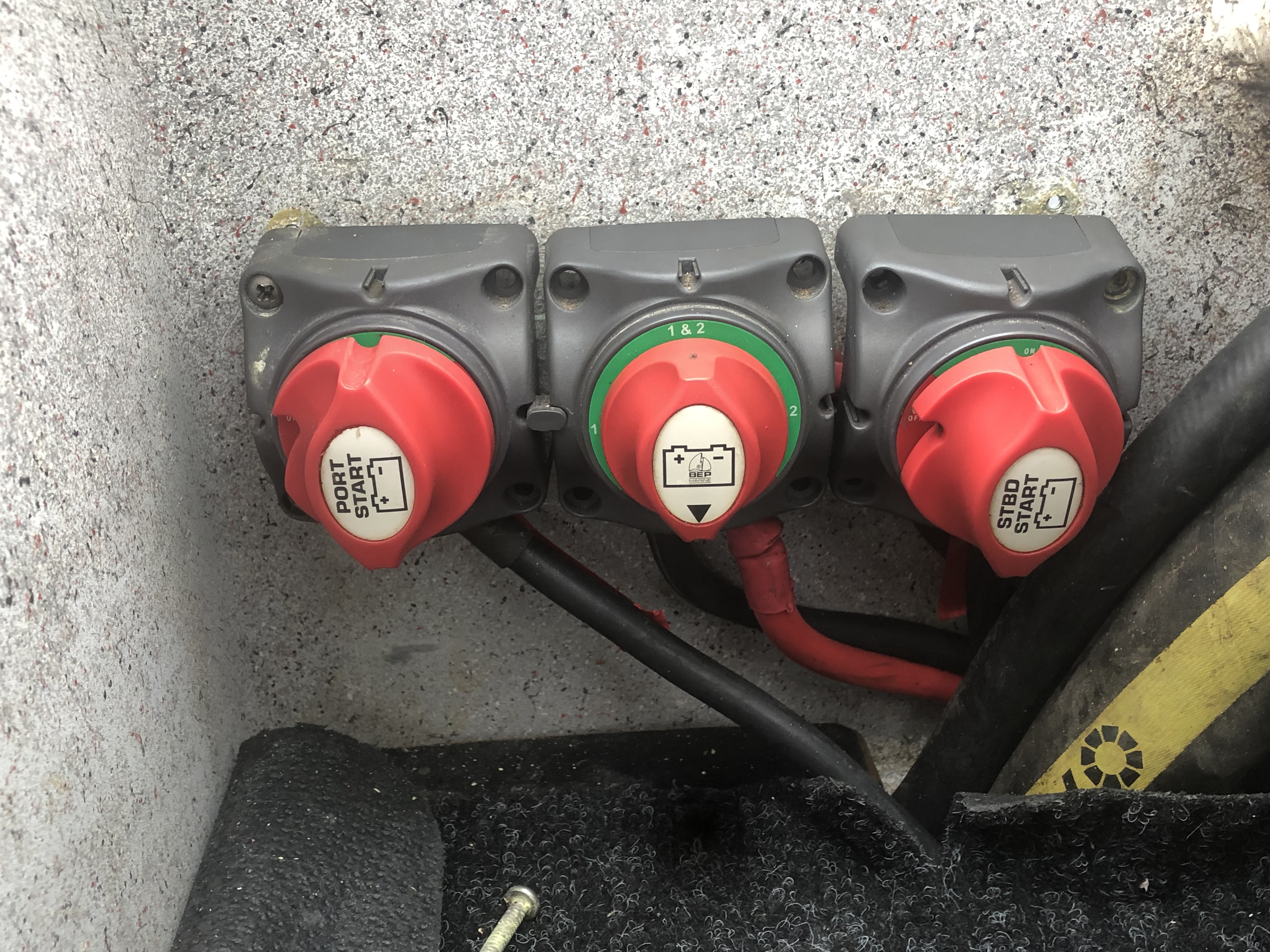

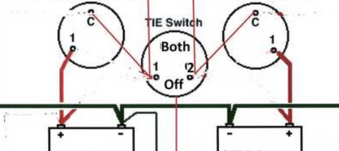

Update- I have wired as per suggested in diagram  andhave  attached pics
i haven’t started the boat yet just  turned the  gnition on to get power
I can only get power to port from port  battery and starboard from starboard battery  and only get power to both motors if isolator is on 1&2 and both batteries are still on
Just to confirm wired like this I should be able to start from either  or both batteries ?

The reccomended wiring from one of the battery isolation switch manufactures is, I belive, dangerous. (I wont mention the manufacturer).
A simple test to determine your wiring safety/security is...
1  turn all isolaters OFF
2  Test your electronics etc to see if any work.  If they do, their wiring needs checking- All isolaters off should mean no instruments/electronics will work.  A possible exception is an automatic bilge pump which may be wired directly to a battery.
3 Turn the middle switch to '1' and test.  No electronics etc should work.
4  Turn the middle switch to '2' and test.  No electronics etc should work.
If the electronics do work at '1' and/or '2', then that/those batteries CANNOT be fully isolated. This means that a battery may fail and cause the other to malfunction (ie it may fail too)
Wired correctly, a faulty battery can be totally disconnected from everything else, and your 2 motors can be started and run from the remaining good battery.
To fix the wiring is generally a simple matter of moving 2 wires/links that connect the middle switch to the outside switches ,   1 from each of the PORT and STARBOARD switches.
In the suspect wiring these links will be connected to the BATTERY side of the PORT/Starboard swich.   IN the 'safe' wiring they will be connected to the MOTOR side.
I did produce  2 wiring diagrams but could not copy them in to the post... and I'm not stuffing around trying to make them a URL...
If you want them... PM me an email address and I'll send them.

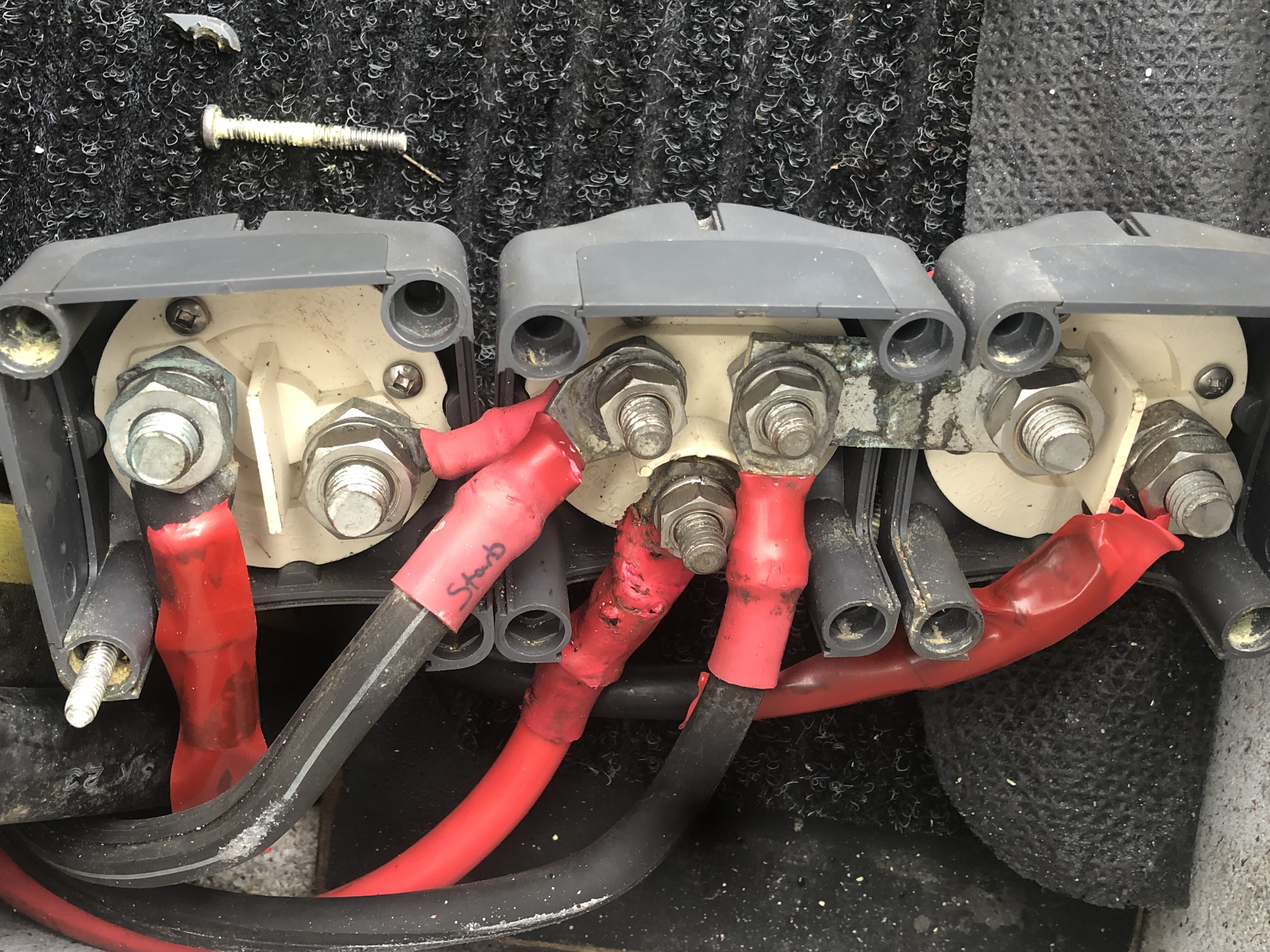

 Just inspecting the wiring
Mon, 2019-06-03 10:08
Just inspecting the wiring on the boat,  it seems the two batteries are hooked up together  as in parallel this would mean I can’t isolate the batteries unless I remove the connection  and run it to the other isolator ?
You can see in the pics the port isolator has 1 wire and the others have 2.
i assume this is correct.

ITs just where the wires are connected.
Mon, 2019-06-03 14:15
 I enlareged the photo and lightened it up.
There is:
1 cable to the port switch
2 cables to the starboard switch
2 cables to the centre switch.
There arelinks between the switches behind the covers, that you cannot see.
One of the PORT cables is connected to the middle switch, probably for convenience when installing it all (easier to get to.)
I'm betting if you go through the test I outlined you will find the batteries are only in parallel when the middle switch is on '1&2"
(when I said 'turn all isolaters off' I mean the 2 outer AND the middle one...  I cant see the marking on the middle one but the OFF position has the black arrowhead pointing down)
 If I am wrong, then your wiring IS in serious need of correction.

Yeah I did the test. The
Wed, 2019-06-05 19:35
Yeah I did the test. The  starboard battery works on 1,2 and 1&2
port has nothing.. I’ve got a feeling its been disconnected  from the port isolator and instead  hardwired to Starbord battery for what reason I don’t know

Hahah who ever will listen and can help us out... I  have added a pic it’s not the best I just screen shot and marked it up
basically I’m hooking both  positive  motor cables to the central post (on the 1-2 and both isolation switch ) not to one or 2 as indicated on robs set up  I tried it this way and  couldn’t get it to work
Posts: 5903
 Still a little unclear, do
Sun, 2019-06-23 20:38
 Still a little unclear, do the 2 reds you have drawn go to the 1/2/both/off switch?
As, where I have written "off" is not actually a terminal but a switch position meaning no terminal is connected to another.
If the positive of the 2 outboards are linked permanently then you definitely have not got it set up right.
It sort of looks like the positive of the outboards are linked together, where they should go to the terminals I have drawn on the centre switch.
I think you should get it looked at by a marine or auto sparky, there is a hell of a lot of energy in an N70 battery and while you wont get electrocuted a fire or flash burns is a distinct possibility especially if its not fused.
EDIT-reading your description, I think you have both outboard positives connected to the centre where the house comes from. You cannot isolate your house supply while any outboard is running and both outboards must charge the same battery/batteries.
You cant run with stb on stb battery, port on port battery unless the switch is on both and batteries are linked through it.

Posts: 5903
 The ONLY time you should
Sun, 2019-06-30 20:48
 The ONLY time you should EVER have it on "both" is to start an outboard if needed.
Never charge on both.
As you ave said "motor" Im assuming you are talking about a single outboard.
dmck's picture
Posts: 500
Date Joined: 07/03/19
ANswer to Jim
Mon, 2019-07-01 07:52
 With the preferred wiring, the flat battery can be totally isolated using the dedicated (to that battery/motor) switch.
The 'Both' switch then connects the other battery to the motor to start it.
Once started, the skipper has the option to reconnect the flat battery then switch the 'select battery' switch to either 1 or 2 to drive the 'house electronics'
