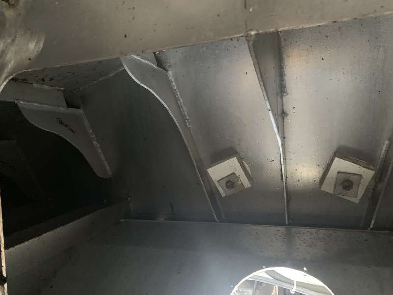

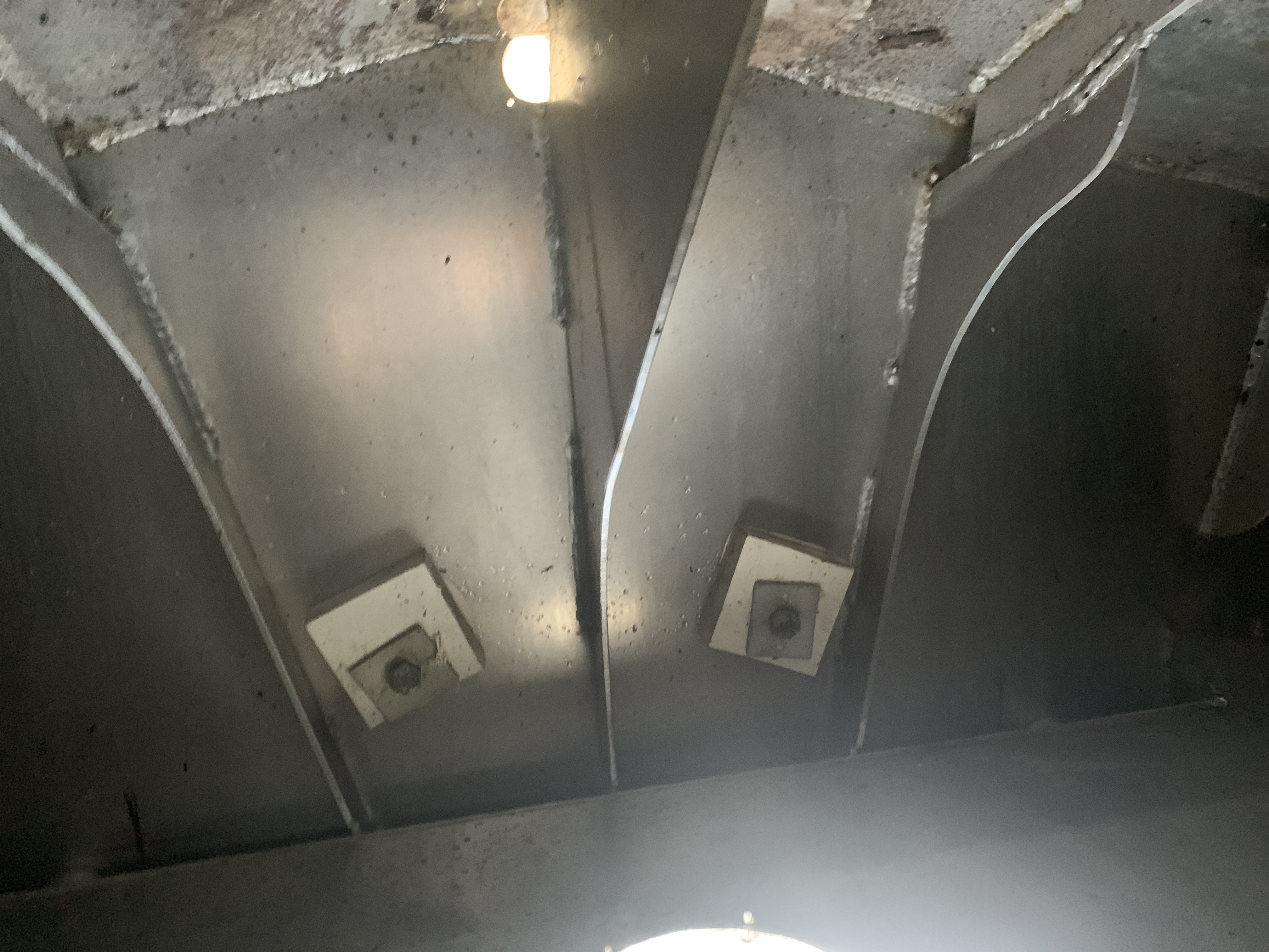

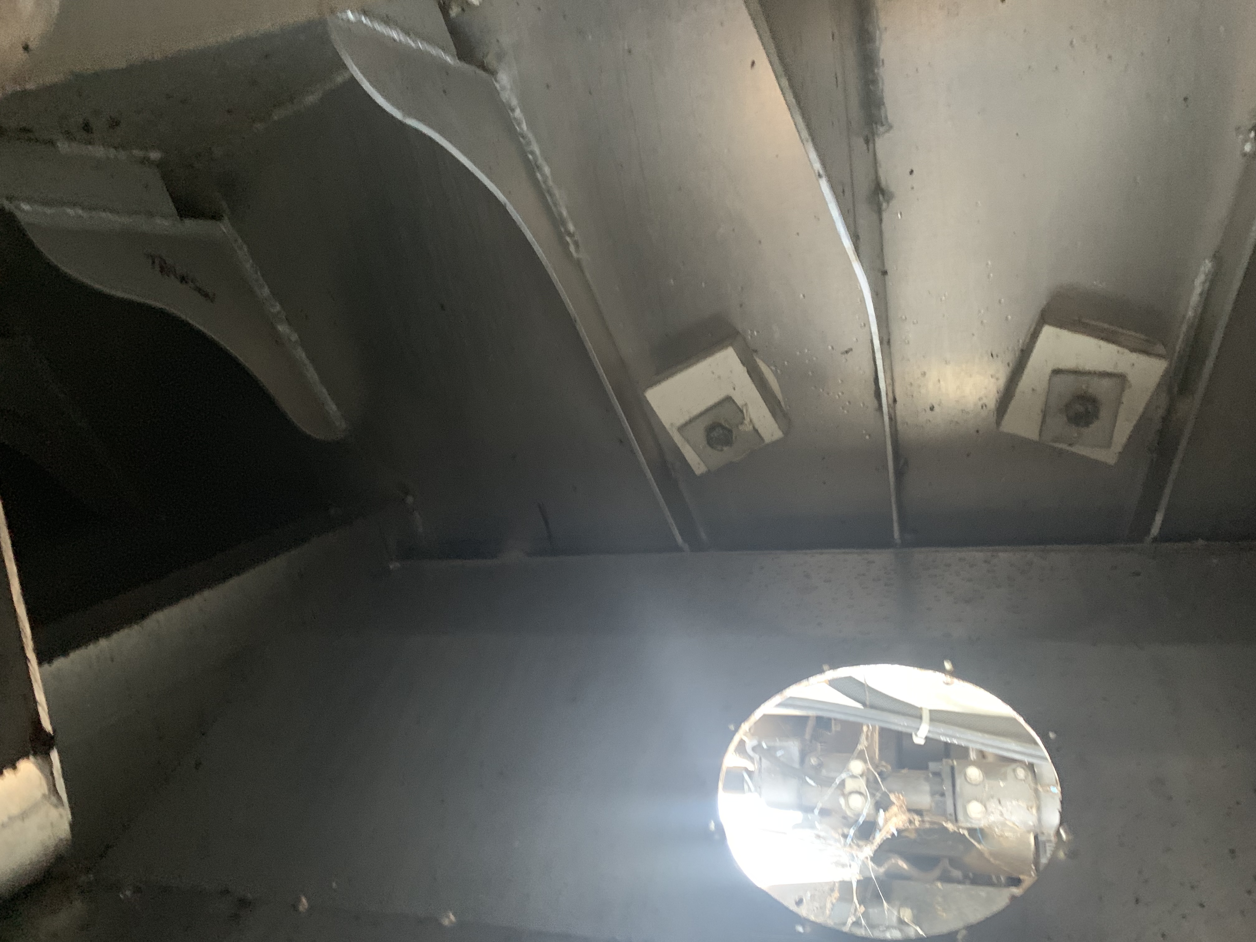

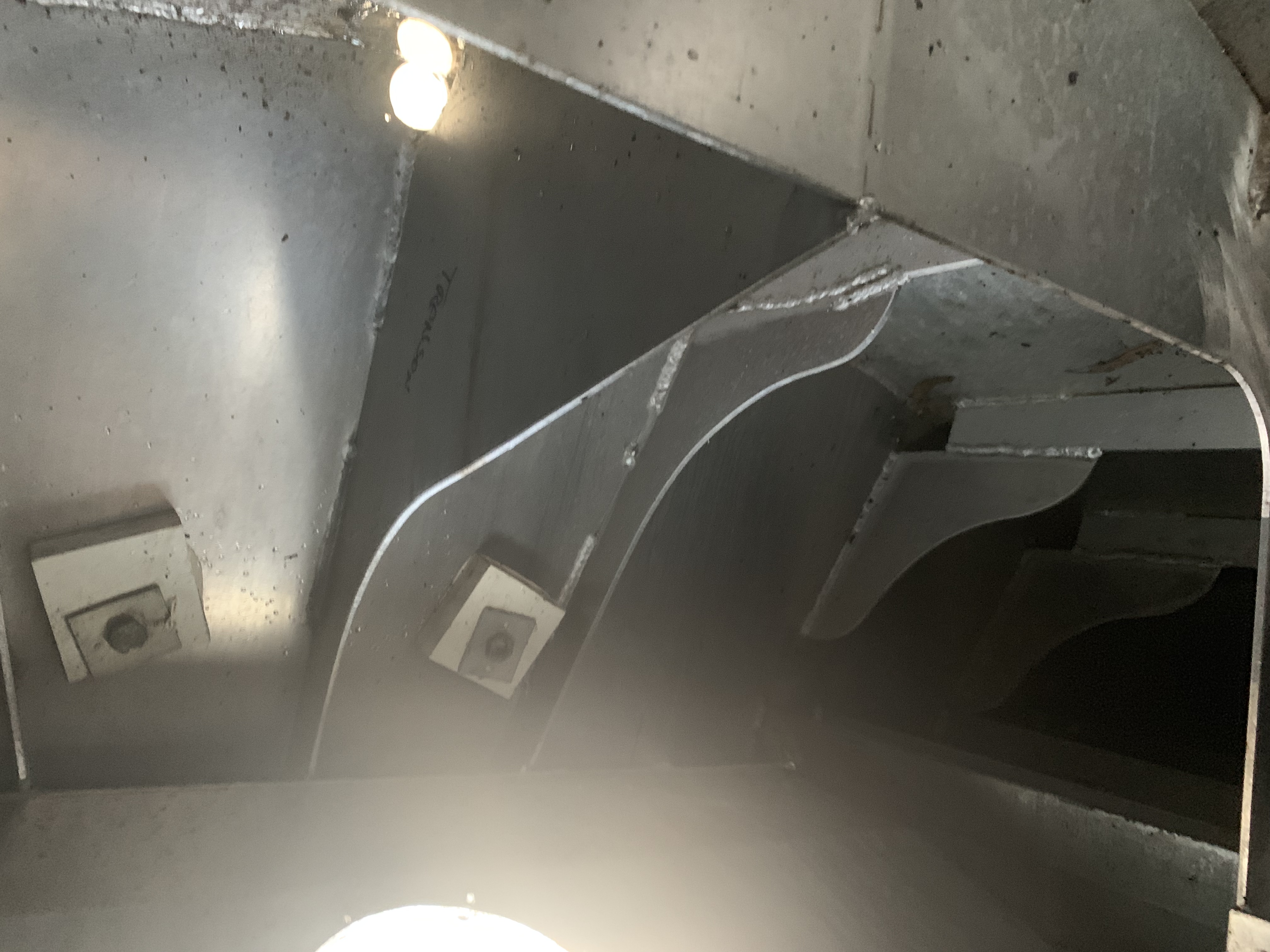

What’s the general transom thicknesses for boats between the 6-7m mark for plate boats.
also curious of transom support brackets and if I made need to add extra support for my plate boat.
My transom is about 5mm thick. Pics show support structures.
Should I add more support. On the back of it is a 175 Johnson (piece of shit) that weighs about 180kg. I want to piss it off and put a 175 or a 150 4strokd on the back but unsure if the extra 20-40kg will be ok for the transom
Posts: 4588
Date Joined: 01/02/10
It will be fine.
Fri, 2019-06-14 19:07
It will be fine.
Posts: 4588
And that’s about the cleanest
Fri, 2019-06-14 19:09
And that’s about the cleanest under deck pic I’ve ever seen. Looks like great access for through hull transducer options.

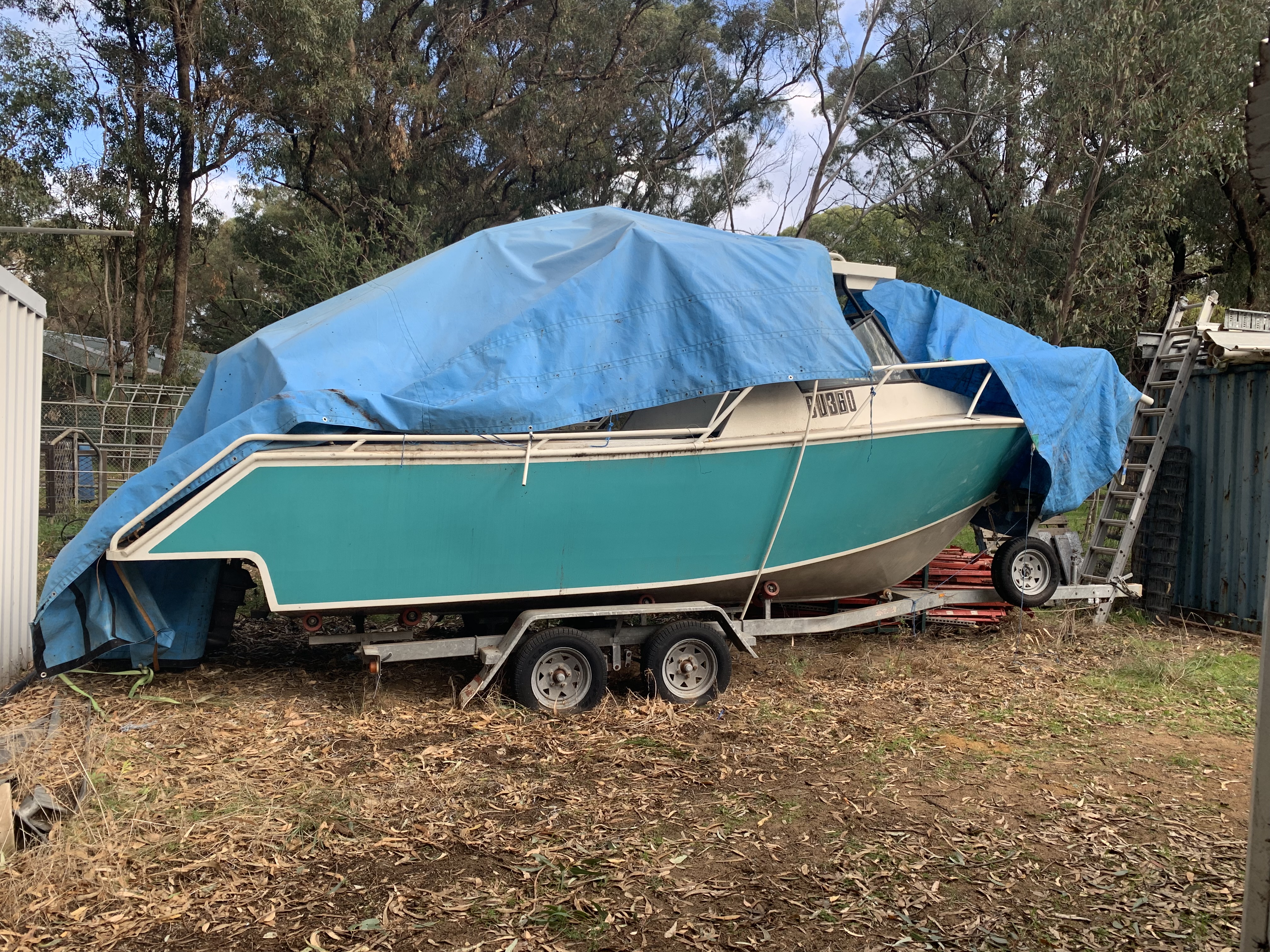

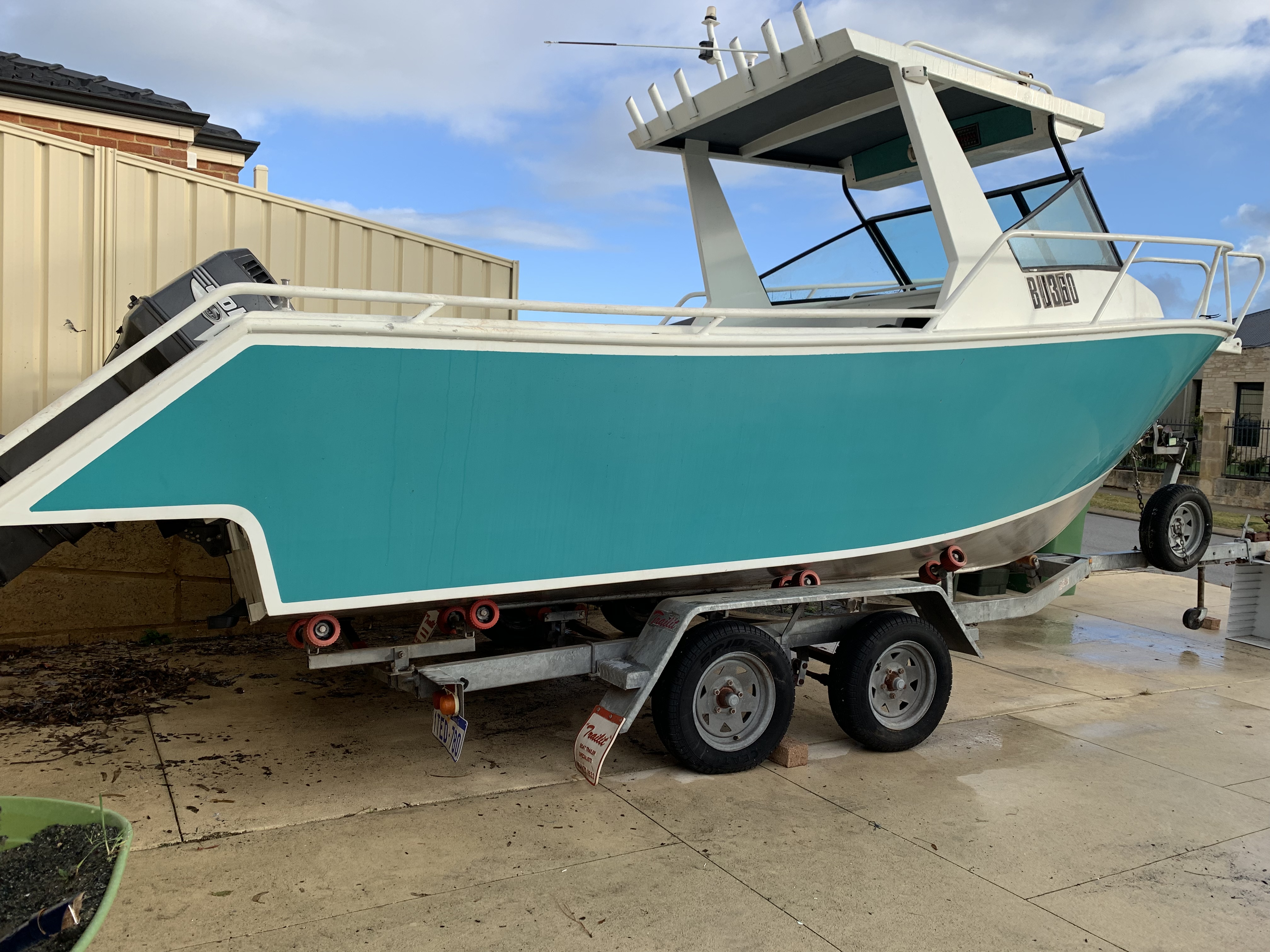

Yeah it’s my 2006 project
Fri, 2019-06-14 19:17
Yeah it’s my 2006 project boat I found in a back yard.
If I could attach pics I would.
Posts: 290
Date Joined: 22/05/19
Just update two more pics on
Fri, 2019-06-14 19:23
Just update two more pics on there. One to what I have her looking like now Nd the other is how I found it

And if you are repowering go for a 200 or even a lightweight 225.  Did that with my 6.8 seaquest and get a nm to a litre.  And having now seen the boat you want cracks welded on I definitely think you should go to Bullett....worth every cent getting it done well
Posts: 290
Yeah the cracks are only in
Sat, 2019-06-15 09:37
Yeah the cracks are only in the hard top not hull and they are only like 3cm hair line cracks . I’m just unsure about how well or how good the transom is supported uno to put an extra 40kgs on it.
