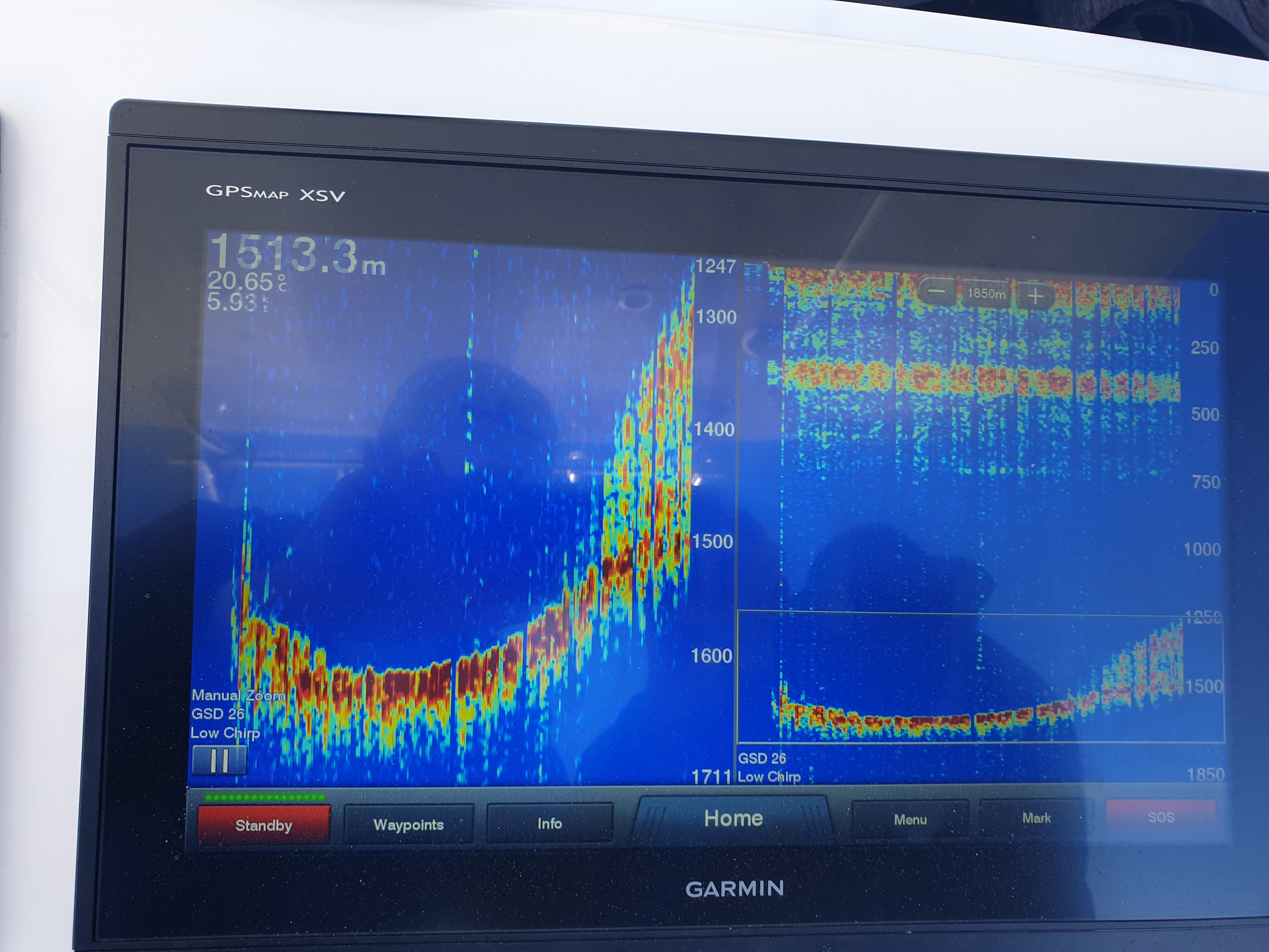

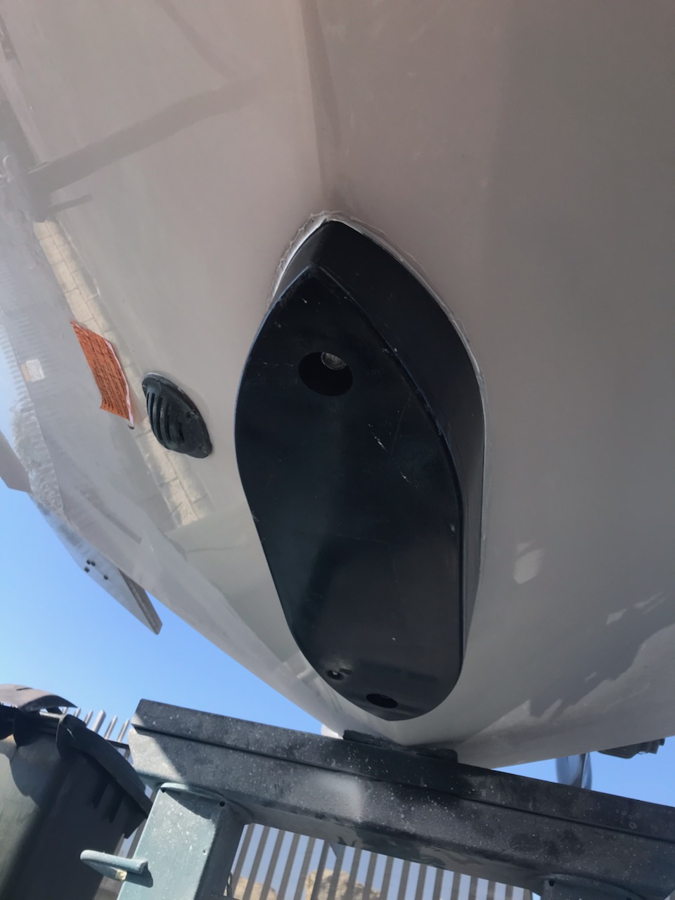

 Recently upgraded the sounder on the Regulator from 1 kW to 3 kW. Went with a wet faced, keel mounted R509 with Garmin GSD26 black box, hooked up to 2 x 16 inch monitors.

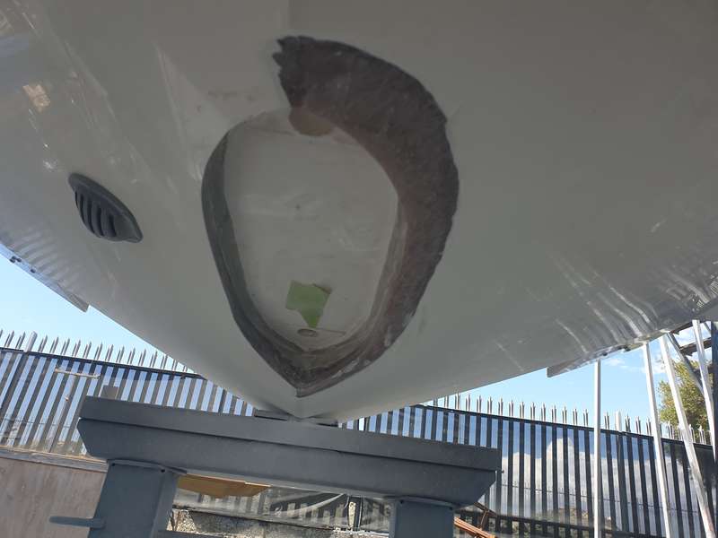

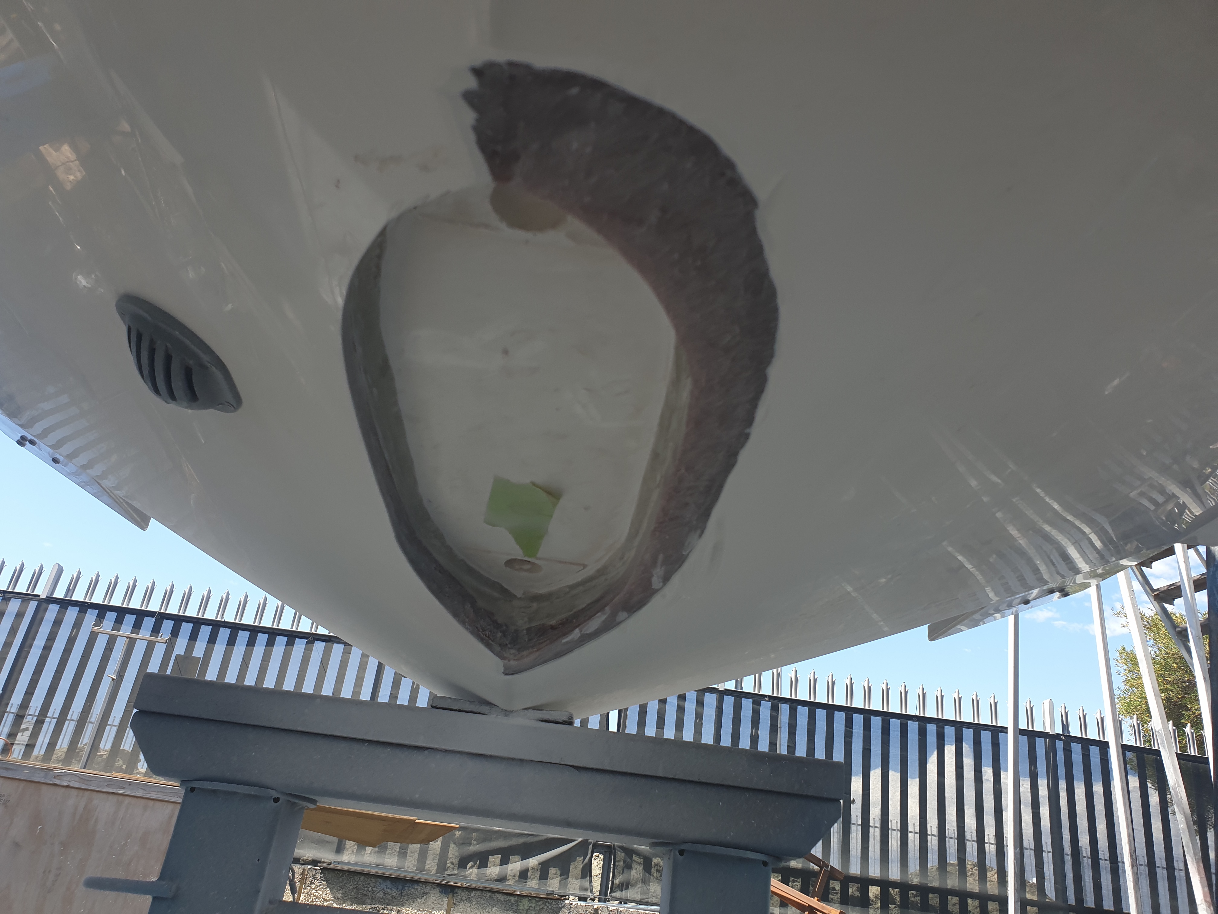

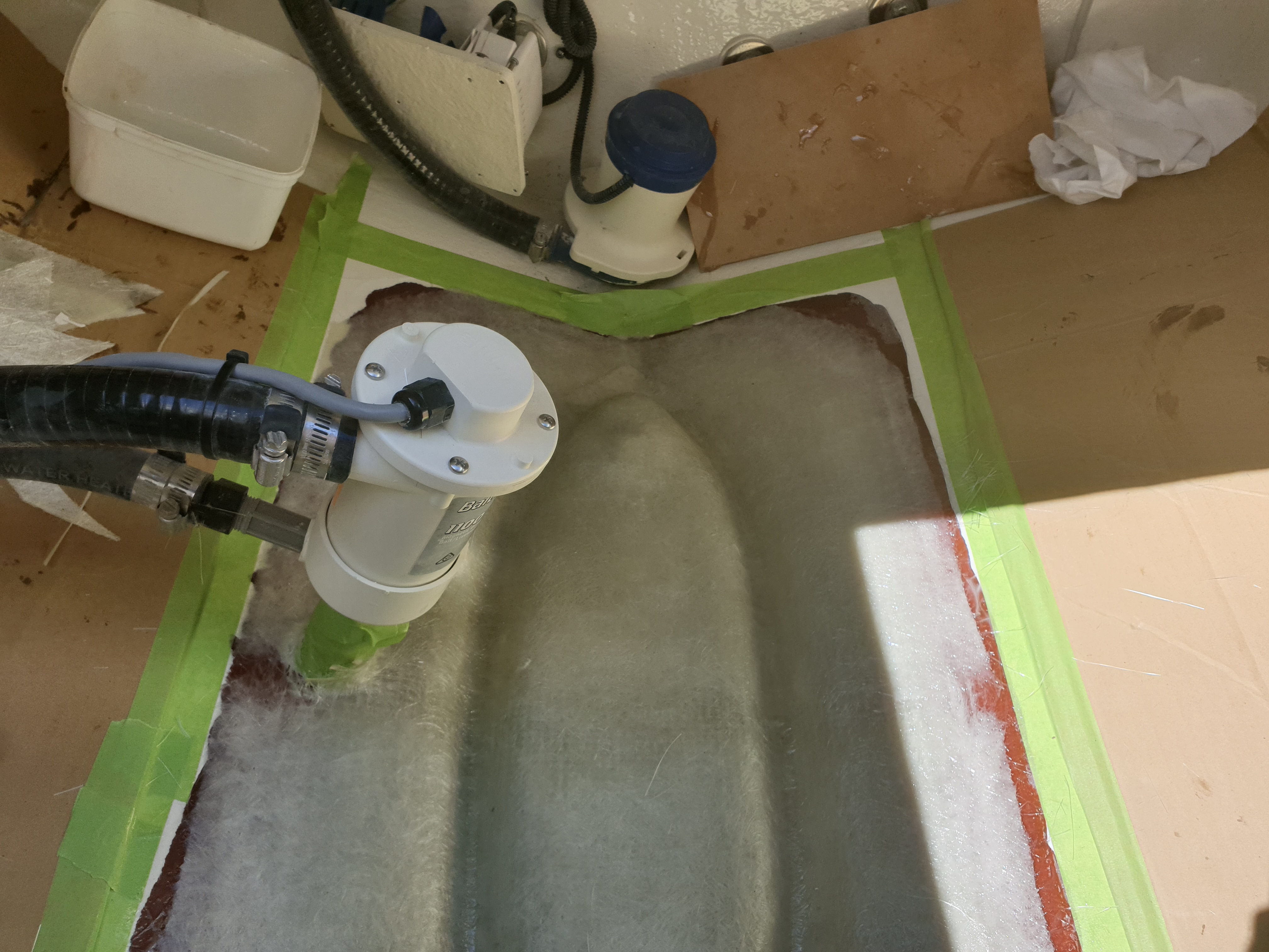

Had to cut a bloody massive hole in the keel of a new boat and semi recess the tranny to ensure it was sitting down a few inched into clean water...hard to do, but we wanted the best results so this is what it took based on my research. All Marine Services did the install, too big a job for me, they did a bloody nice job.

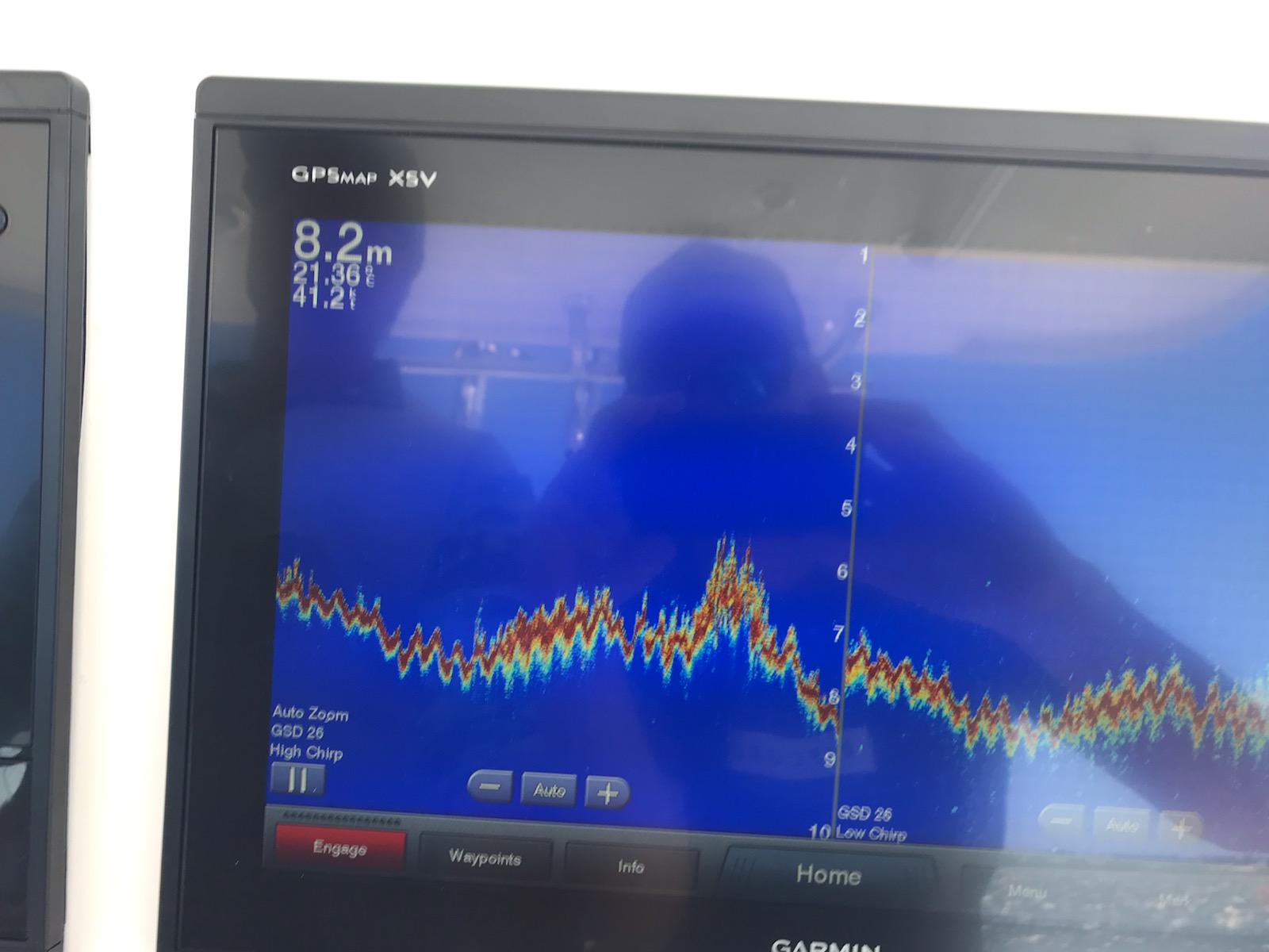

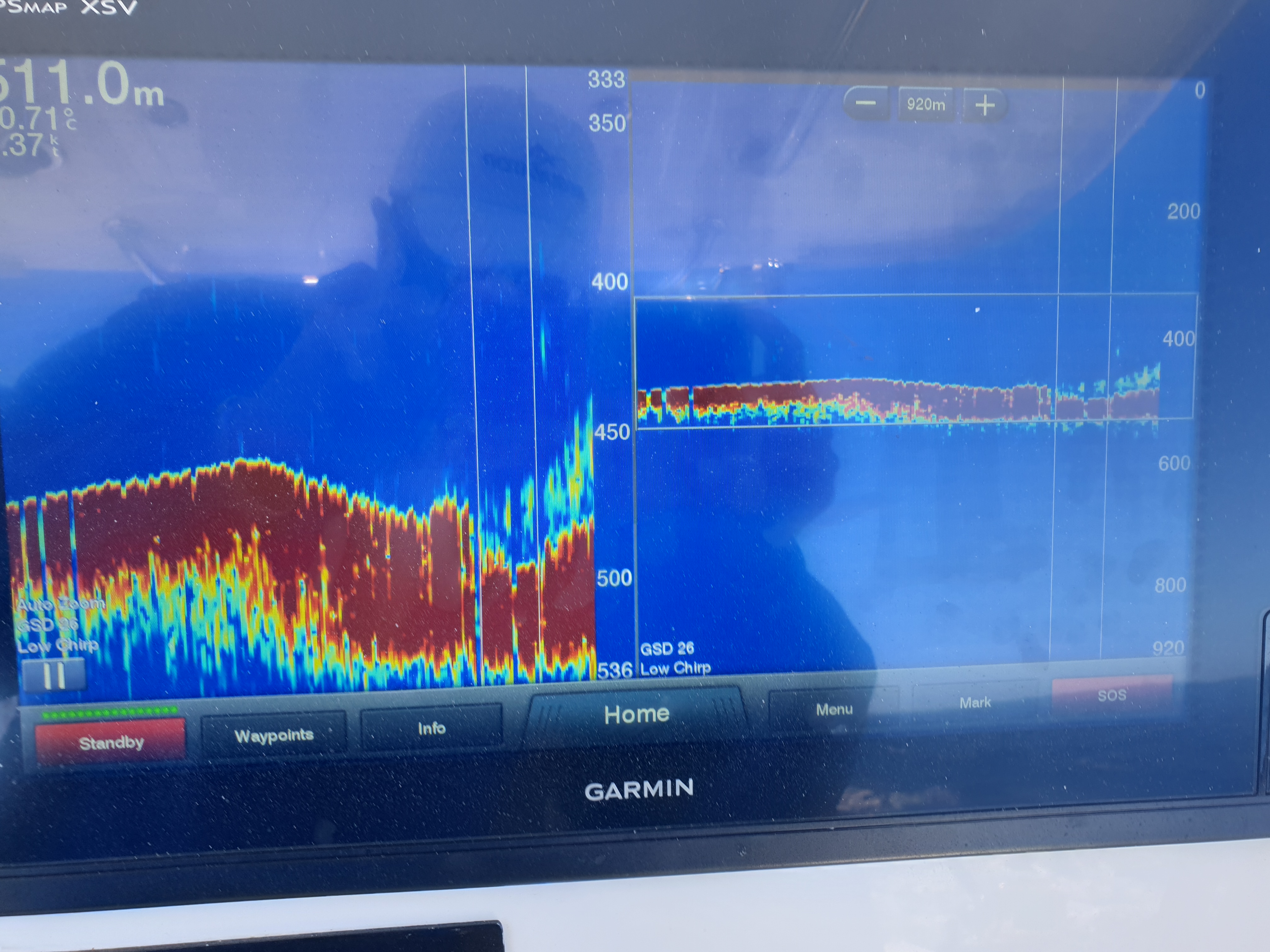

Finally got the chance to test it out on the weekend, and results exceeded expectation. In shitty conditions well off shore, we did not hit a speed or depth that did not result in a pretty good image, all on FULL AUTO with no adjustment of any settings.
41 knots in shallow.
500m deep. Nice fish, two vertical lines are waypoints, will go back and have a crack at these.

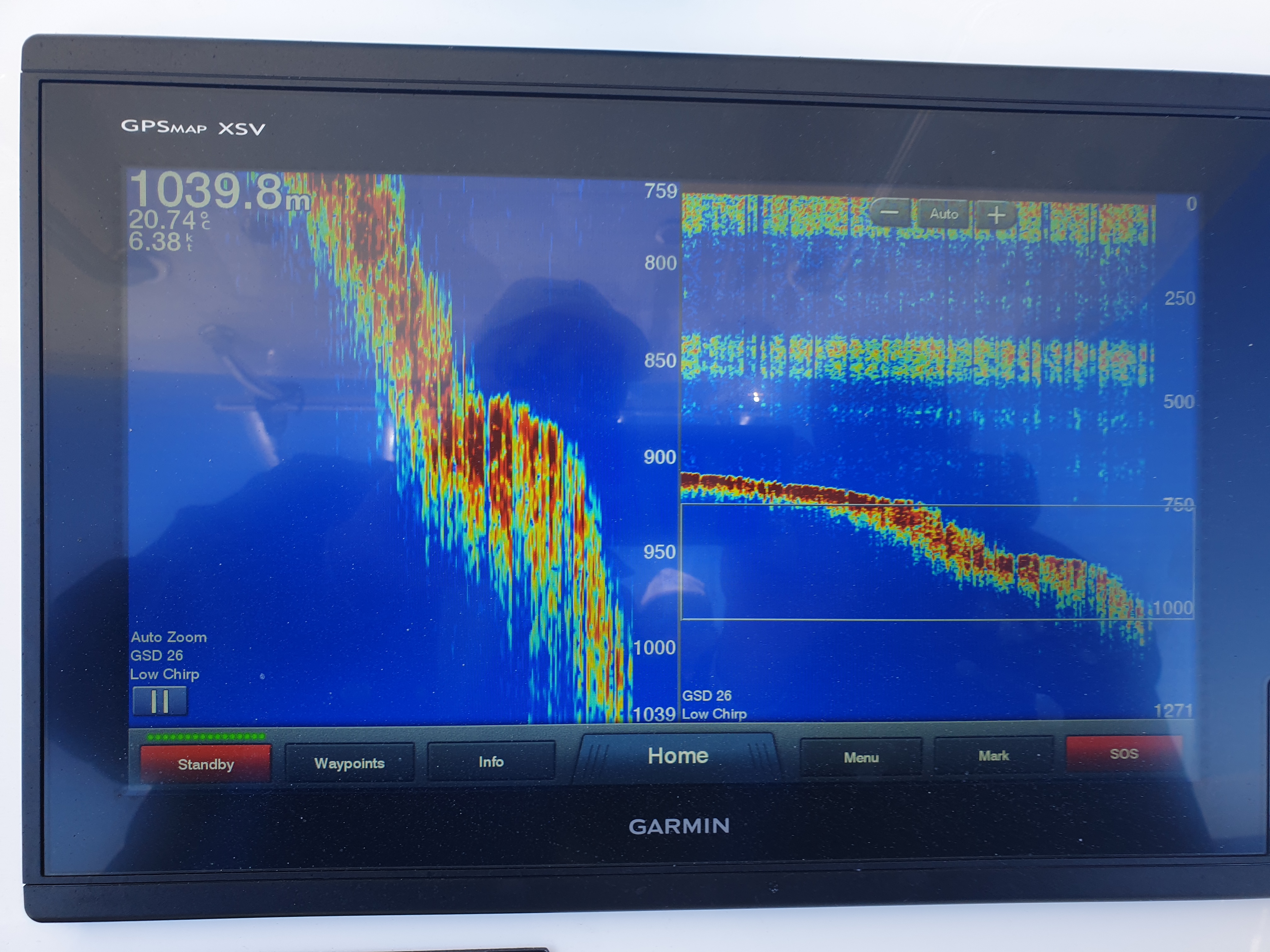

1000m deep.
1600m was as deep as went, Still pinging away happily.

 most issues with mounting a fairing block in trailer boats, apart from having actual hull space to do it, revolve around actually getting it on the trailer. certainly returning a good picture.

 certainly a good pic out bloody deep. im assuming you were out in the trench.

Yep, in the trench. It was
Mon, 2019-02-11 15:01
Yep, in the trench. It was interesting to see the Deep Scattering Layer, which was nearly 100m thick from 350-450m......We have never had a sounder powerful enough to pick it up before.
Would be good to be out there at night and see it come up towards the surface....hopefully together with a Sword......

Posts: 307
Date Joined: 01/09/09
Deep fish
Mon, 2019-02-11 16:48
 Hey John is that fish in your last pic between 1250-1500m ?? If so what are they ??

Posts: 8786

Takes some guts to cut a hole like that in a new boat
