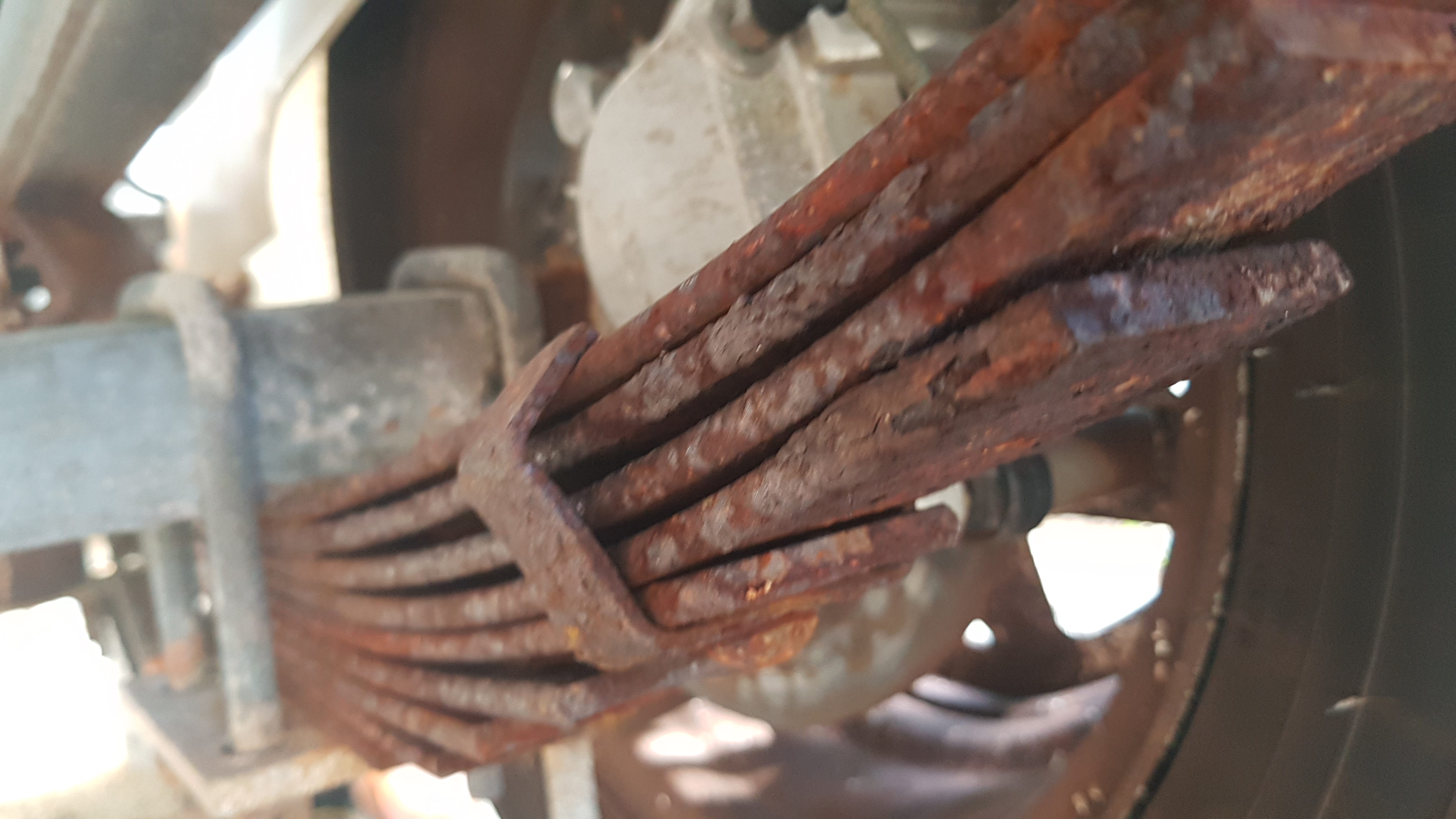

Trailer query - opened rebound clips
Hi Guys, Just after some advice on some opened rebound clips on the leaf springs on the trailer - Is it a major concern? and can I fix by clamping the springs and or trying to close them. Thanks for your advice.

What you've got going on there is a build up of rust between the spring leaves. It looks like early stages & the springs could be dismantled, blasted & paint. I have a worse case picture showing broken leaves but I don't know how to insert the picture.

 Looks like quite a lot of rust... consider replacing them with new to play it safe?

 Sorry to say They should of
Mon, 2021-04-05 20:56
 Sorry to say They should of been replaced 2 years ago.

 Springs are cheap , roadside
Tue, 2021-04-06 08:06
 Springs are cheap , roadside rescue somewhere in the middle of bumf£€k is really expensive.
 Those springs are definitely
Tue, 2021-04-06 11:05
 Those springs are definitely shot, just replace for a couple of hundred $

thanks for the advice guys
Thu, 2021-04-08 12:02
thanks for the advice guys appreciate it.....looks like it is time to go shopping :)
