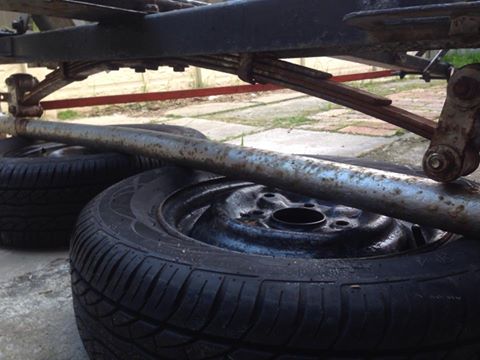

hi I recently purchased a 12 foot fiberglass dingy with trailer ect
noticed the bearings need doing so I took them off and took the hub to my local trailer place and he informed me they are off a valiant car over 30 years ago and are unreplacable
he said my only option is to buy a new axle new hub and new bearings with new u bolts ect. my question is that is gonna cost me 250 plus the person to do it is 2 hours labour which is gonna cost me 160 so im looking at 410 all up instead of a cheap 50 or so I thought it would cost
does anyone have any suggestions? how much am I looking at roughly for a new trailer or second hand? is it worth reparing? I only paid 1200 all up and don't really wanna keep throwing money into it

 By the looks of them i would
Wed, 2014-07-30 16:27
 By the looks of them i would say your axel and u bolts looks the exact same, 400$ isn't that bad I didn't think
specially for piece of mind

Ah yeh basically what Troy
Wed, 2014-07-30 16:37
Ah yeh basically what Troy said hahaha
BUT what are the bearings, sure you might not be able to get them as a kit but probably can still get them from somewhere?
You can get trailer kits with bearings axles hub etc etc for that size for about $300 if you wanted to DIY

 It looks pretty bad, but if
Wed, 2014-07-30 16:57
 It looks pretty bad, but if you local trailer place isnt Martins, then Id take it there maybe?

May as well do your springs
Wed, 2014-07-30 16:58
May as well do your springs as well if they’re anything like your hubs ..  lol ( BLOODY BOATS )

I also would recommend changing your setup as said above, but if that is beyond the budget, take the bearings and cones (that the bearings sit inside) down to CBC or any other bearing supplier and see if they can match them. They are likley to have aceess to a  wider range than the trailer supplier you visited.

ive edited it if you could please have a check and let me know thoughts.
spoke with bearings state wide he said he should be able to replace them

Mate, you can get pretty much ALL parts for Valiants (I reckon I have bought pretty much all of them anyway!) both in Australia and ex US (same as Chrysler/Dodge), so I find it hard to believe you can't get hubs/bearings.
1) Try Richard at Midland Motor Wreckers, what he doesn't know about Valiants isn't worth knowing. Ph 9274 2394.
2) Pentastar Parts & Restorations - http://www.pentastarparts.com.au/store/
3) Plenty of other options in Oz & US, Google is your friend or PM me.

They are not Valiant hubs, all Valiants had 5 studs not four
Take the axle in and get them to set the new one up then its just a half hours work for you to stick it on, doing up 4 sets of bolts and putting two wheels on cannot be that hard.

carnarvonite so take my remaining trailer bit in and tell them I want a new hub for it? then they can get my size and I can do it?

Take the axle in for them to measure the length and weld the spring locaters on, they can fit the new hubs then all you have to is take it home and stick the u bolts on and fit the new wheels
Getting hubs and bearings to match what has come off would be near impossible so it is best to replace them altogether with something that parts are going to be available for in the future

been told I can get the bearings replaced by statewide bearings just gotta take them in

Bearings are simple things to fit, there was quite a bit put on the site a while back with pics showing each step, just got to remember who, could have been Rob H but not sure.
Google it if you have any doubts and ask questions on here if you get in trouble.

got it all sorted guys! found the bearings and did it myself :) statewide bearings where amazing
