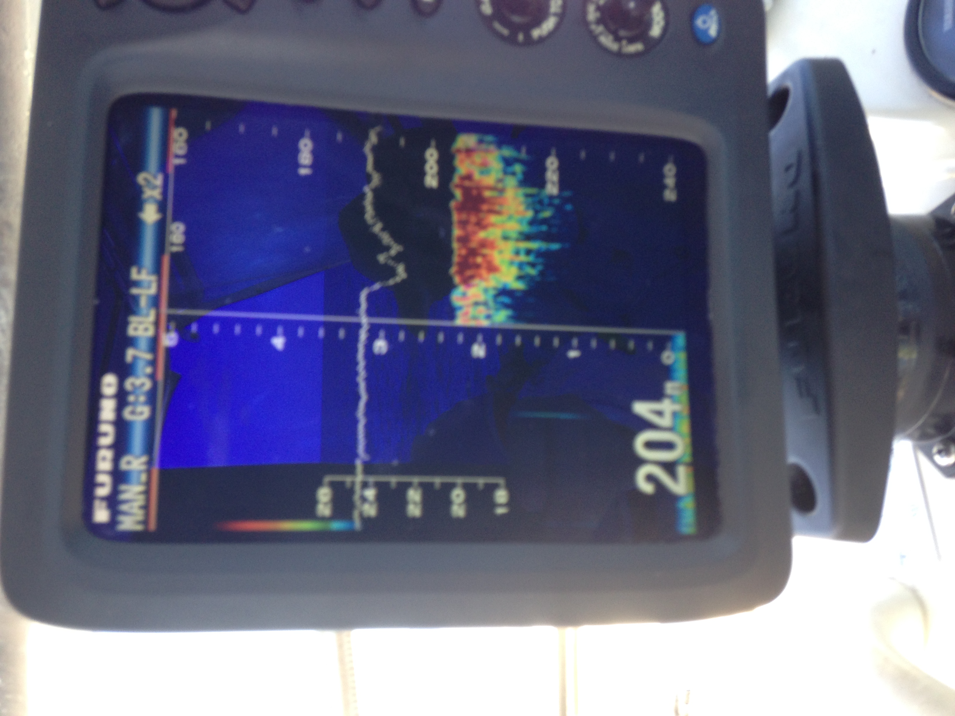

Up in Coral Bay at the moment and my sounder has started playing up. It's a Furuno 587 running through 2 x 1kw Airmar transducers. Relatively new with little use.
Was working fine and then the bottom trace just started to get thinner and thinner until it disappeared ! The bottom lock display just got lower and lower on the screen until it was gone. I was running on the 200 so I switched over to the 50 only to have the same problem, no bottom trace. Checked all connections, all dry and tight. Then a couple of hours later it started to work on 50 but kept on drifting in and out. The 200 works but only in water less than 5 meters. 50 works in 200 meters but keeps losing the bottom trace.
I don't know if I have an issue with the transducers, the leads or the head unit. Anyone else experienced anything like this ? I am going to ask around to see if anyone up here has a 585/587 who is willing to help so I can swap over the head units to see if I still have the problem.

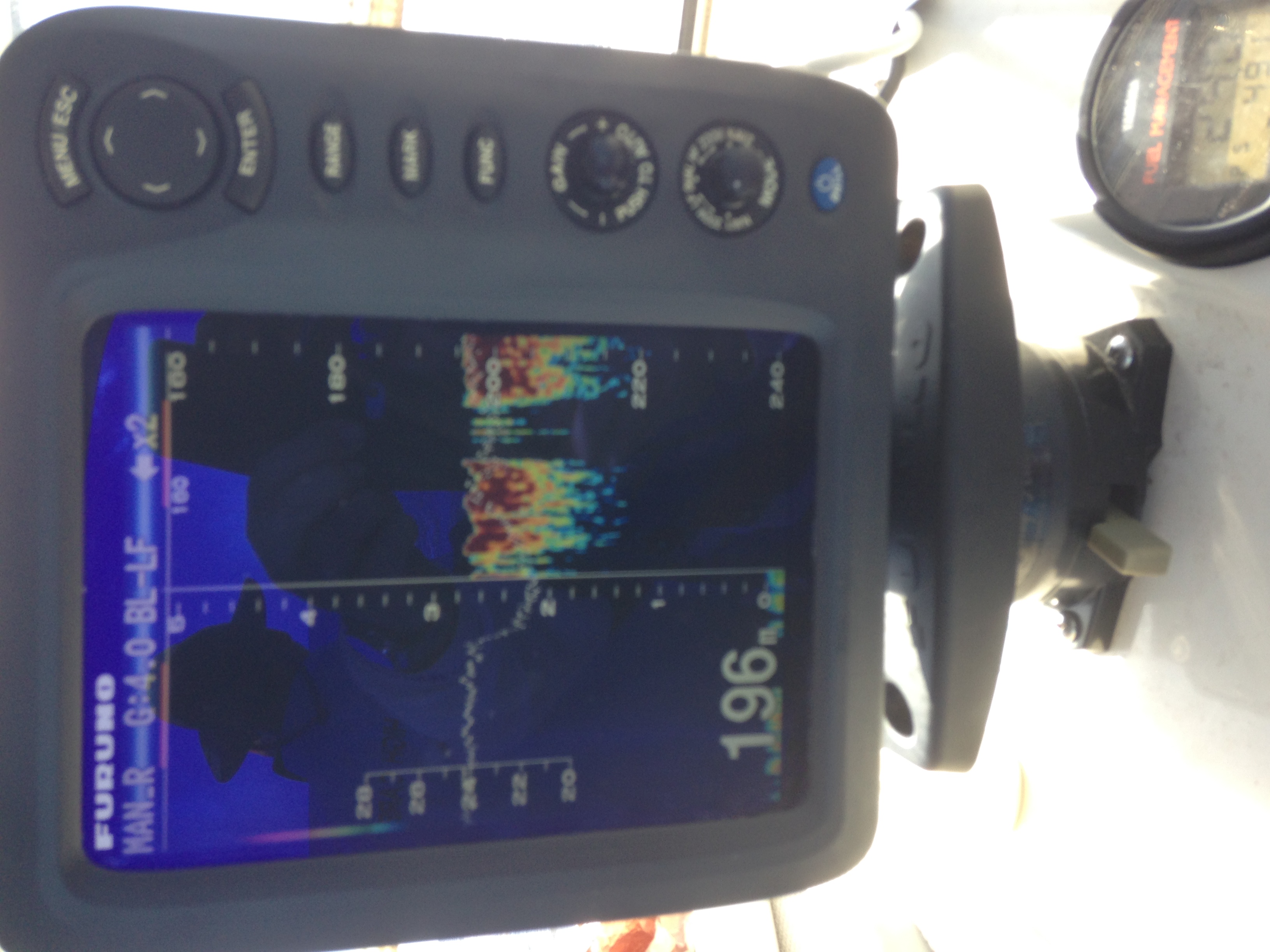

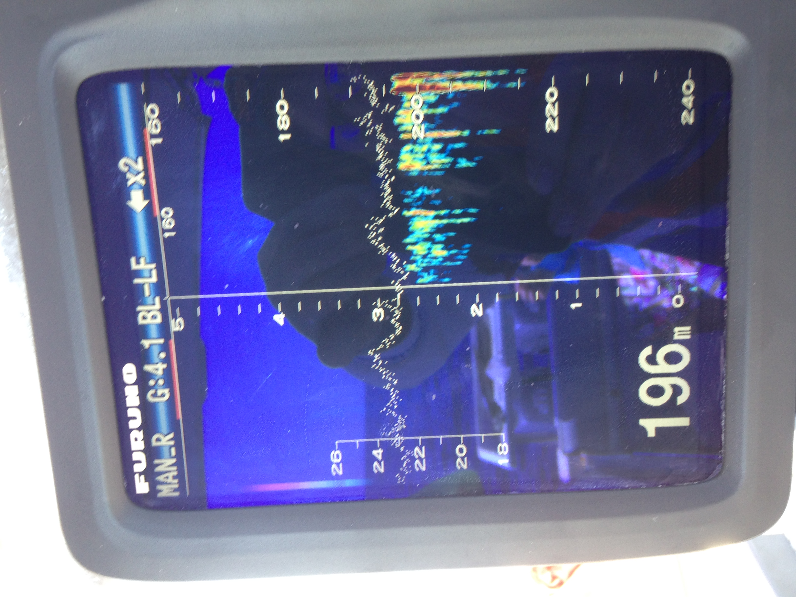

I will post up some pics of the screen. It's weird, the temperature graph even starts to fall away. Any advice or help would be appreciated as I am running off the 600w Lowrance sounder in my HDS8 as a backup.
Note how erratics the temperature line is.
