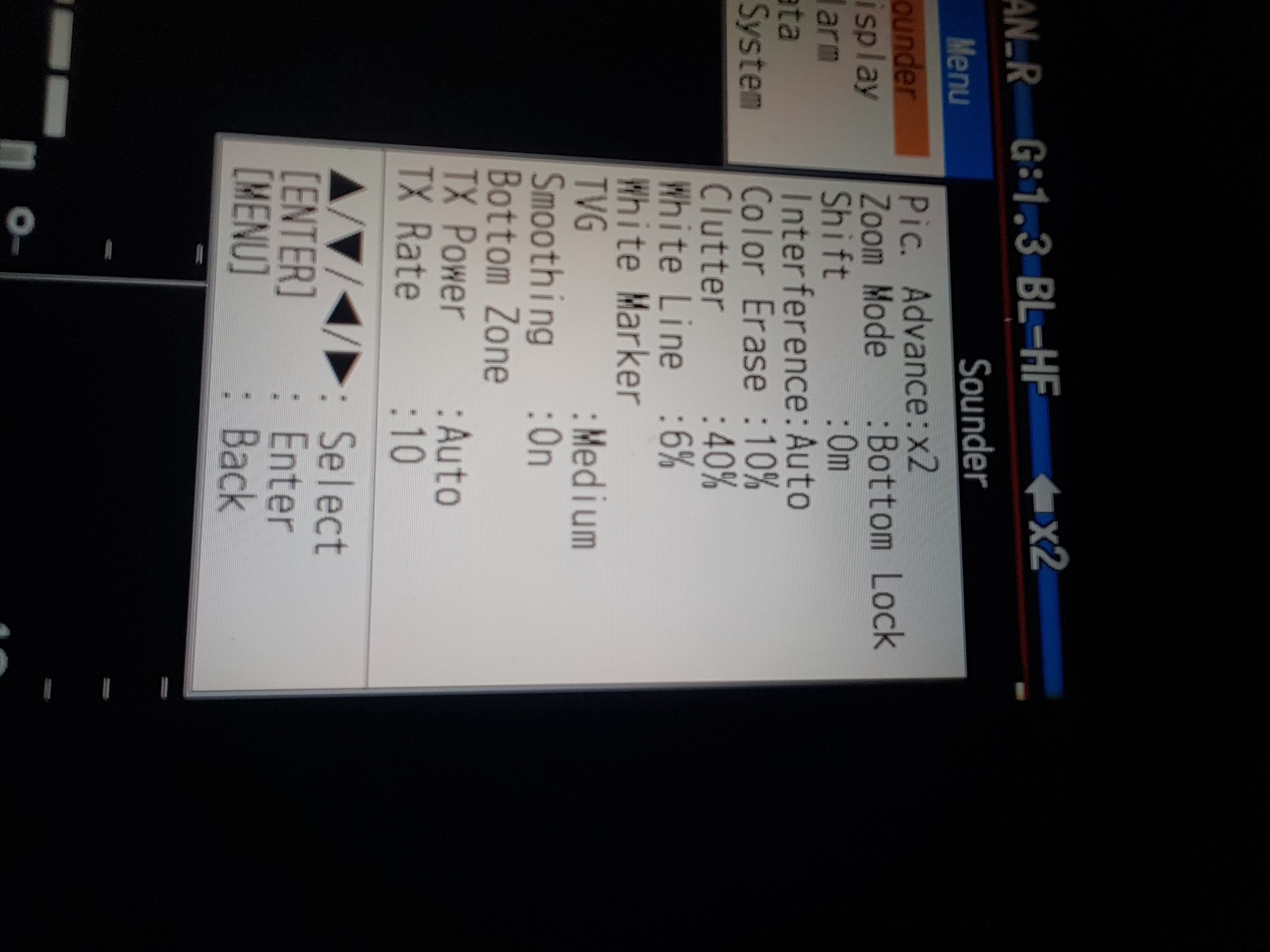

I'm having some problems with my furuno 585  It has a tm258 1kw transducer I have to have the gain up crazy high to pick up bottom in 50m of water I have to have the gain at 8 to pick up bottom and anything over 60m gain is on 10 and at 110m I loose bottom totally even if I am in neutral still wont pick up bottom but once I get back to 110m it starts to pick up bottom again but very patchy no chance of seeing fish until back in the 50m range could the tranny be stuffed? It doesn't get any clutter on the screen with a high gain like my old previous boat would with the same sounder. I'm running it in HF if I switch to LF the screen is just full of clutter and wont get any ground image.  Not sure how old it is  it came with the boat. Do I just bite the bullet and get another transducer.

Hi rod do maybe a few
Mon, 2020-06-22 21:15
Hi rod do
maybe a few settings that may not be right, I have set mine up for below 100m with
tvg on medium
clutter 20
colour erase 15
and interference on low.
and when I head out deep turn tvg to high.
hope this helps

 Hi Rod I run the same set up and only have my gain on 5-6 up to 60mtrs. What setting are you running in the menu's

make sure the transducer is installed correct, ie not angled too far forward and is actually pointing straight down.  TVG on medium. Turn clutter off and set it in auto and see how it goes.  If you don’t read over 100m in 200khz, then I’d get it checked out.

 Ok thanks guys I will post
Tue, 2020-06-23 14:14
 Ok thanks guys I will post up my setting but there the same settings I have run on my last 585 I did a factory reset to see if that will help and then put in all my settings.
If I put interferance to med or low I loose bottom has to be on high.

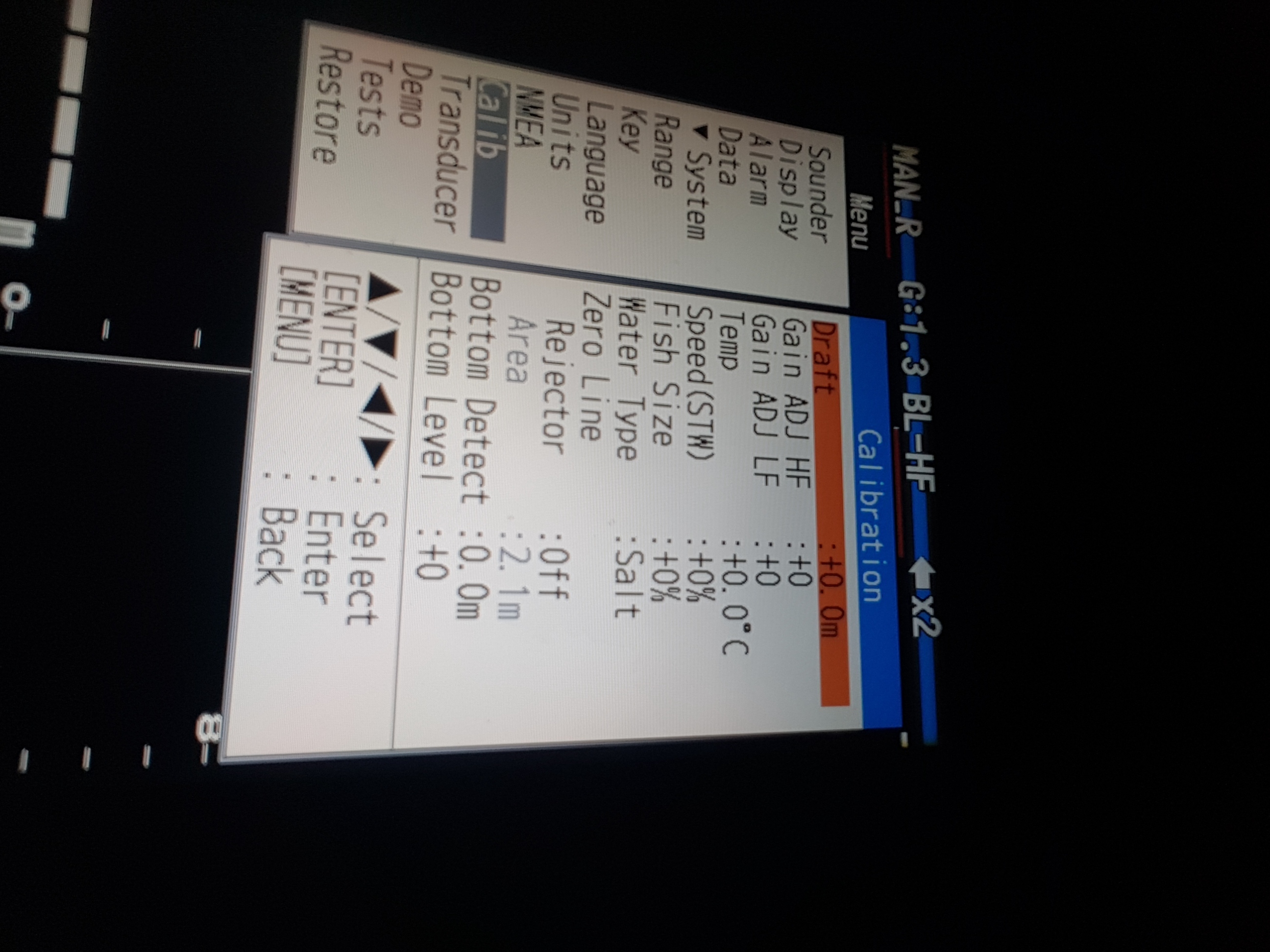

Little Johnny what do you mean internal gain settings?
Posts: 5379
There is one
Tue, 2020-06-23 14:33
In your menu . You can adjust ( not your external) knob one . If you done factory reset this could have gone to lowest setting. Hence why you have to really crank knob one up so high to get reading . Only guess ??

Little Johnny is referring to
Tue, 2020-06-23 16:07
Little Johnny is referring to the settings in the "calibration" menu.
There is a setting for HF and HL gain Adjust.
I believe the range is +20 to -20, I think default is 0.
If you have this set to minus 20, even with the gain on 10 on the dial you won't be getting much power.
Also, check correct transducer is selected from the menu.
I had this setup before but with a TM260 and it gave clear bottom readings in 500m with gain on 3. (but +15 on calib menu)

 Thanks guys I dont feel it's
Tue, 2020-06-23 19:55
 Thanks guys I dont feel it's a settings issue but have checked all my settings and I dont see anything out of the ordinary the gain in the calibration settings are all on zero should they be turned up. I have had a 585 previously on my last boat but with the ss264 transducers and I dont remember changing any internal gain settings for them.  I tried all the transducer options in the menu  and there was no difference on which one I selected it's currently on 526TIDHDD
I was thinking of trying to find someone with a furuno and get them to run my head unit my only problem is i live in paraburdoo so can only do it when I head to the coast I will ask around at work as there are a few ppl who work here but live in exxy maybe one of them may be able to help out it's a hassle when I'm so far from the water as I dont really want to be stuffing around with it when I finally get to the coast for a fish.

Prob is different issue.( just a thought) I use JRC . Just watching how others I fish with use internal one on 585 .they increase it . Then use external one ( increase to depth and speed). Makes the bottom reading so clear and find fish heaps easier . Good luck I hope you sort it out .
