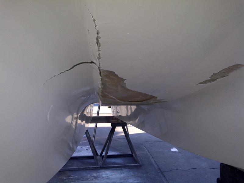

Was in Hillarys this morning and had a look at the damage. vessel was a Markham Dominator about 5 years old. Spoke to the crew who went out to rescue them and they said it was very rough conditions. Took 7 hours to tow the vessel back to Hillarys up side down. Looks like a write off.

Looking at the pics it
Tue, 2011-07-12 13:20
Looking at the pics it appears to be fatigue cracking along the most stressed part of cats hull. However, the design of these hulls should take this into account which would prevent this from occurring. I believe Markham need to investigate this hull to determine exactly what has occurred so as they can discount design flaws.

Design flaws it really could
Tue, 2011-07-12 13:25
Design flaws it really could be anything. I'd keep an open mind.
Could even have been previous damage from maybe loading on trailer too fast and hard. Just don't know yet..

Hitting something,
Tue, 2011-07-12 14:20
Maybe hit something previously, started a small crack?
Seems like excessive damage from just ocean travel.

 I am the owner of this boat, sorry I didn't reply to all of you because I didn't know about this website until yesterday.
Now on the day that it happened the wind was less then 10 knots the swell was less then half a metre, in all it was a good day out. The boat itself just de-laminated, like all boat owners I hand washed and babyed this boat. Never seen any stress cracks or other damage anywhere on this boat, only took minuets to sink. Markham himself inspected the boat and refused to accept any liability at all. Could say a lot more about mark, he has never offered any help so I could get another boat. Insurance company did lots of stress tests and came to the conclusion that the boat NEVER hit anything and it was a manufacturing problem.
in conclusion lost half the value of the boat. I would like to say to the men who rescued myself and friends, a big thank you very much and the weather did change late in the day when the boat was towed back. I have never heard from Markham since, and I would like to. Thank you all, for your concerns. Hope I answered all your questions

 Thanks for jumping on here and updating, many of us have an interest in this sort of issue.
To be honest Im not suprised the insurance company "found nothing", a bit like the Tobacco Institute being unable to find any link to cancer.
The insurance company should have at least been challenged on their "findings", if they werent.

 Where did he say they “found nothing”?
The guy said they did testing and found no evidence of an impact and concluded that it was a manufacturing fault.
Posts: 5842
what’s confusing?
Fri, 2018-04-13 09:35
 The insurance company found nothing to indicate an impact, hardly an unbiased party.
Considering that if they had, they would have had to pay out $100k+

And to be honest it looks more like manufacturing than anything else but my point was that the Insurance company will always find in their own favour in the absence of any resistance.

Surely if this boat was built in the same way that every other boat that comes out of that factory has been there has to be a call up like they do with faults on cars?!?!
If i was a Markham Whaler owner i'd be wanting my hull extensively tested, you buy these large ocean going vessels for comfort and safety while fishing wide, you dont want peole loosing lives because of faulty worksmanship if that is the case above....

 I can’t profess to being a great cat fan.
But generally speaking any modern well constructed vessel should be able to handle well in excess of what the people on board should comfortably cope with at least in terms of structural failure.
Many years ago i skippered a Cougar Cat charter boat up north, that developed tunnel cracking probably quite similar to the pics here, at only 2 yrs or so old.
I’d have thought the construction techniques and scantlings would be much better understood in the 20 yrs since though.
