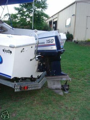

As the title says I have had my baron for 4 years now and have worked out what works and doesnt work for me so now it time for some mods. Fishing use is typically out of sydney with extended trips (30NM each way) limited trolling but mostly shallow and deep reefs.
1. Engine is a 1980 150 hp evinrude which wont die. Each year Ive said when it dies Ill upgrade, whilst the power is good the fuel economy & fumes are a killer. Looking over the forums there seams to be a huge range of engines fitted to these boats from 75 to 225 hp. The fishing magazine article I have when these boats were going to be released on the east coast had a maximum of 175hp. Ideally I wont to keep the same performance as I have now (not quite sure if my OB is still putting out 150 but I can get 40knt on a good day) but am interested in peoples experience with other HP range engines fitted to these hulls.
2. Fuel capacity. Have an underfloor custom aluminium tank that runs down the centre but only have 100lts usable capacity What sought of capacities do others have and is it enough? Im expecting a new engine will halve my fuel usage so this may not be an issue???
3. Transom layout. Dont really need the rear quarter seats and would like the extra room that I would have by utilising a straight transom and a pod. Whilst I have seen a few Barons fitted with pods were they an afterthought (along with all the issues that that can cause) or are they a hull that readly lend themselves to the fitting of a pod and ideally a 150hp 4 stroke?

Johnson 140hp 4 -stroke (40% fuel saving, but cost more to service and repair) on my Baron, wot gets 30knts, weather permitting, on a full load( 3 divers ) raised (5")and strenghtend the transom, removed the ali tank (started to have pit marks), use 25lt plastic tanks, under the floor ( good indication of how much fuel is used or left), and jerrys if heading 35nm off shore. A 150 or 175 would be nice, as an option if you ever decide to get a bigger boat ( 6.2m and up) transfer the motor. Leave the rear seats in and imo don't put a pod on, the older inboards have pod mods...

pod it
Thu, 2011-06-23 21:19
bobakers , from my experiments i would hang a new motor out on a pod and close up the transom to increase deck space , as for a motor you know that the 150 handles well for a 18.6 ft boat so why change , just choose a brand
