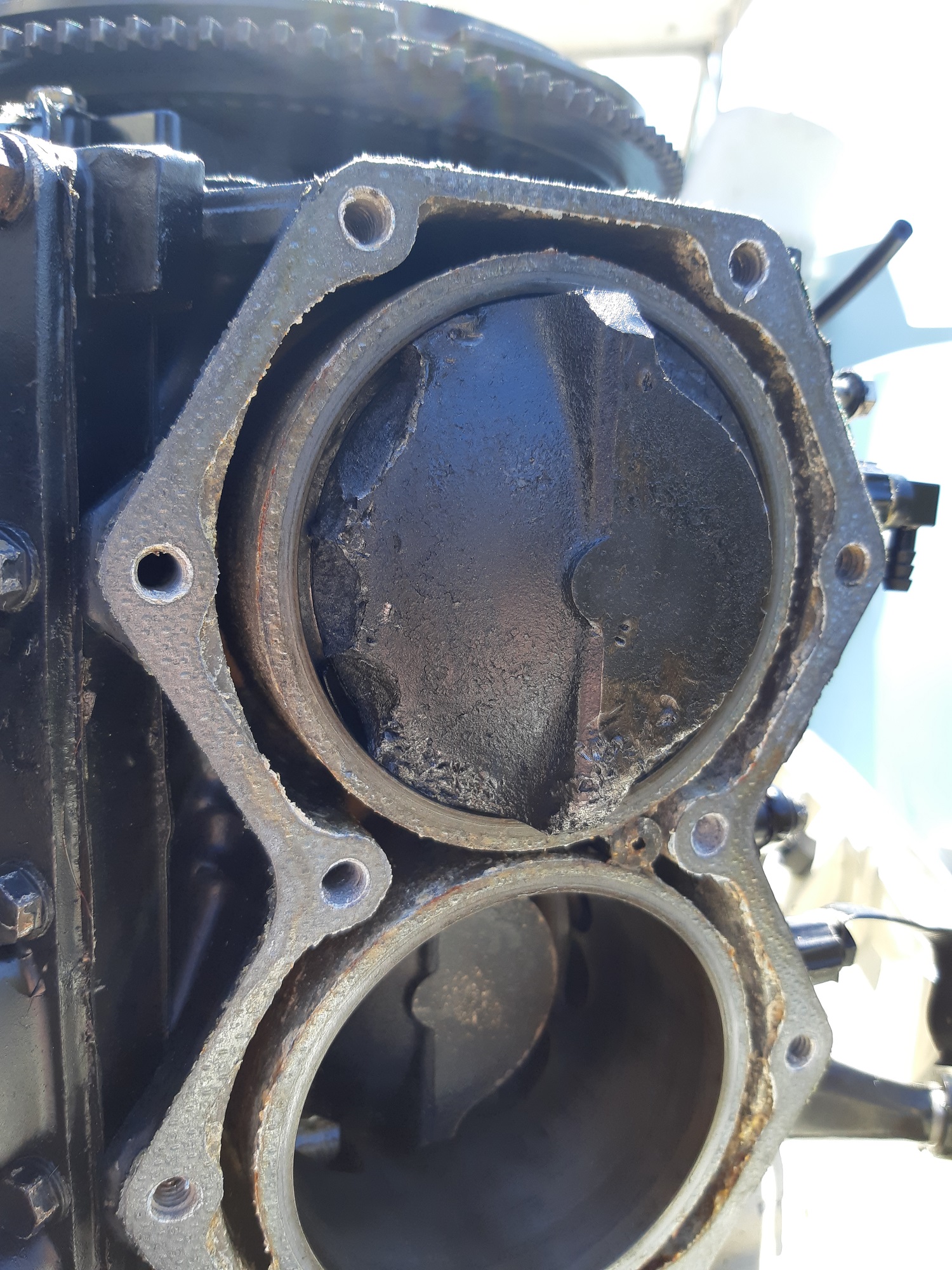

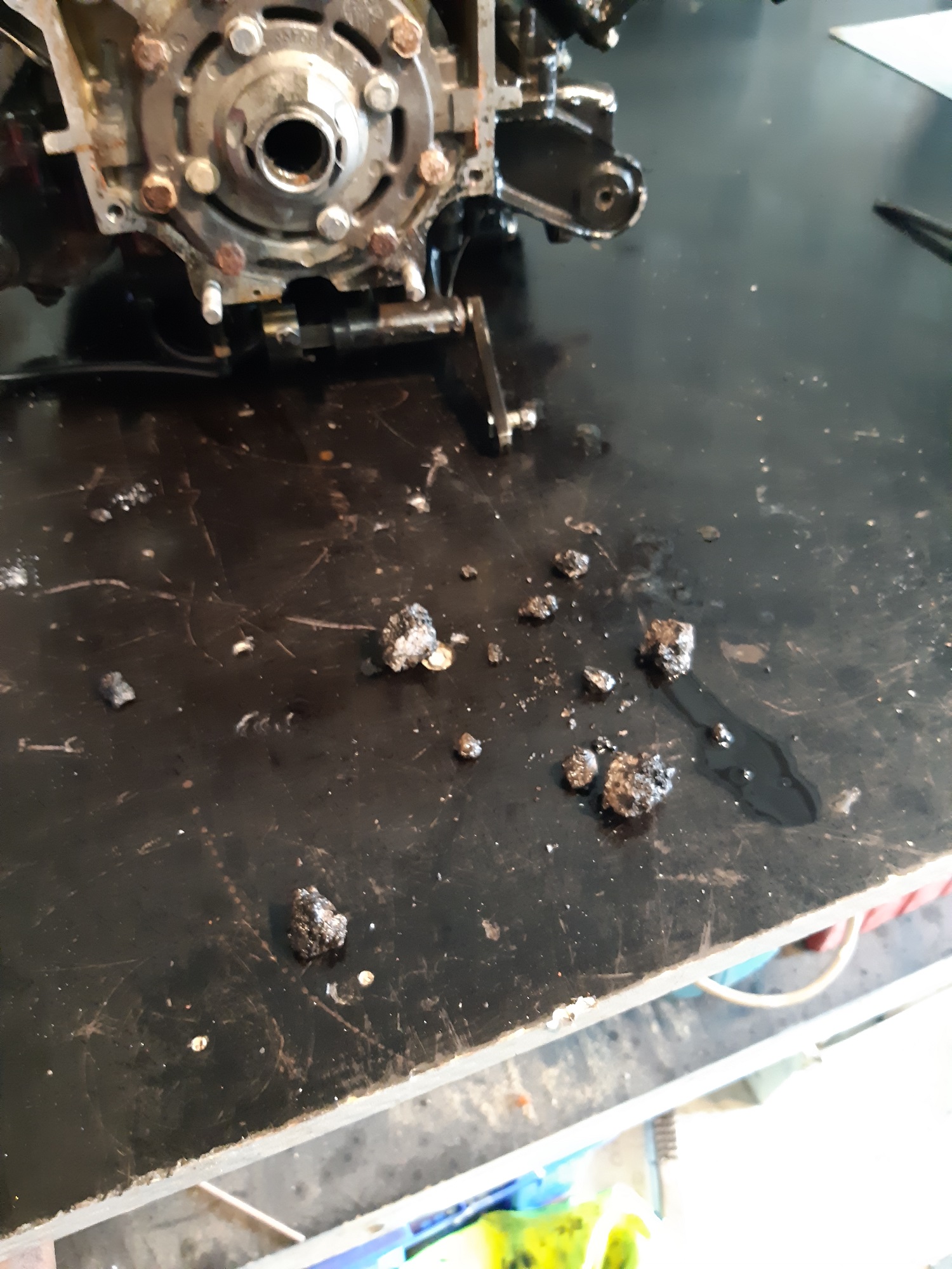

Well completed a full rebuild 4 years ago after the rings went.....and again a piston has let go.

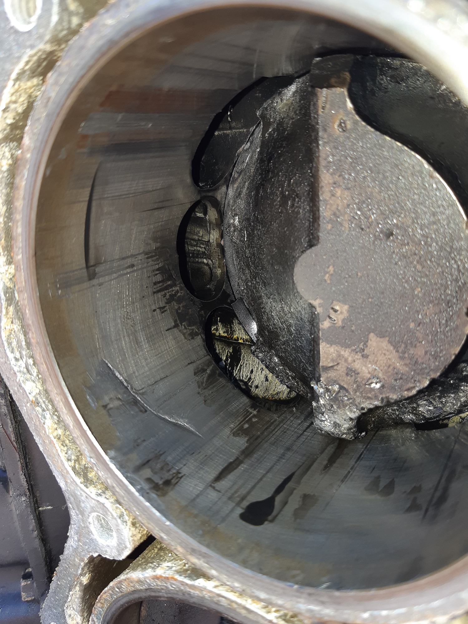

Should have the piston and rod out tonight ready for a quick hone and inspection....budget side of it I'm just looking at replacing the one...other cylinders came up 120, 115, 110....Its pre-mix so its always on the rich side, not sure how the exhaust side has blocked up but thinking the heat build-up could have contributed. 1995 Johnson 115HP 2 stroke.
Looking at few weeks for the parts to come...back together for under $300...

 Something tells me it’s going to be a little more than a quick hone. Maybe a quick resleeve?

 that doesnt look healthy at
Wed, 2018-09-26 17:33
 that doesnt look healthy at all. good luck with the rebuild. might be time for an upgrade

That bore looks like it needs more than a hone

Rammer...you could be correct, these motors were common for HOT spots in the top cylinder due to an air lock in the water passage, an old Johnson memo gives instructions for a new tell tale location at the top right hand side which i installed during the last build...It does seem to have got to hot...learn mix, too much advanced timing possible.
Yes it needs more than a hone...a sleeve is the only correct fix.
But in this case its going to be a $300 gamble...the two main scores are right at the top and bottom of the stroke so will see how it goes..will lose a little compressioN, MIGHT GOT BANG ON START UP.
I should have just gone through insurance from the start...not sure if they cover these instances.
Will update once its back together.
