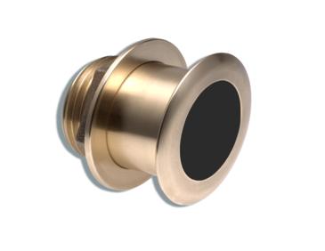

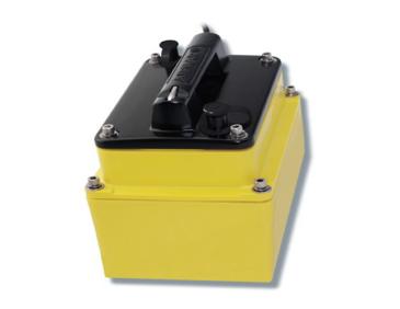

raymarine - which 1kw transducer ???
been getting some varied advice on the best way to go for a 1kw transducer...
the 2 options i have it short listed to are an in hull wet box type transducer and a through hull 20 degree transducer
the shipwright im going to use reccomends the through hull but when i speak to the dealers they are trying to talk me into the wet box in hull style. they both seem absolutely confident about there option being the best way to go....
the arguments so far consist of....
im told by my shipwright the wet box in hull transducer loses 15 - 20% power by having to shoot through the fibreglass hull and the possibility of any small air bubbles in the existing glasswork can cause issues....however the dealer assures me this isnt a concern and they work extremely well regardless...
the through hull transducer im told by the dealer can be a concern - obviously having broken the integrity of the hull by drilling a hole for it to go through...
( this is a 24 foot fibreglass trailer boat )
most of the time ill be fishing fairly shallow for demersals however i do want the capability to go deep 300+ when i get the itch...
opinions as always appreciated
have attached photos of either option.... the through hull potrudes 6mm and the raymarine website says it is strong enough to sit on trailer rollers etc without hurting it....
Gooooone Fishin!

i have the thru hull ss164 which is great but the m260 has more elements and is more sensitive! the only reason i didnt go for the m260 was room they are fairly large!

I went the through hull,
Fri, 2012-09-07 17:16
I went the through hull, brass with temp sensor in mine, no probs picking up bottom after the 100's at 25knotts & even out to 400m trolling

Sat, 2012-09-08 08:03
 Looks like I'm drilling the hole - thanks for all the advice, better to trust a shipwright than a salesman I reckon and most of you guys seem to have done it without any issue.... besides.... There's already holes for water intakes for live bait, toilet etc, one more wont hurt ;-)
