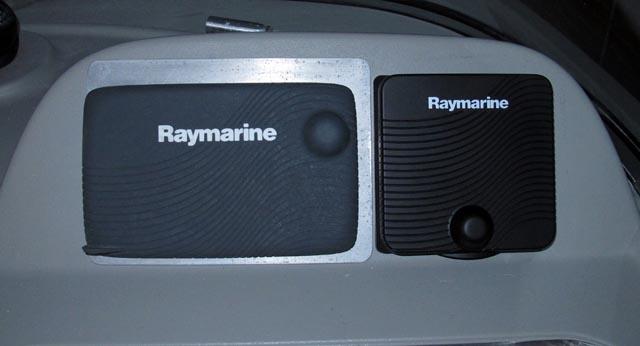

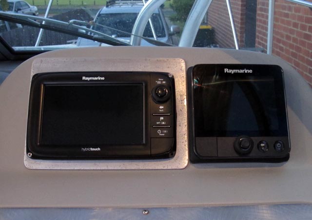

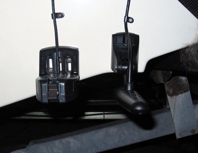

When i got my Dragonfly the first thing i did was ditch the bracket, maybe mine was broken but it wouldn't clip in properly so i resorted to a temporary flush mount system using 4 bolts. The Transducer installed quite easily although isn't as firm as most. This is due to the bump up system that transducer has, which would make it perfect for the tinny while skull dragging it through the mud! The 6m cable was only just long enough to get to the helm in my trophy. Apart from that just a standard install. The wiring didn't come with a inline fuse so don't forget to put one!
The Flush mount kit is easy to install and the suncover makes a good seal that should keep water out.

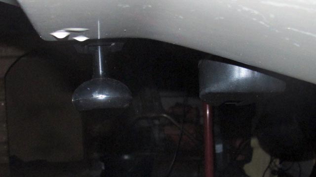

You can see from the photos how the transducer sits lower than my standard p66 due to design.

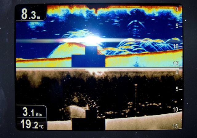

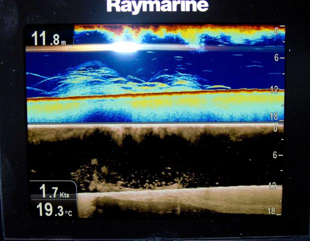

I took it out for a test run tonight, it was dark and i had not changed any settings and the results are remarkable, they leave my E7D with 600w transducer for dead, the clarity is amazing and it clearly shows separated fish (and proven we caught fish where it showed fish) I managed to get a couple of shots of the D9 and another wreck. Note the photos i have i did not set up, it was a quick drive over and take a photo.
The image becomes a bit patchy as you can see in the images when the depth change quickly but it wasnt a problem.
The sounder read perfectly at 20kt and It made seeing the difference between weed and sand so easy.The Chirp and down vision on the one screen make defining structure so easy, you can clearly make out edges of boats and moorings which would be a blob on most sounders.

Yeh i put both tranny's 4''
Sat, 2013-05-18 11:55
Yeh i put both tranny's 4'' apart due to restricted mounting options and i cant run them together, the chirp gets a fair bif of interferance. Next time i take it out ill take some photos of it. Ill PM you about E7D's a bit later!!

Nice write up Vinesh, can I take advantage of your knowledge of downscan and ask a stupid question?
I'm trying to get my head around my DSI cone of vision in regards to what I'm seeing scrolling across the screen. (I have a lowrance dsi unit)
So I'm going to try compare it to what sounder shots are showing. From what I can gather a Downscan cone is wide (port to starboard) but thin (fore to aft).
So, in your first image of the D9 you can see the full length of the boat because you were travelling parallel with it. Therefore as your moving along the length of it the sounder is showing the height changes, which once you've gone past it results in the picture you can see.
Then, the second picture is you crossing it in a perpendicular direction. So as the sounder is scrolling you get to see (what looks like) the bow, because once again the sounder is showing the height changes which result in the picture.

I fitted one ( Dragonfly ) last week to my friends 4.3 Clark . As you said the mounting bracket was a bit funny to use but we got the hang of how it worked. You have to press it into place a certain way or it dosn't want to click in . (bit hard to explain how it works )
The transducer mount appeared to be very cheaply made as well . They way it clipped on the mounting plate was a pain for us because there is a step plate on the boat above the mounting point. I had to have the bracket all togeather and hold the trany up to get the screws in place . But in the end it was a simple unit to install .

How low did you put the tranny ? after a few threads of late i think mine is wayy to low but i thought the lower down the better but maybe not...
Yeh i coouldnt get mine to clip in so i binned it and flush mounted it haha.
 I was able to see whiting on mine and big pinks with solid archers. Still very happy with it and will get some more images up soon.!

 Got a photo of ya transducer mounted avail...mine may be too low?
Vinesh87's picture
Posts: 2751
Date Joined: 02/04/11
 Yeh ive got one in the
Wed, 2013-07-03 20:59
Yeh ive got one in the thread pics above !
Posts: 358
Date Joined: 12/05/12
Geez I'm blind
Wed, 2013-07-03 21:02
 Mine is mounted about the same I reckon...maybe a bit more away from the chime? So far so good just need some decent weather to give it a good crack

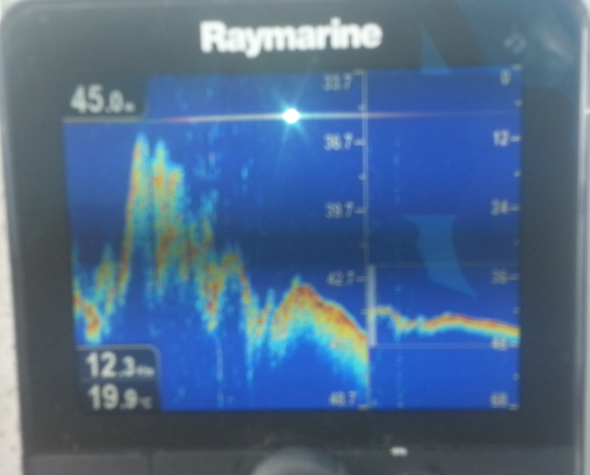

Heres a few more images and what i caught.
Bottom Discrimination is brilliant ! Only in the shallow but you get the point!
Sand whiting on the sounder and little pinkies above them !!
Pinkies and yes they were caught!
Still waiting for a deep review unfortunatly!
Everyone feel free to post your images here i look forward to more report from the Dragonfly.

i will be keen to see some structure photos from the 30 - 40m range, they look in the shallower stuff though.
Vinesh87's picture
Posts: 2751
 They will be up soon! I
Sat, 2013-07-13 19:12
 They will be up soon! I don't predict it will work very well in 30+ to be honest but it still has chirp!!

For everone else I had it out in 50m  and it was brilliant up to 24kts. Found new dhu ground and all  forgot my msd card so no real pictures yet. I was running chirp only as I needed zoomed bottom lock. It is not possible with chirp and downscan!!
Sorry!!
Vinesh87's picture
Posts: 2751
 Have added 1 deeper pic but
Wed, 2013-08-21 22:26
 Have added 1 deeper pic but from my phone its pretty average
