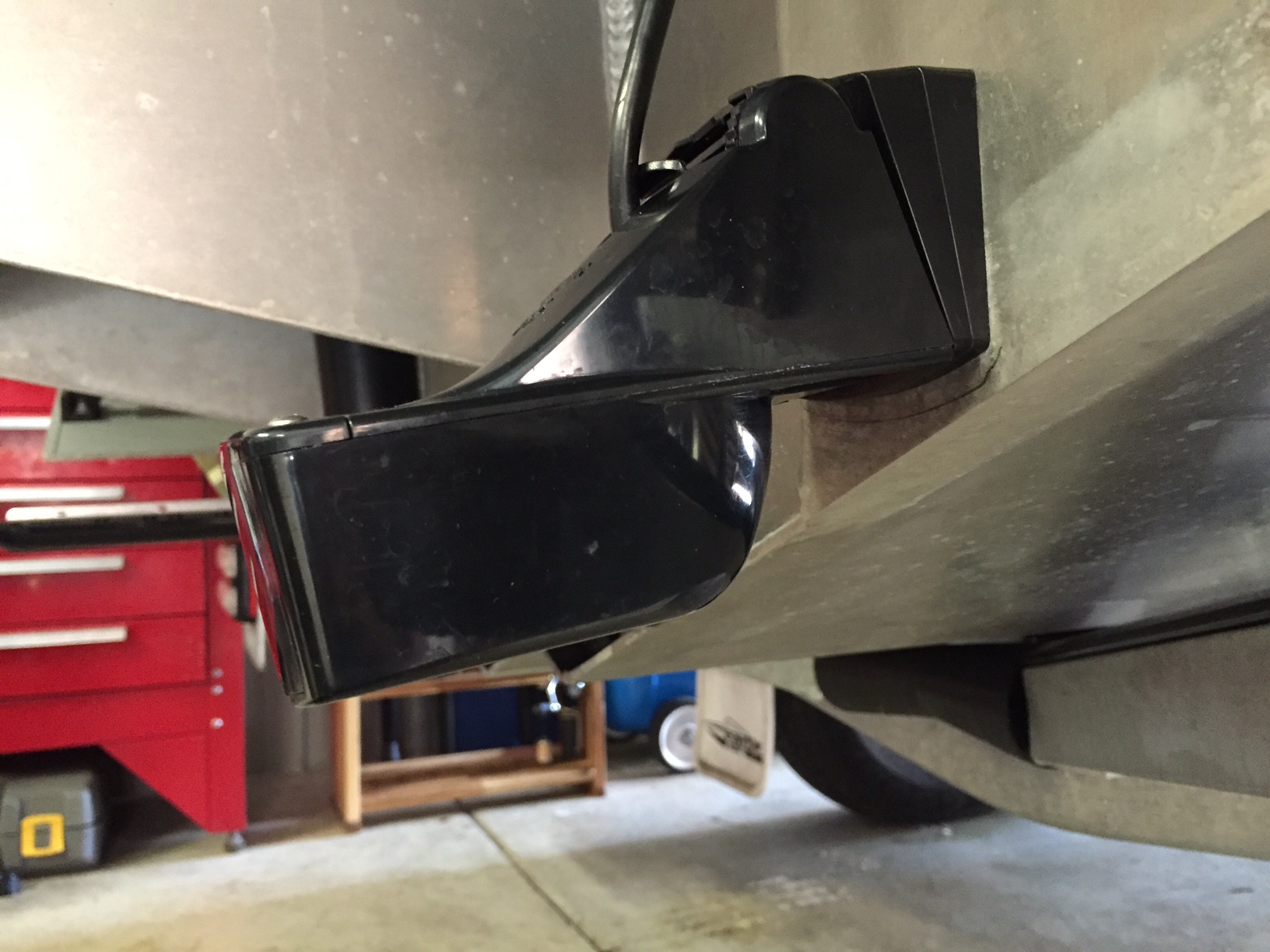

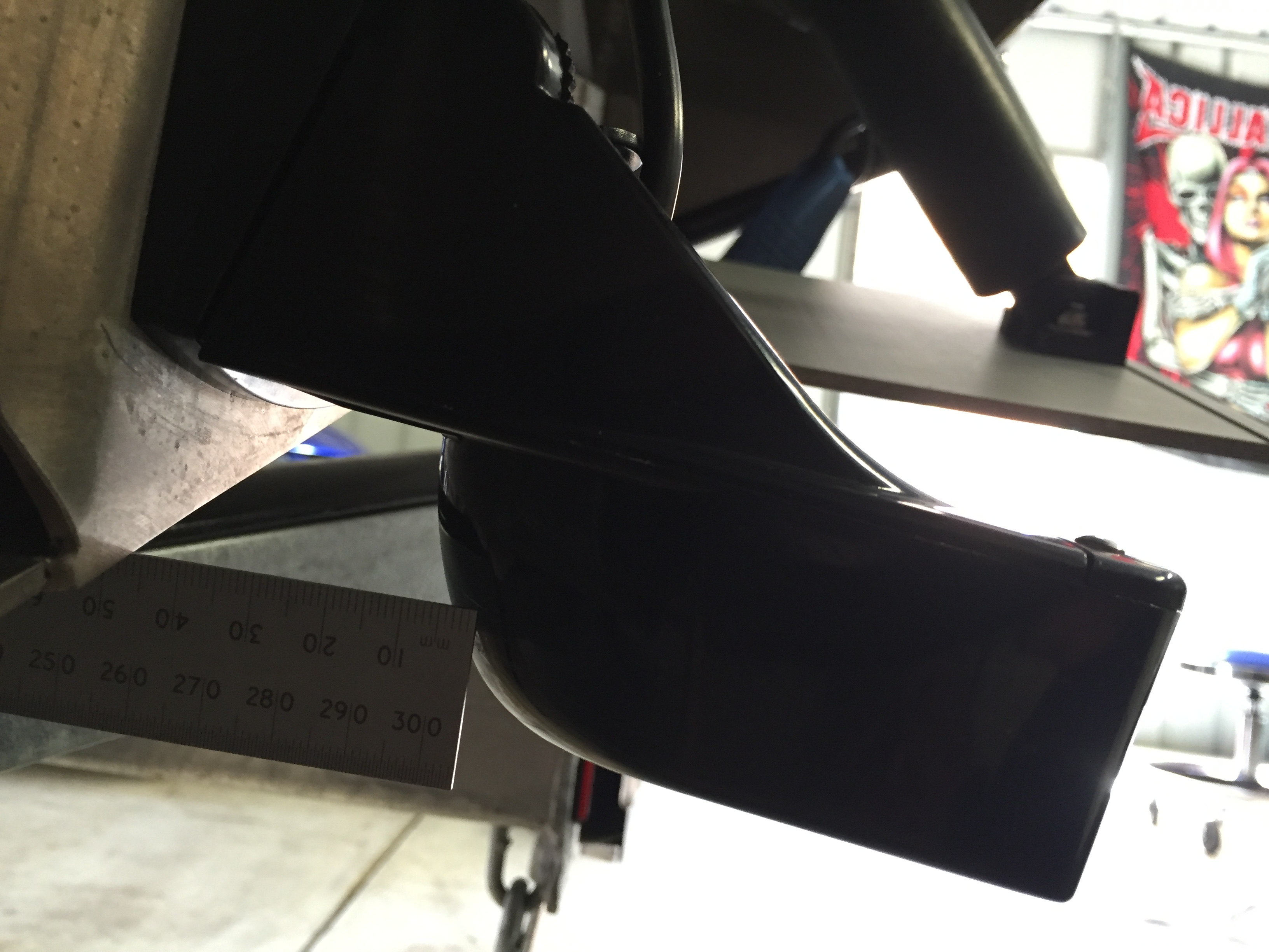

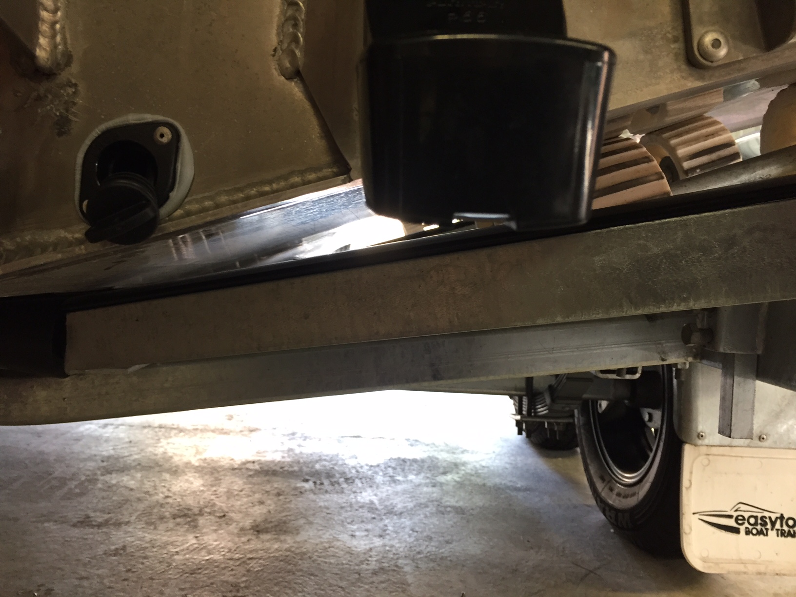

Furuno 588 is losing the bottom above 6 knots, no bottom or depth display, P66 starboard transom mount on a Barcrusher Gen 2. Currently got one wedge and have tried the recommended set up of 3mm below hull to around 8mm below the hull. With the boat on the trailer jockey wheel fully extended to simulate planing at speed the tranny is pretty well horizontal.  I'm going to try lifting it to around 1mm as per the pic, if that doesnt work I'll put another wedge in to tilt it back some more and go through the height adjustment process again. Occasionally at 20knots it picks up the bottom, next time out I'll try the turning to port and starbord and adjust the trim to get an indication of where it want to be, HT opinion seems to be "these transducers need to be buried below the waterline' any other suggestions ?

 Got a side pic? Be
Fri, 2016-09-16 09:36
 Got a side pic? Be interested in seeing the mounting plate

 doesn't look deep enough to
Fri, 2016-09-16 10:03
 doesn't look deep enough to my eyes.  Try taking a pic whilesitting on the floor and lining the hull up straight and flat.  Also the back end of the transducer should be pushed down a little so the signal fires toward the front of the boat.  If they are perfectly level then most of your signal is lost out the back of boat at speed

Cheers for the input fella's,
Fri, 2016-09-16 10:19
Cheers for the input fella's, gilly I will take a side pic and post up, Feral those pics are with the tranny at the highest adjustment possible without moving the mount, I havnt tried that setting yet, I was thinking with the lower settings, close to 10mm below the hull line on the left corner of the tranny I may have been getting turbulance but now I'm thinking I need to put another wedge in to lower the tail edge and go lower overall.

1: With the hull level you
Fri, 2016-09-16 10:23
1: With the hull level you want the back of the transducer to sit lower than the front.
2: nearly all "loss of signal at speed" can be put down to bubble entrapment. A couple of things I have noticed.....  your hull plate extends past your transom and come back flush near your transducer. This transition point can be a problem. Also there appears to be a protrusion on your hull, forward of the transducer in the second photo. This can cause cavitation and bubble entrapment.

Starbug, thats not a hull
Fri, 2016-09-16 12:01
Starbug, thats not a hull protrusion, its the spare wheel sitting on the draw bar, water coming from under the hull is clean, roger the orientation of the tranny, thats where I'm going to make the next adjustments, cheers for the input fella's.

Added the second wedge and
Mon, 2016-09-19 07:48
Added the second wedge and have the tranny mounted 10mm below the hull line, new pics in the first post, I'll post up how it goes when I've had the boat in the water. Cheers.

 Hi fitted one of these up to
Wed, 2016-09-21 22:50
 Hi fitted one of these up to my boat bout 2 months ago I used 2 wedges but ground one halfway down to get a good angle, had the rear just lower than the front. The bottom face of the tansducer was just below the hull, holds the bottom well at 20+ knots like the other guys said make sure nothings infront causing bubles. The last picture looks like the back is a little to low to me good luck

Will have the boat out on
Thu, 2016-09-22 12:44
Will have the boat out on Saturday so I'll post up, I agree the second wedge has added more tilt to the rear than recommended, if I get a result with the current set up I will get another wedge and linish it down and try a 1.5 wedge set up. Cheers.

 Success, set up as per the
Sun, 2016-09-25 12:56
 Success, set up as per the last 3 pics in top post with 2 wedges and set 8mm below the hull line the sounder was holding the bottom in up tp 40M at 20 knots, didnt get to try it at faster speeds as it was a bit choppy out there on Saturday, cheers for the input.
