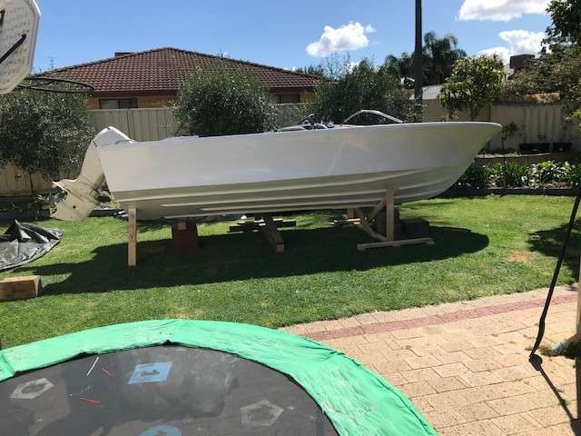

Howdy Team,
Well some of you would remember my grand plan a few years ago for a full refresh of my boat....which for the past 10 years has been a 6m Pacemaker centre console but upon measuring three weeks ago is actually only 5.6m.......Dont you hate it when you're not quite as big as you thought.
Year 1 involved removing the deck, rotton timber and foam and full rebuild up to the deck. That went smoothly and took three months
Year 2 was meant to be the outside of the hull but the trailer needed more love so I stripped it down and replaced every nut and bolt and got every other bit stripped and regalvanised
Year 3 was a deck replacement again after the timber from year 1 turned out to not be marine ply...even though it was what I paid for. New foam and deck again.
Year 4 is where we are now. Full outside strip to flocoat, bog and re-spray

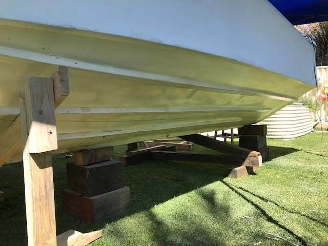

Boat has been up on blocks for a month now and we have been sanding and sanding and sanding. We have sprayed on a coat of high build primer and over the weekend I bogged up the billion placed that needed filler. Not due to abuse, just an order fiberglass boat that has been well used.
Topsides are now very smooth but the bottom needs a lot more love.
Hoping to have it ready to splash before the end of October
Bring on Aluminium!

 Have been sanding each day
Thu, 2022-09-29 12:25
 Have been sanding each day after work and it is looking really good now...until i discuovered the last batch of bog I did musnt have had enough hardner in it so didnt go off. 30 minutes of scraping it out of dents and chips later, it is looking really good again.
Hoping for coat 2 of primer on Friday then one last sand before top coat next week........then onto the gunnel and console which now look shit becuase the outside looks really good.

 -2 pac hi build with 1.8 tip
Sat, 2022-10-08 18:04
 -2 pac hi build with 1.8 tip and put a heavy black guide coat
- buzz back 180
- bog imperfections
- re prime at 10 percent thinners light guide coat
-  buzz back 240 with interface pad

 First coat of top coat this
Sat, 2022-10-08 19:38
 First coat of top coat this morning. Some parts turned our great but some parts, where the breeze picked up, will need some re-work along with the keel section that is still being worked on. Glad the topsides and 90% of the bottom is good now.
Considering how long we have been sanding and fairing and sanding and fairing, it's amazing how many nicks and old grinder marks still exist on the bottom.
