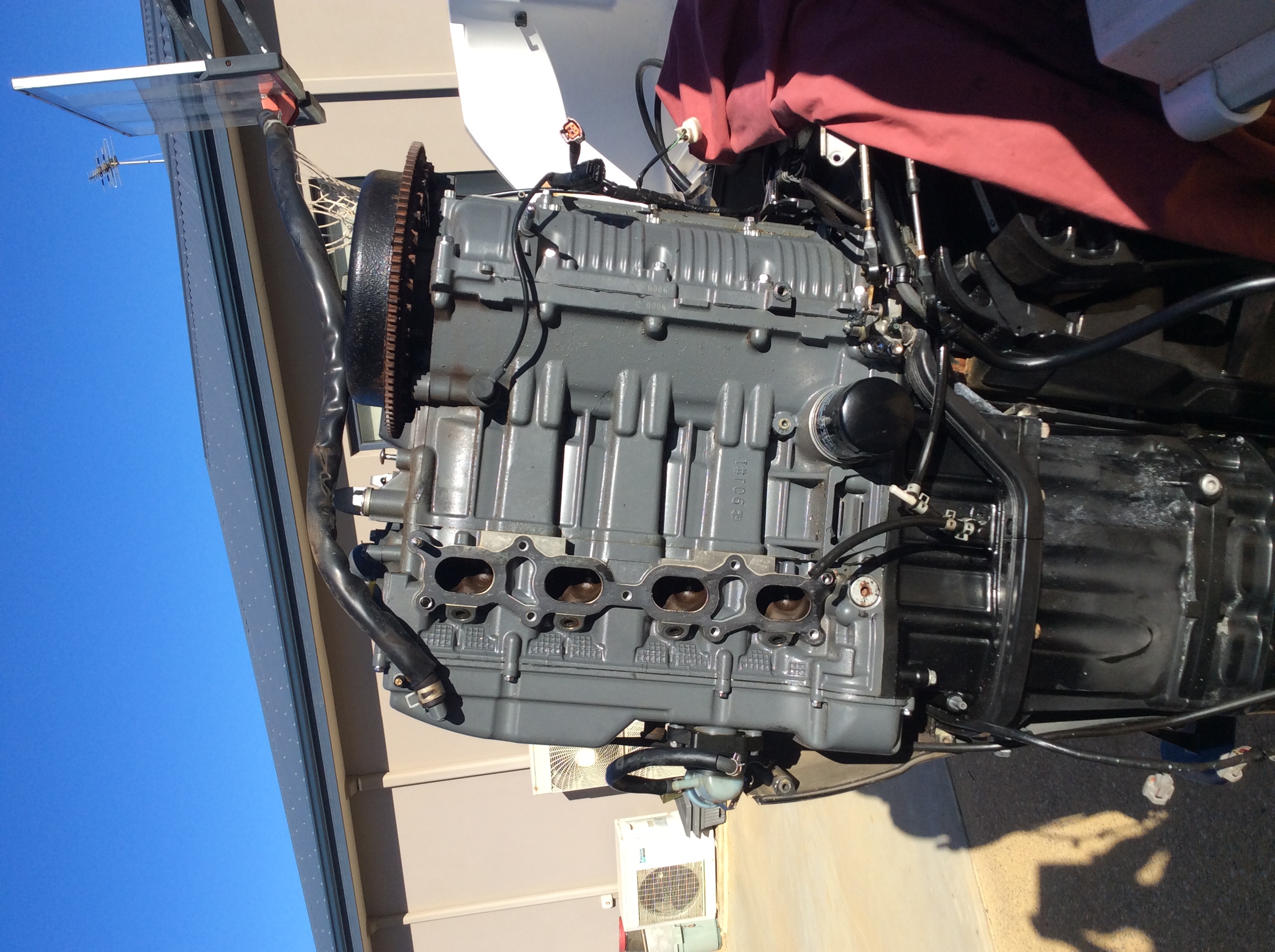

 Decided that as my Suzi’s are getting onto the dreaded 1000 hrs I’d better have a closer look at them.
Im not 100% but I thought they may have dropped 100-200rpm at full bore.
While there are a few simple reasons that this could be the case, (stretched cables, fuel filters etc) I thought it warranted a closer look at them in general.

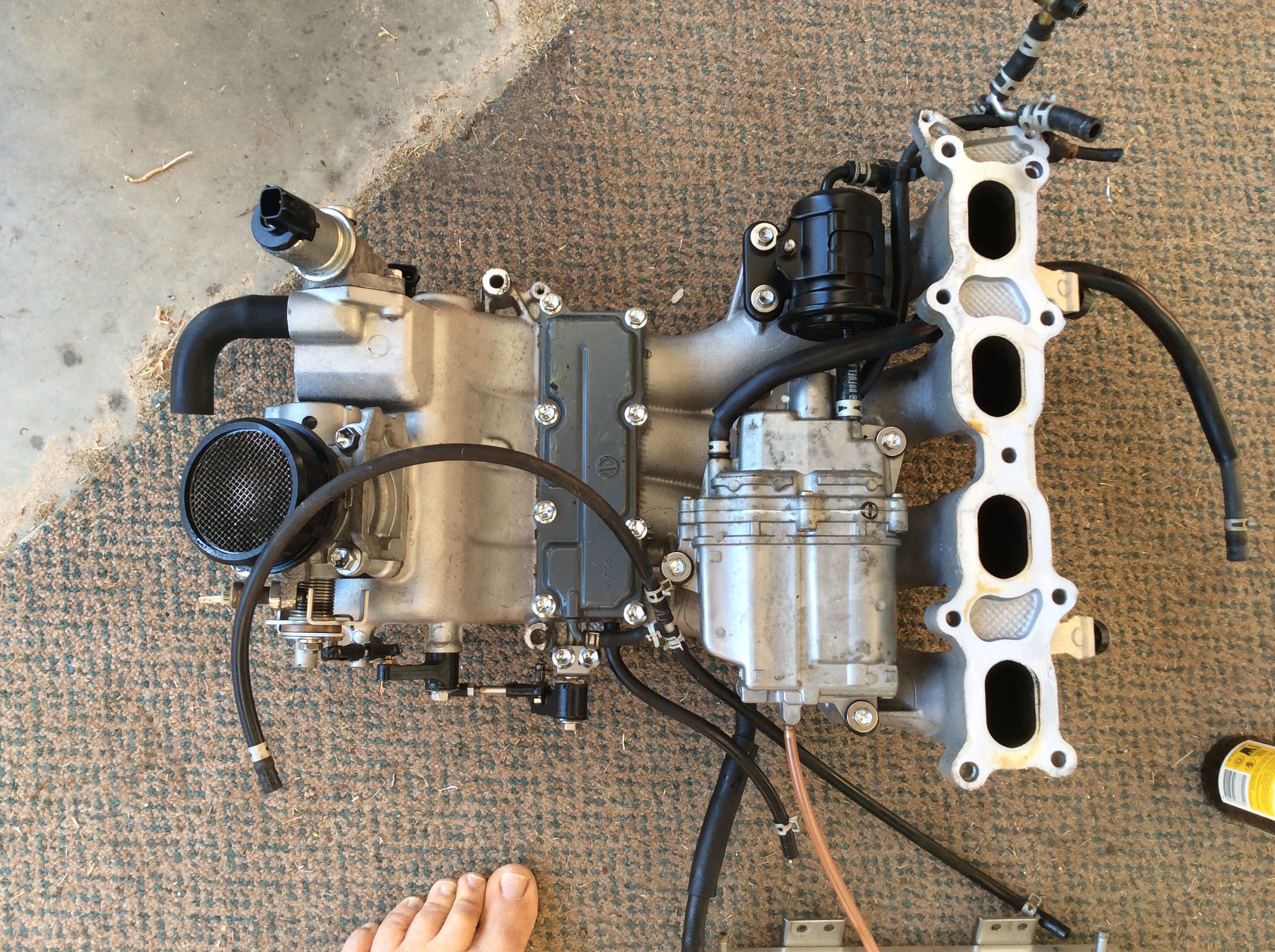

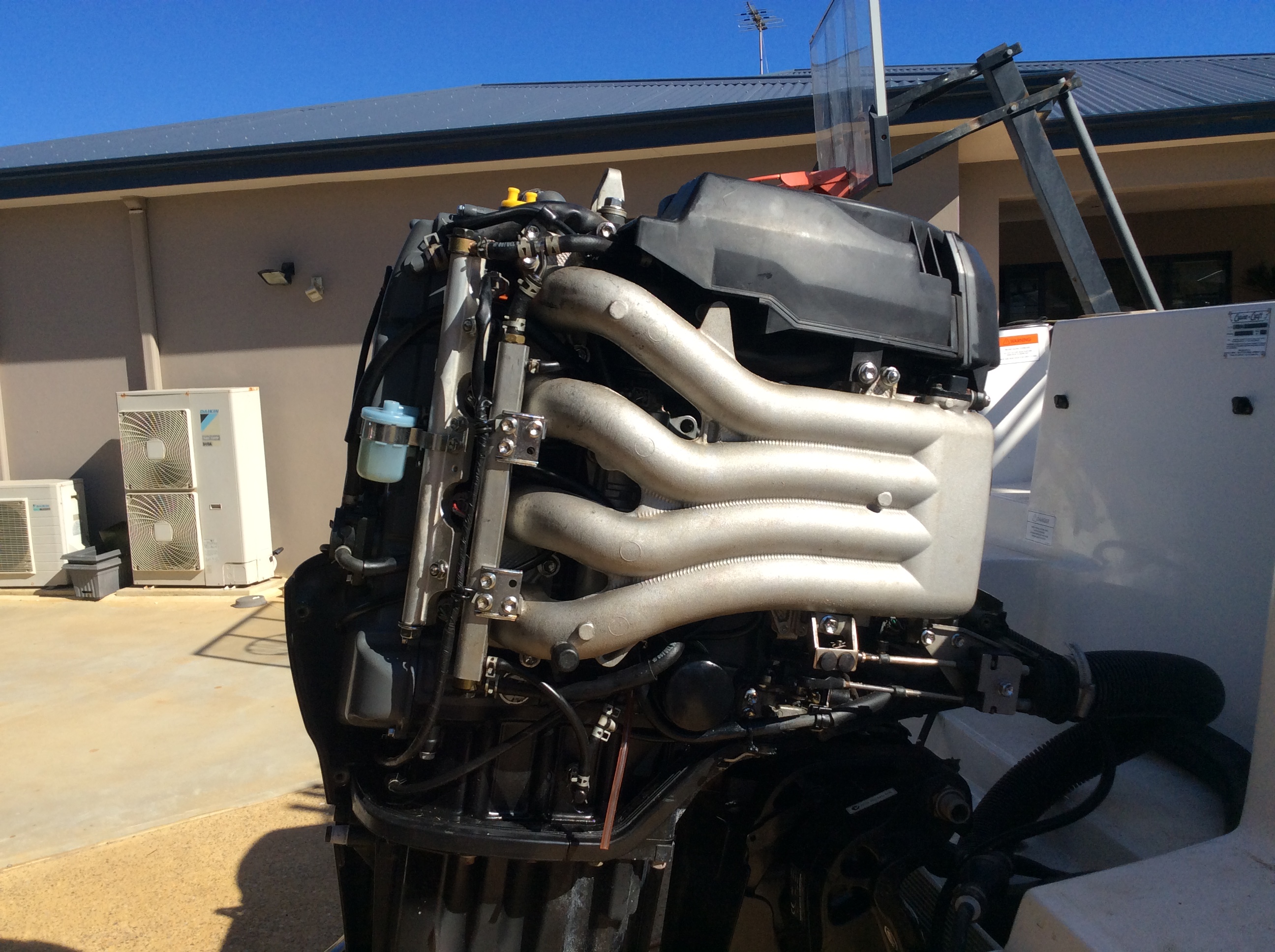

So stripped off all the intake gear, injectors, fuel pumps and Vapor separator
A days fiddling around but internally everything looked spotless, barely a light film of faint oil in the intake with zero build up (no EGR system helps),
Clayton’s clean of the injectors with carby cleaner and a 9 volt battery, no blocked nozzles
Stripped vapor seperator and pump/strainer (no varnish or clumps to be seen as others have reported)
Changed LP and HP filters
Decoked with plugs out from a spray can (not sure how effective this is but some shit came out)
Adjusted throttle cable.
All other service items done at end of last trip.
Chucked it in the water and gained about 150rpm on that outboard. (5400-5600)
Never been 100% happy with the 21” props as we run very heavily laiden, so borrowed a pair of 19” off my good friend Mr Stone  and with boat very light they got to near 6000 which I am happier with as they should be near max rpm of the range at lighter load.
