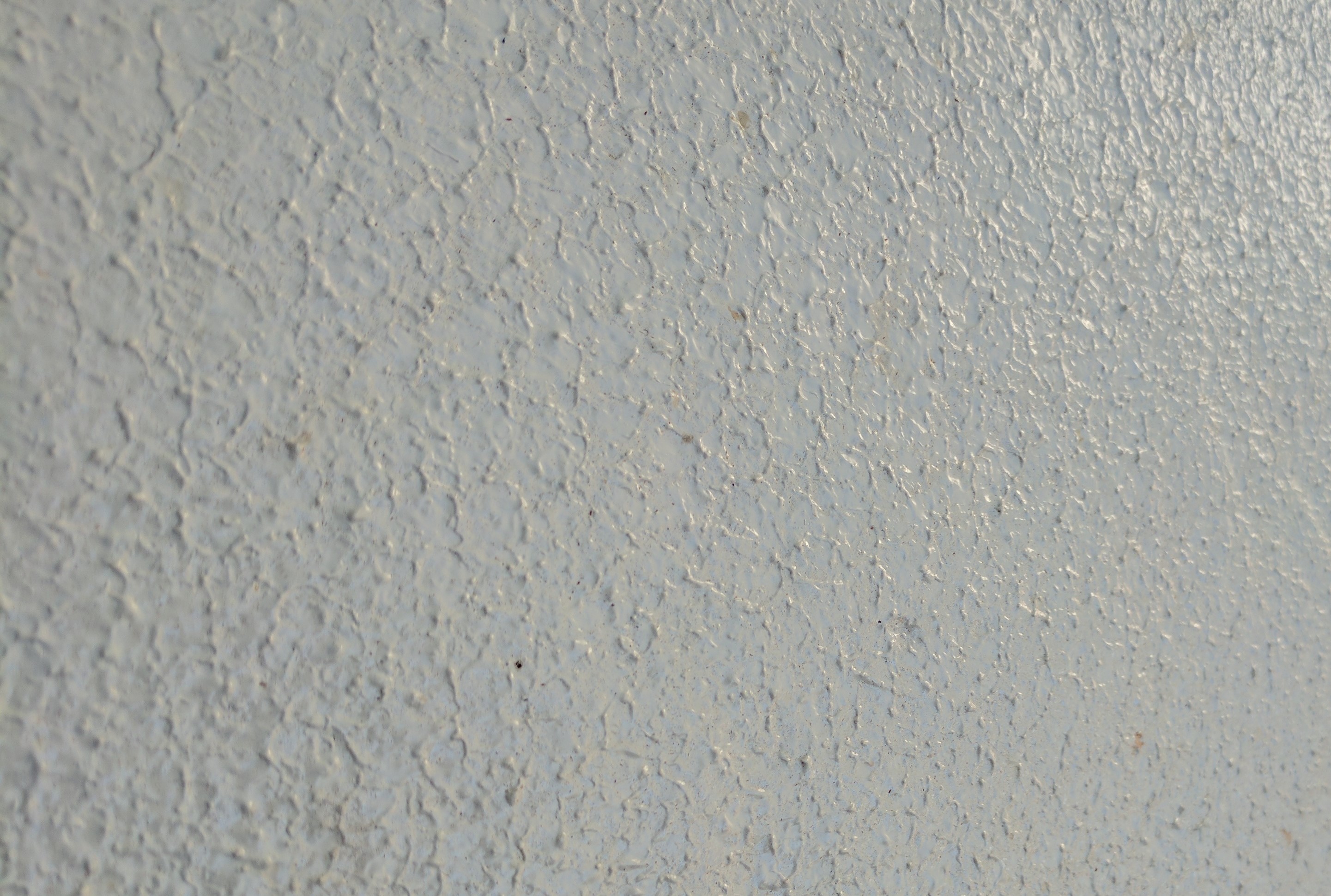

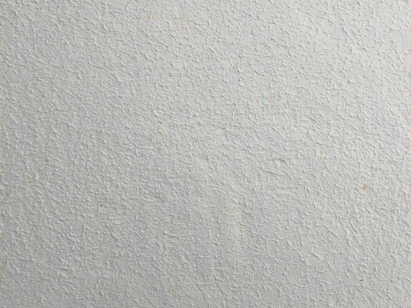

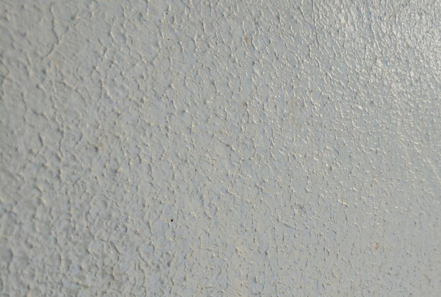

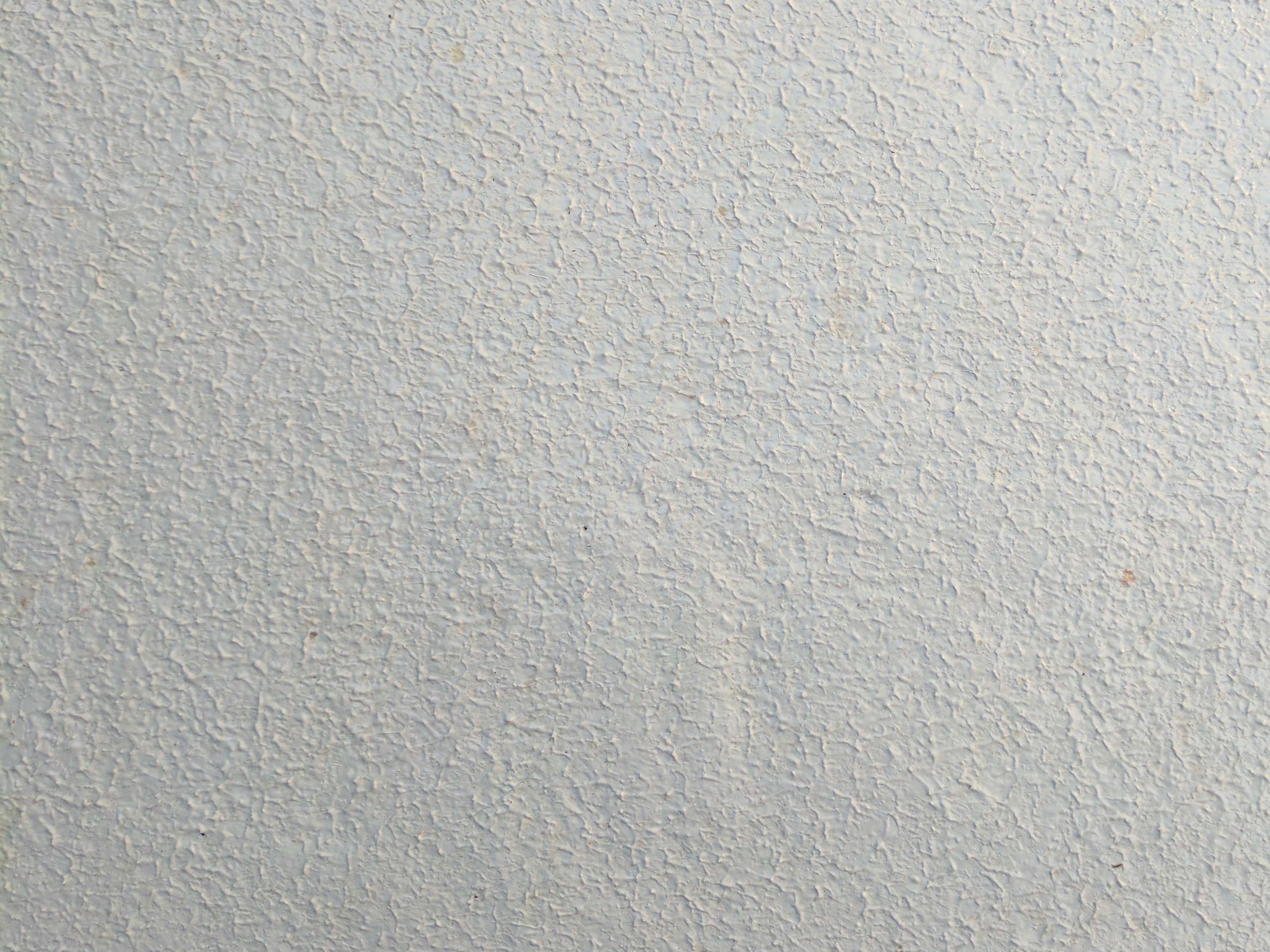

Non-skid fibreglass surface.
  Just thought i'd post this here. In a thread on another forum re non-skid deck surfaces on glass boats, someone suggested using a dry roller to lift the flowcoat as it went tacky, as an alternative to the old standbys of sand, sugar etc . I recently did a glassed timber top for my cleaning table at home, and of course fresh flowcoat is very slippery and hard to skin on. So I gave the roller idea a go, and it came up well. Certainly non-skid, no problems skinning Spaniards, and easy to clean. Worth consideration if you want to redo an old flowcoat surface as non-skid.
