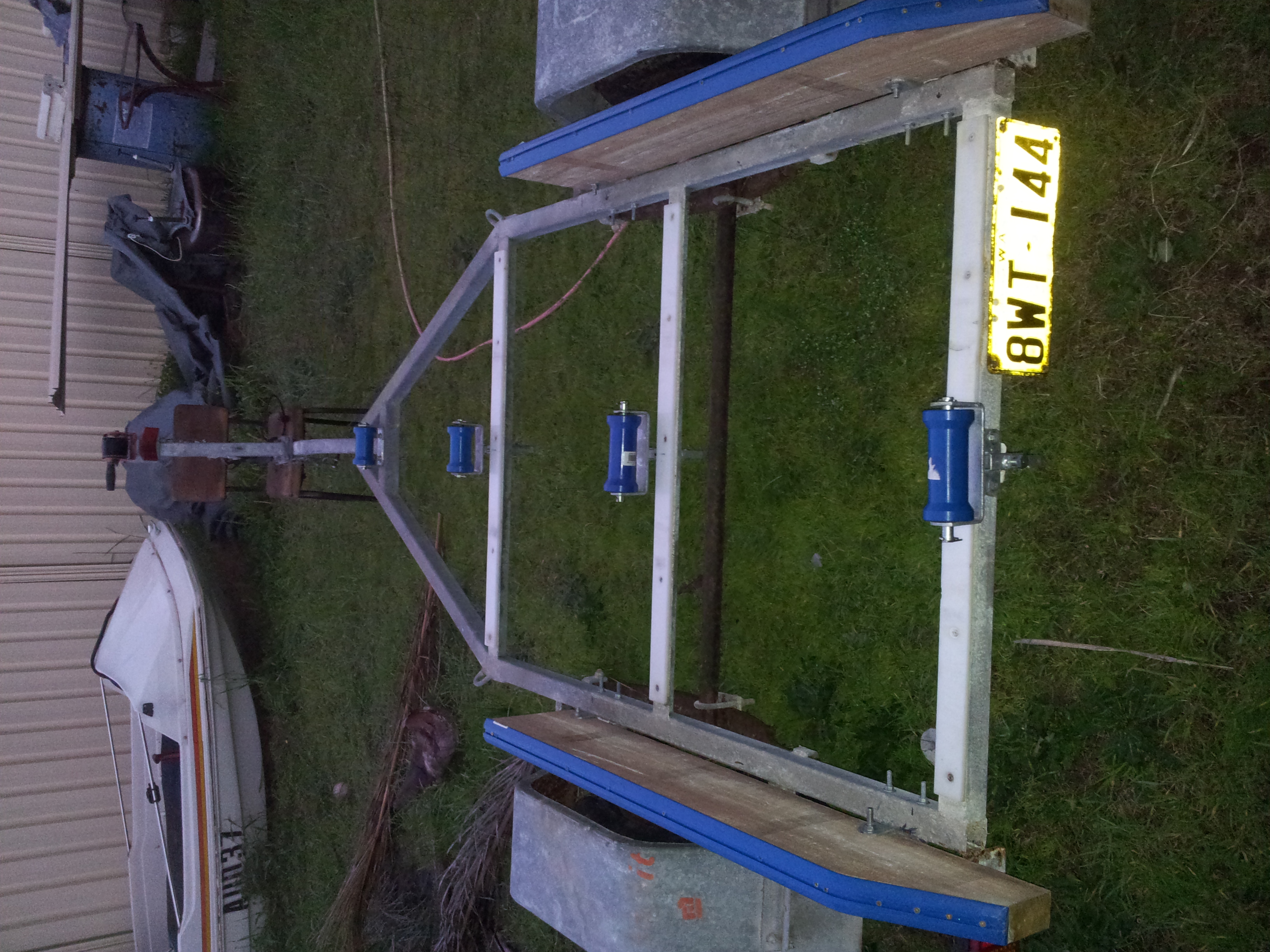

Well thought i would share some pics of my new project. Has taken 6 weekends to get it finished. motor has just been serviced and passed with flying colours. Just wanting some feedback from you guys, will be mainly used for river sessions while the bans are in effect.

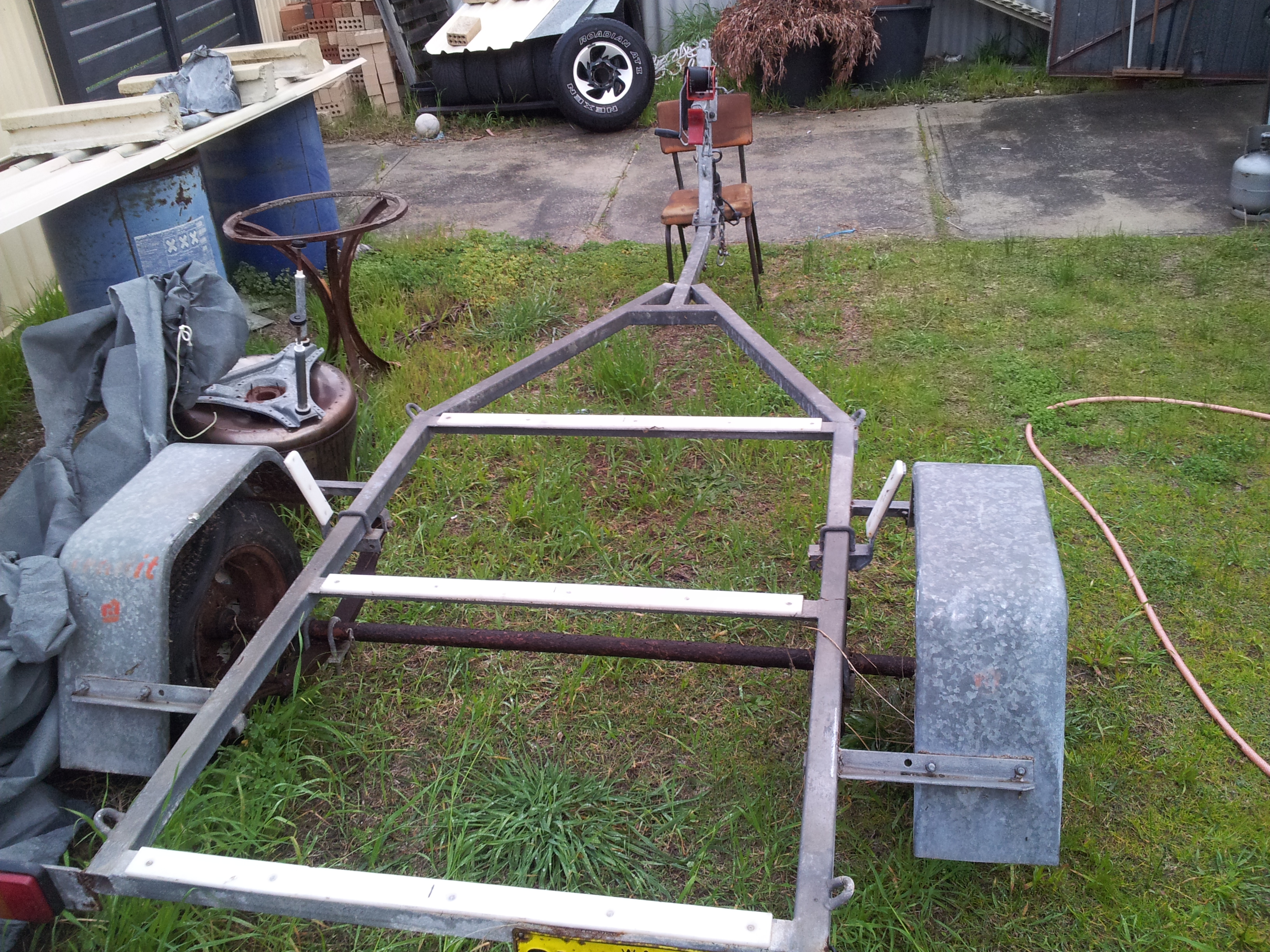

First the old trailer needed some mods.
the old Sniper colt in the background which donated the trailer, motor and controls for the new project.

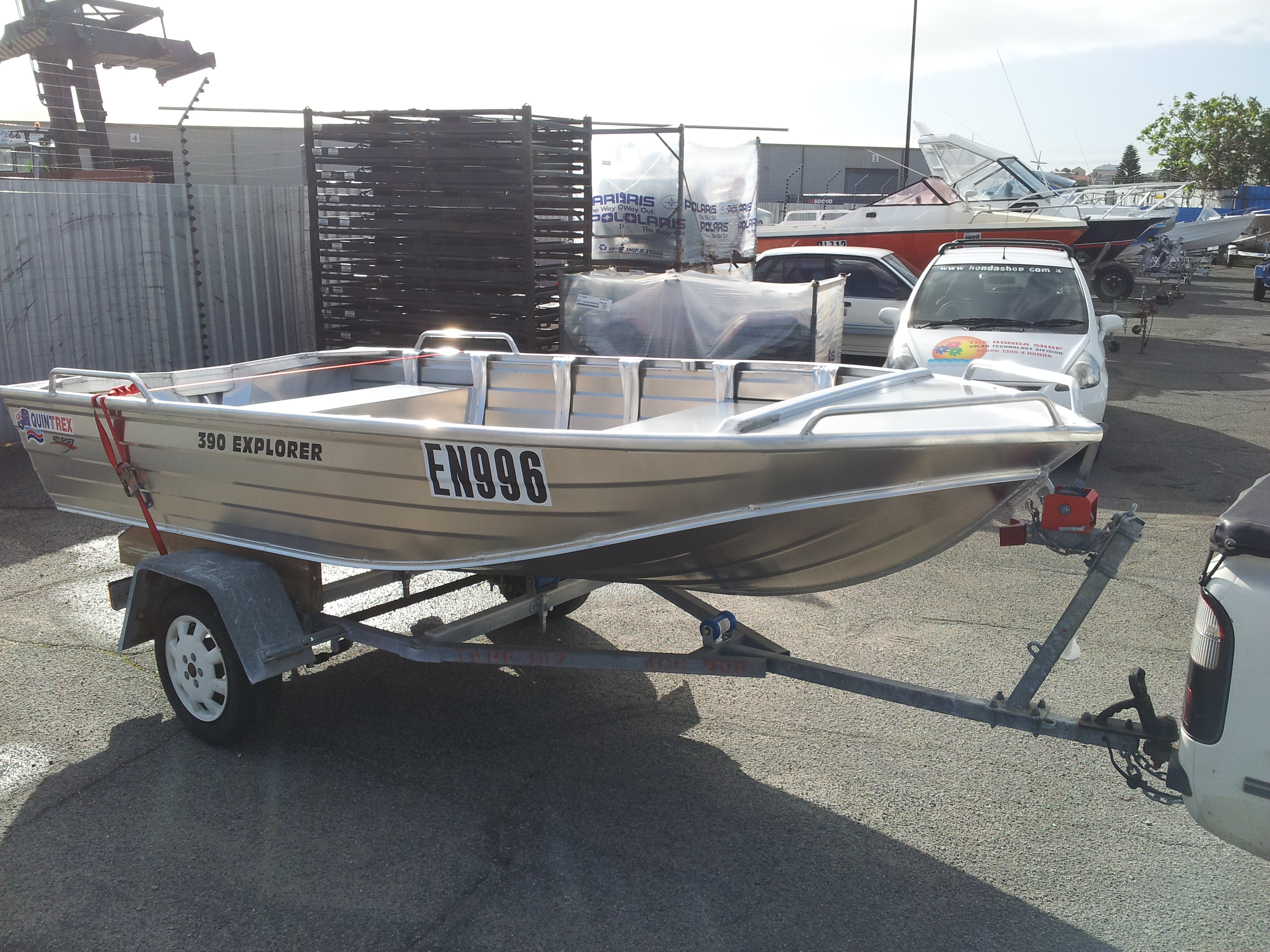

Picking up the new project, trailer needs some more mods, front roller not supporting hull etc. Minor stuff.

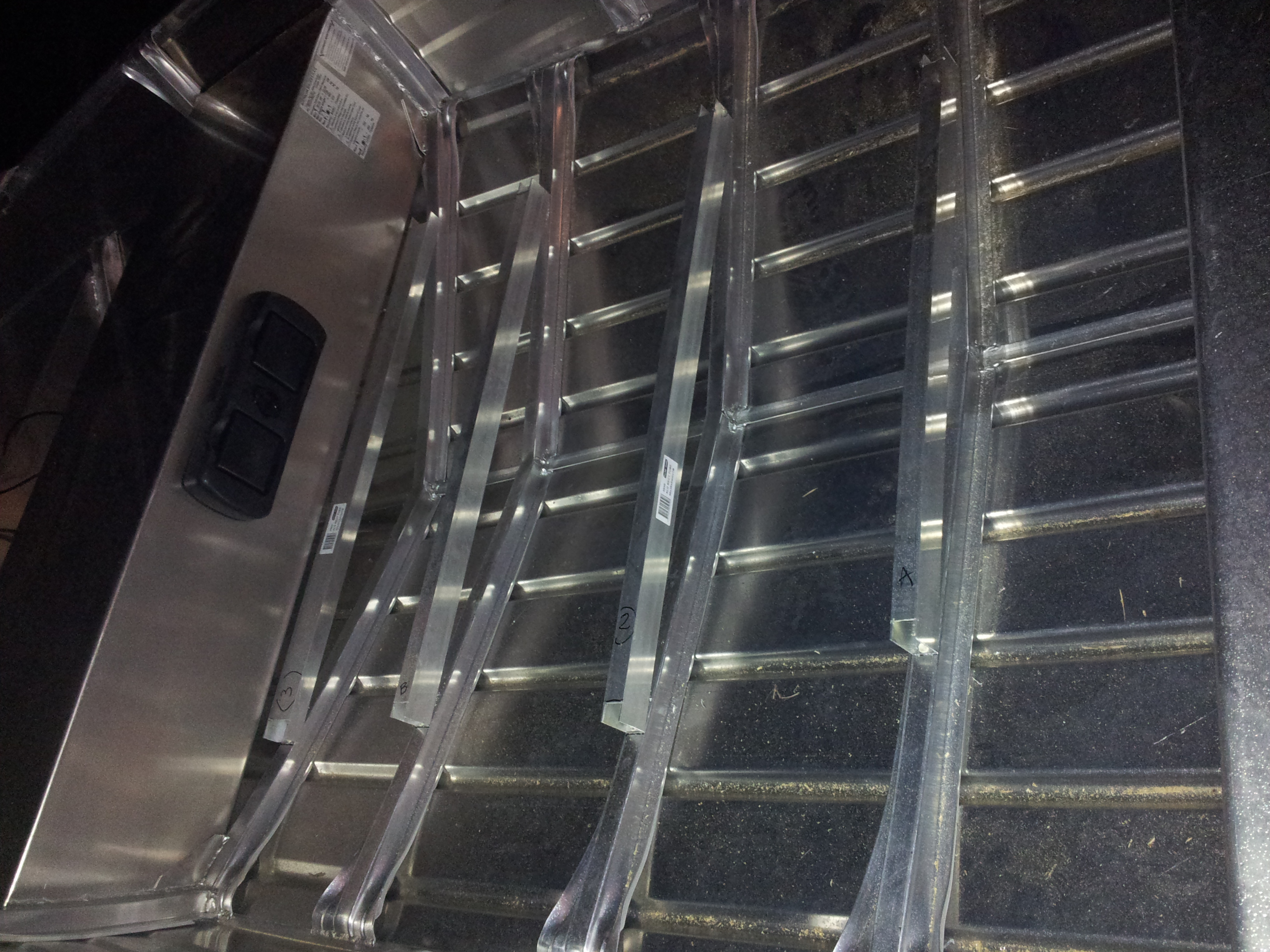

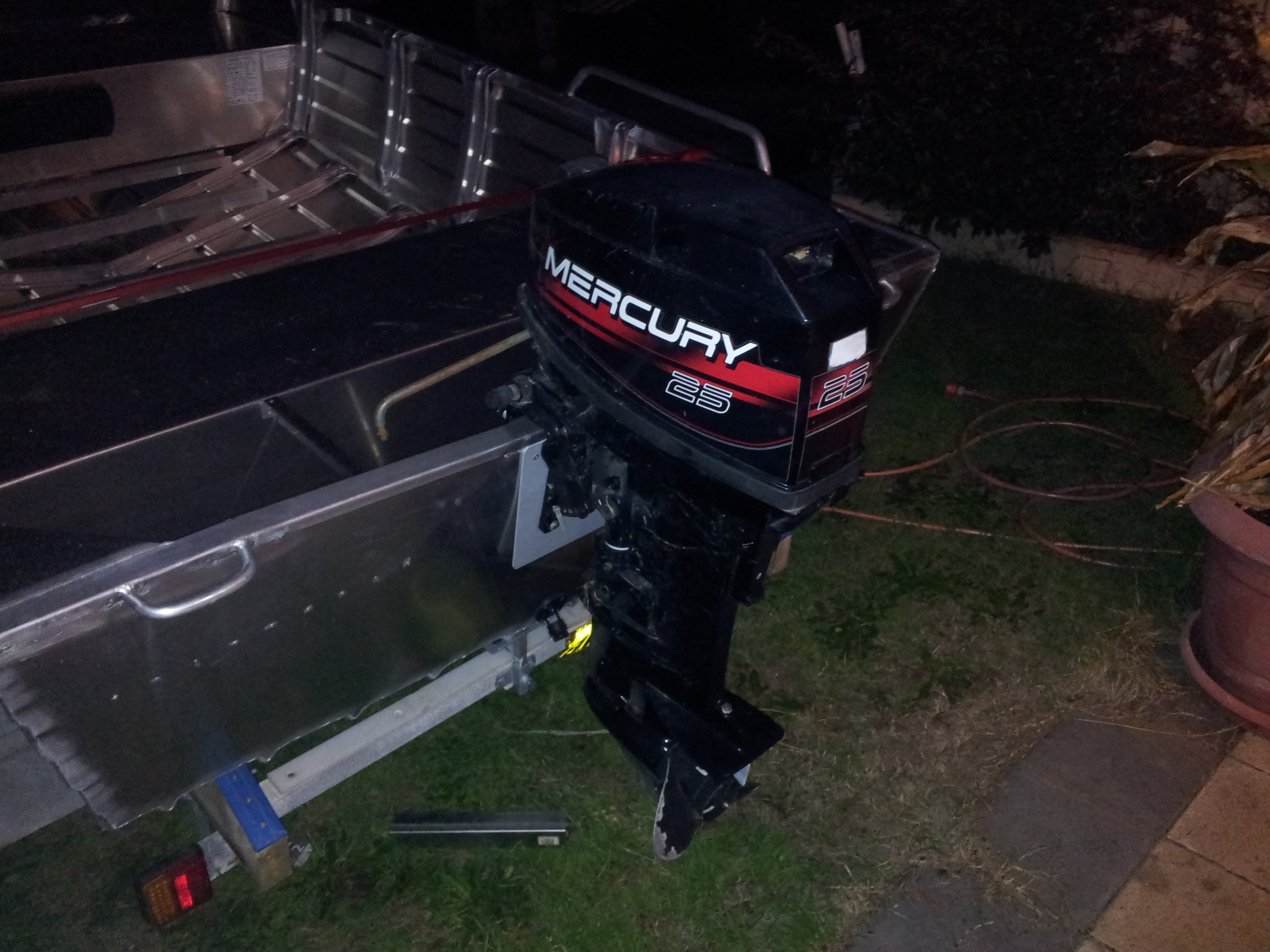

25HP 2 stroke mounted, while the boat was off the trailer, mounted the 44lb bow mount Watersnake, extended the draw bar and sorted all the rollers and skids.
Floor bracing going in for floor.

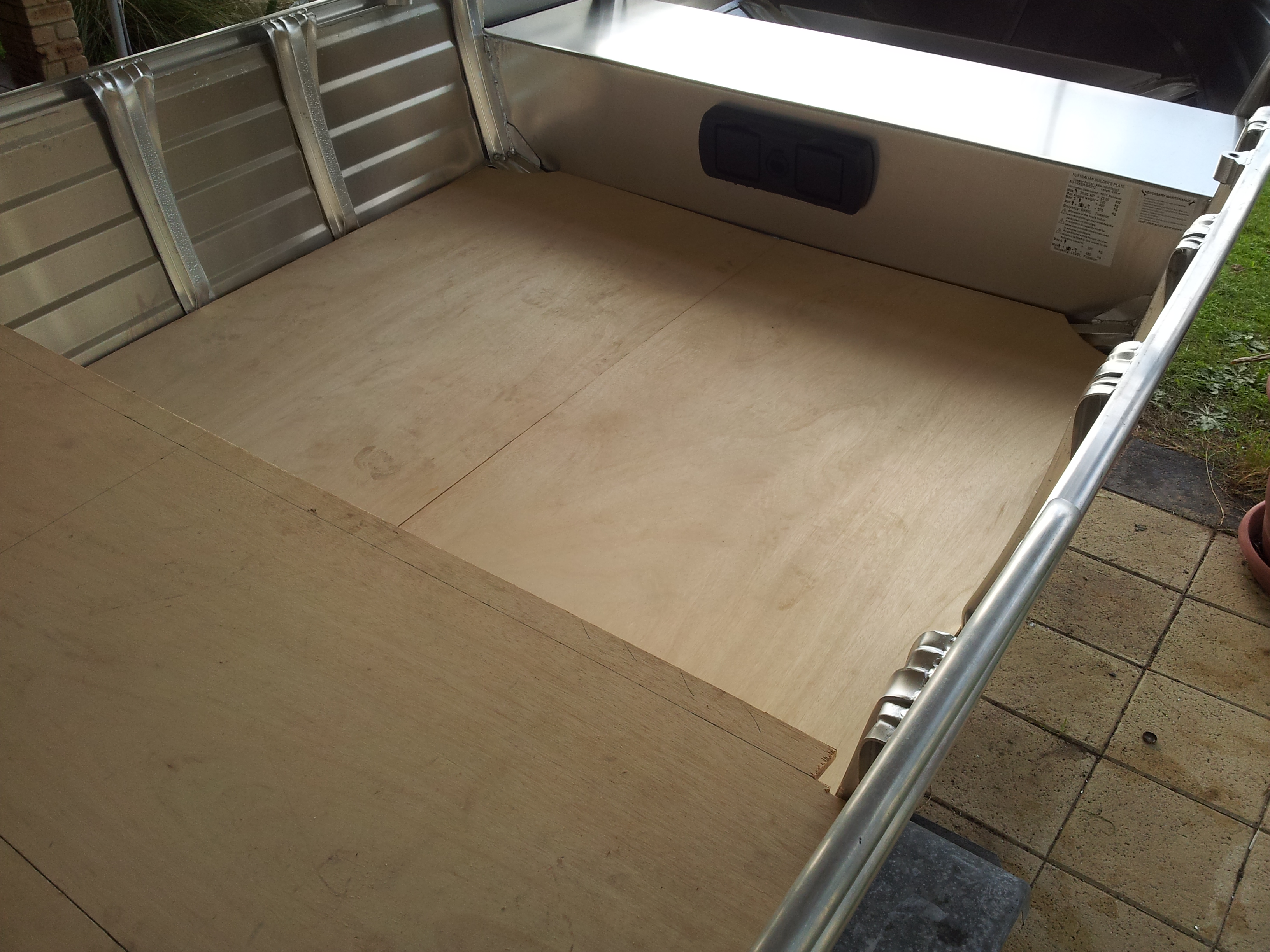

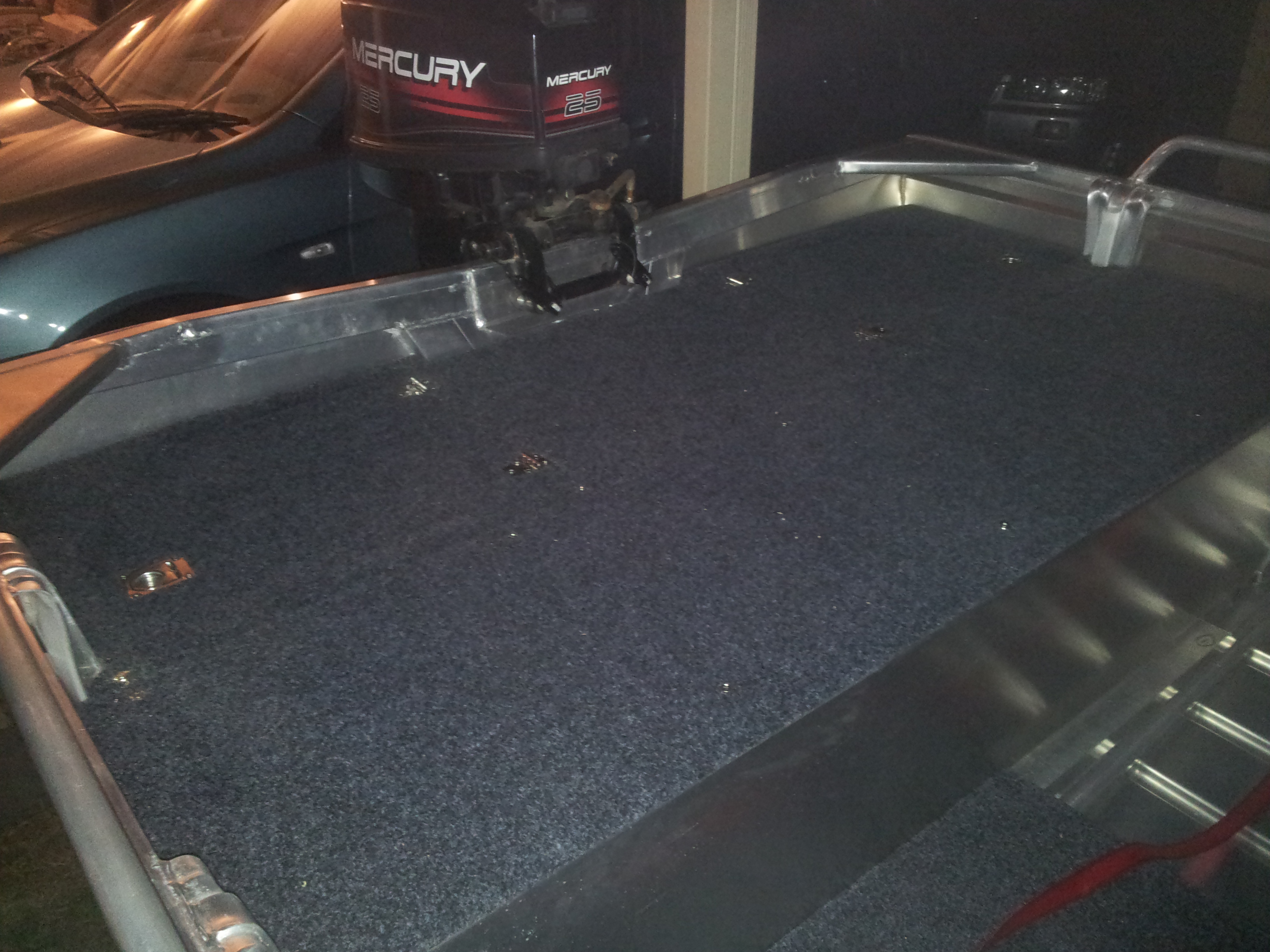

12mm marine ply measured and cut for rear casting platform and centre floor.
Rear casting platform, carpeted, hatches, hinges and handles fitted.

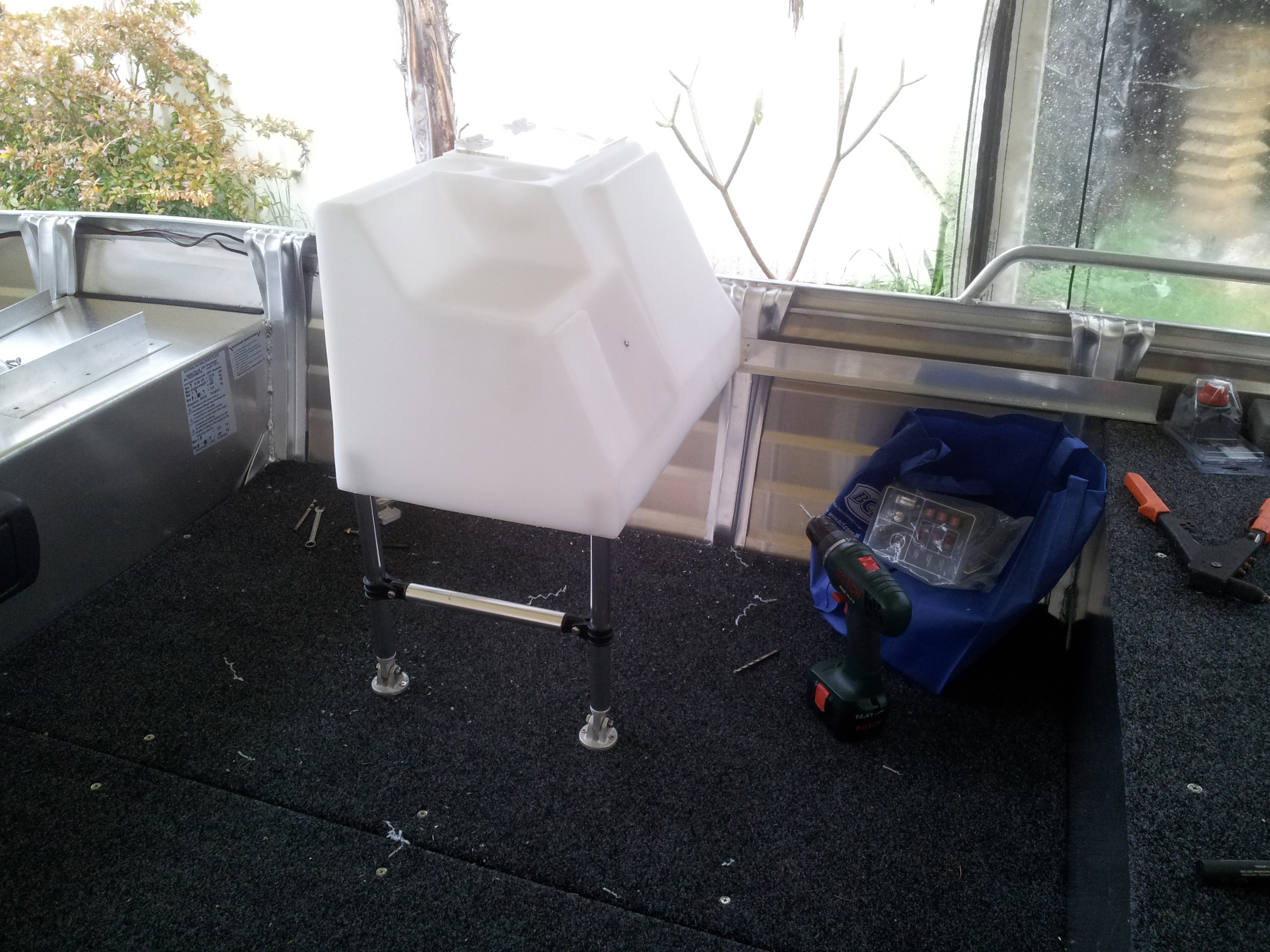

Side console mounted and fitted awaitng electrics and steering. centre floor carpeted and fitted too.

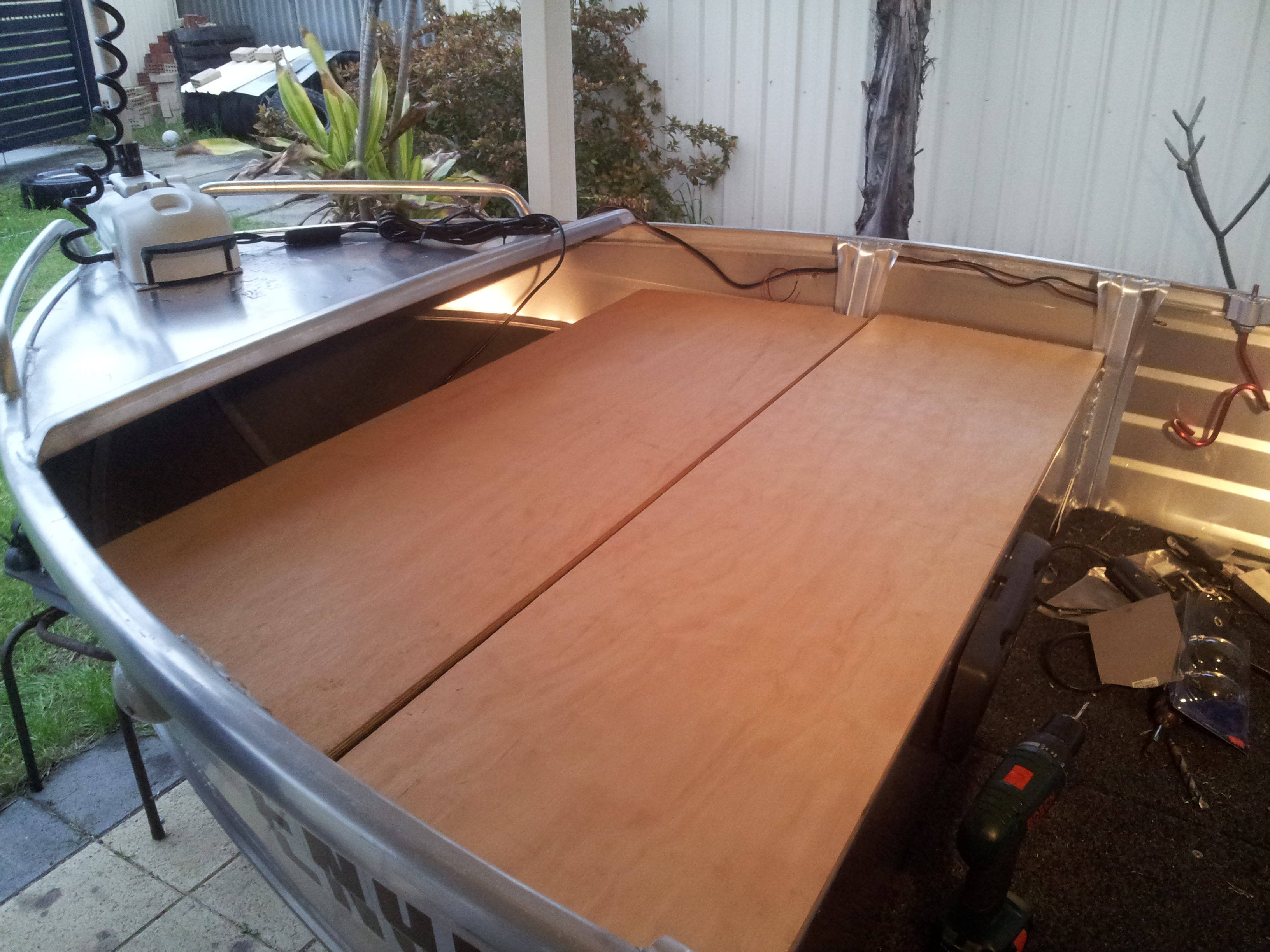

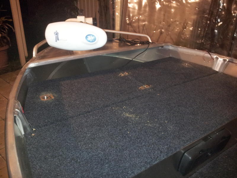

Again 12mm marine ply measured and cut for the front casting platform. You can see the bow mount mounted in place.
Carpeted, fittings fitted ready to go for the front casting platform. Plenty of storage now.

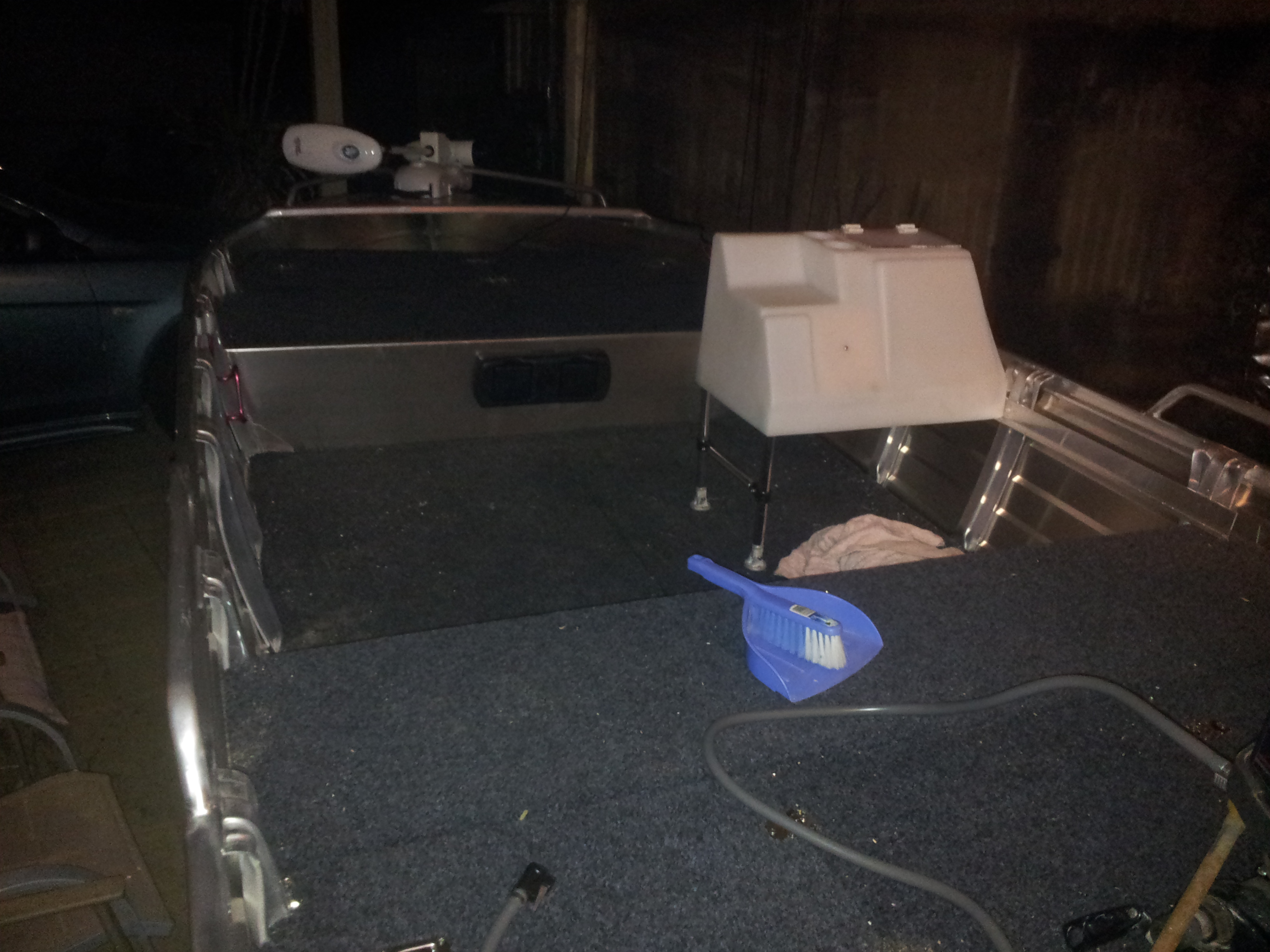

All decks/floors fitted now. now here comes the fun part, wiring etc.

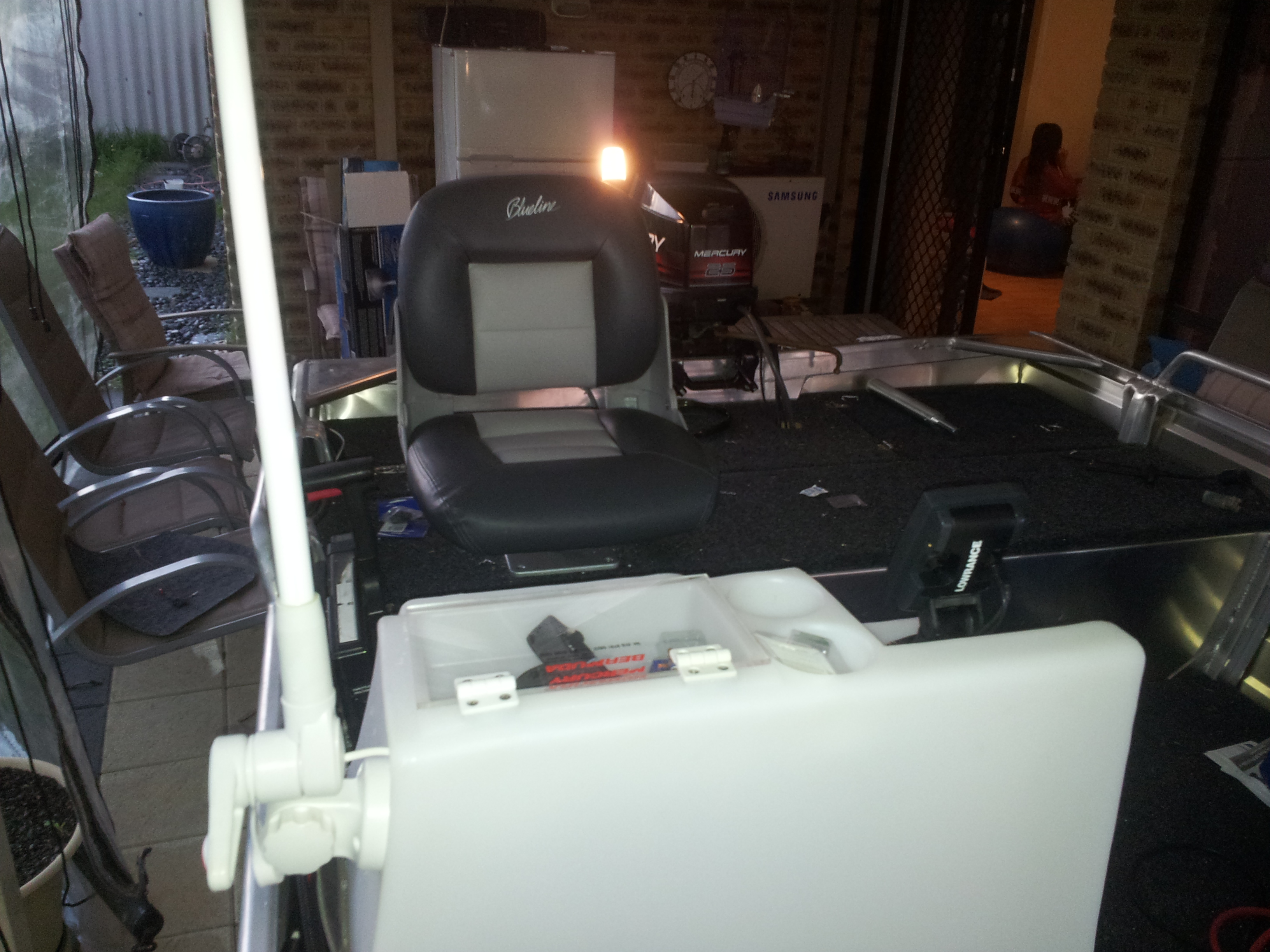

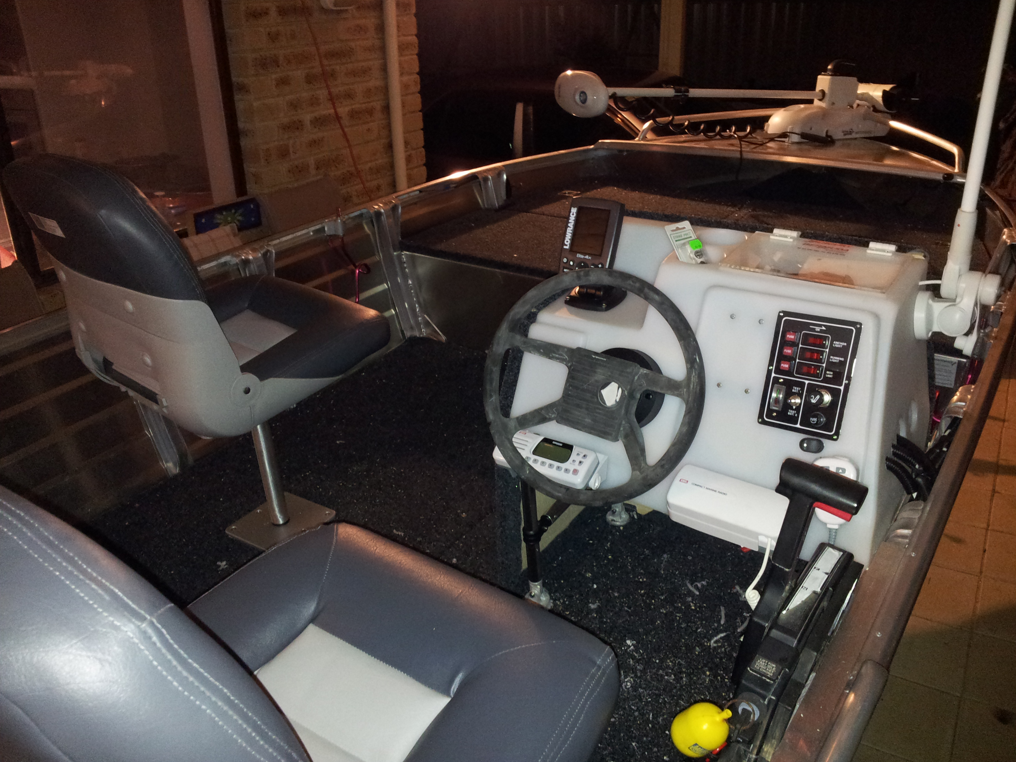

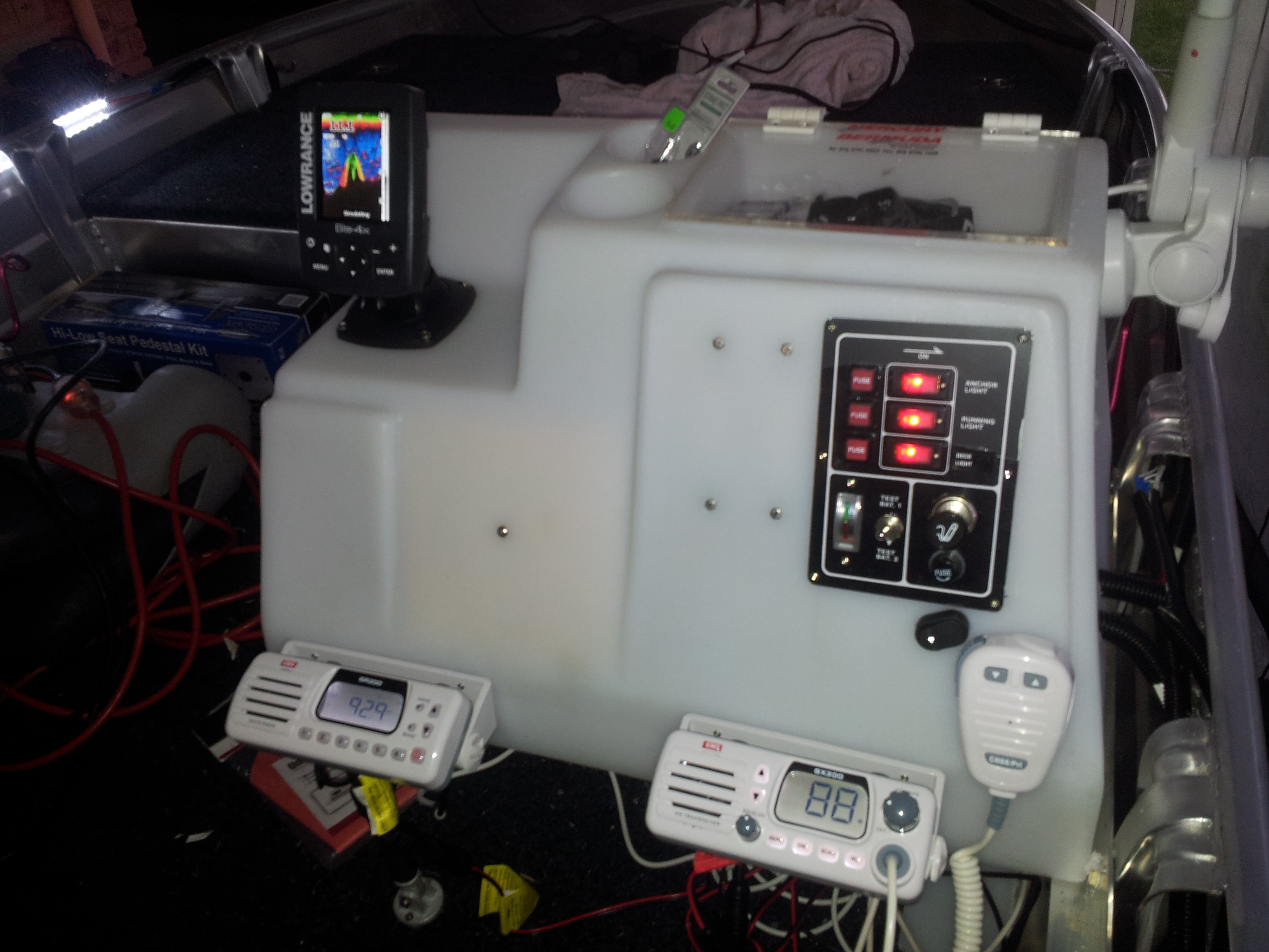

Side console getting some goodies fitted. Safety has to come first so the essentials have been fitted.

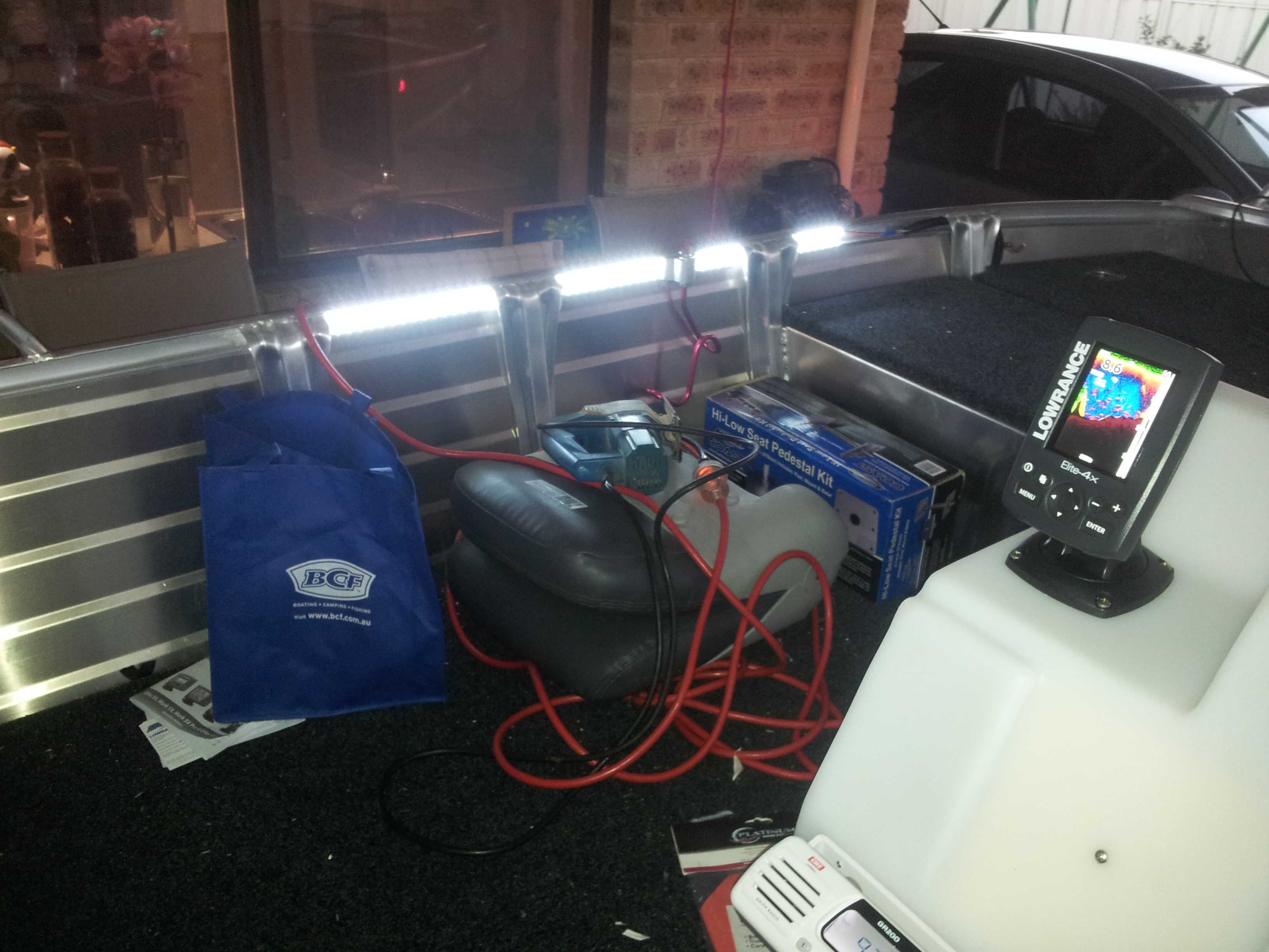

LED strip lights work a treat as deck lights, lights the whole place up.

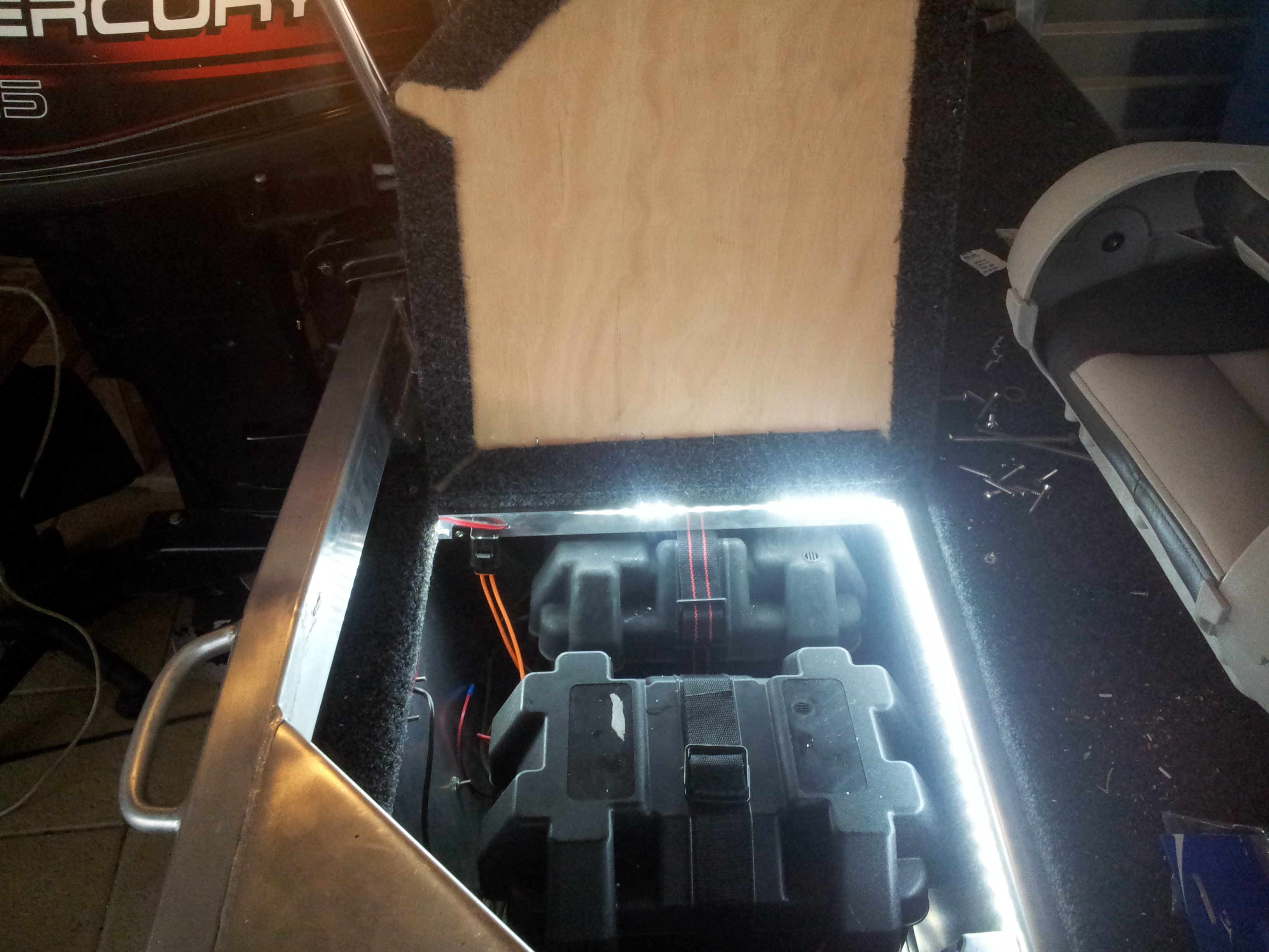

Dual batteries fitted in hatch, with LED strip lights in place for when the need arises. Petrol tank fits on the other side.
Skippers seat now fitted and quite comfy. Anchor light fitted and wired.

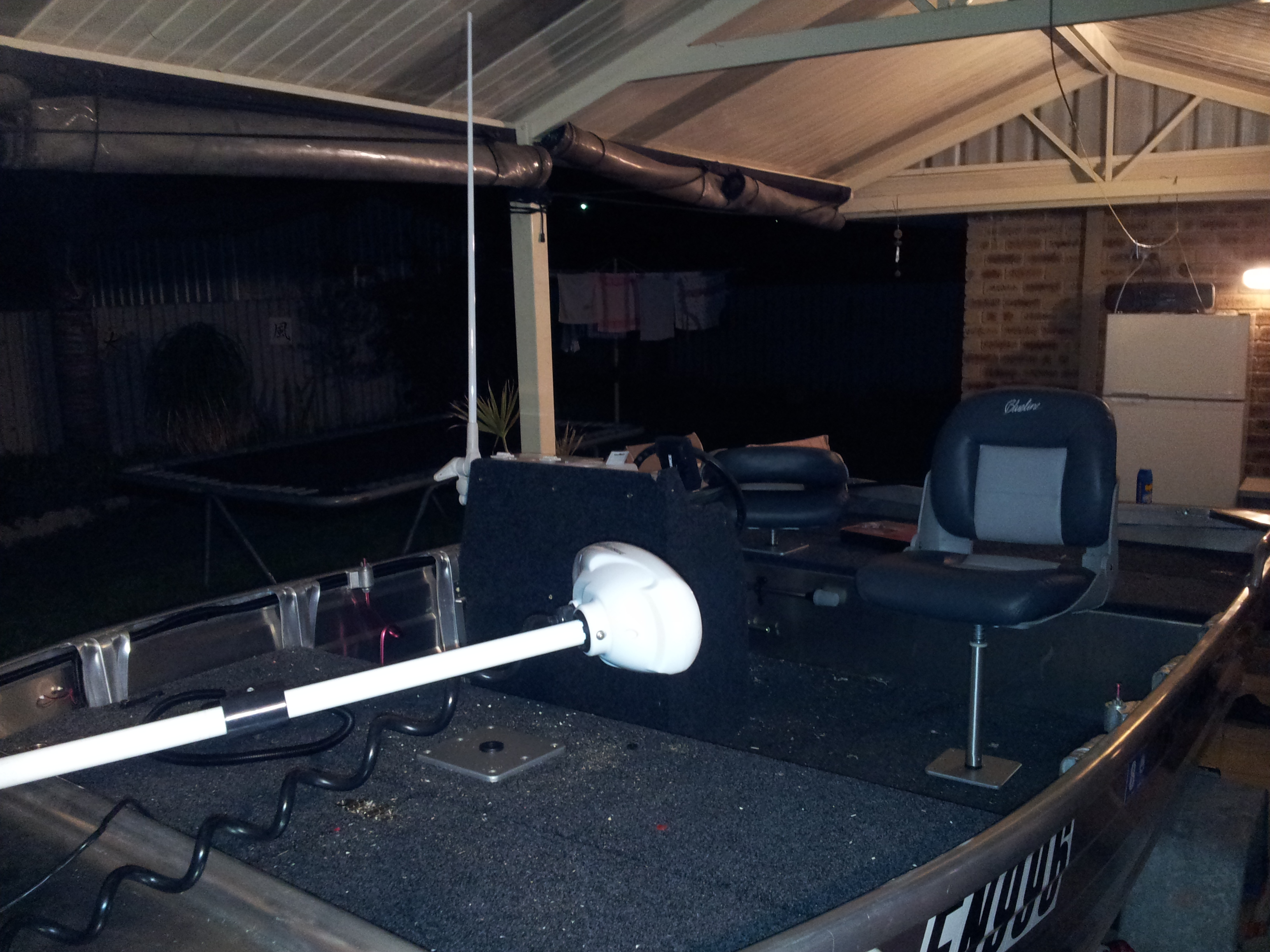

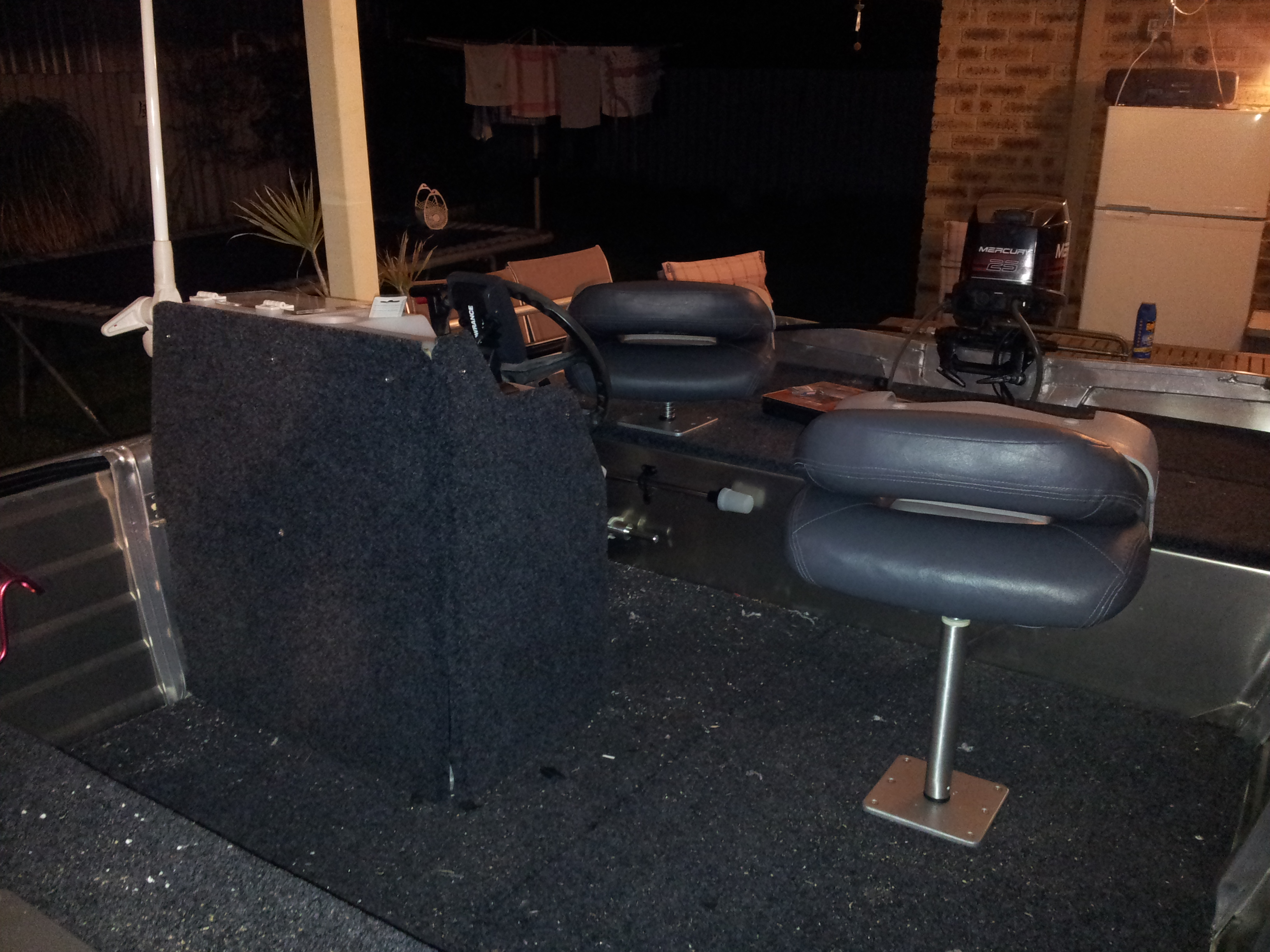

Almost there guys, passenger seating fitted and side console fitted out in 12mm marine ply and carpeted.
Front seating mount fitted so that the passenger seat can be brought forward while being able to be seated controlling the front mount and throwing lures into the tight spots.
That is pretty much it guys, apart from the clean up of the floor etc, she is all ready to rock and roll. I had to remove a few photos cause the file was a little big. Hope you guys enjoyed the photos, and for those who have a little bit of woodworking skills, electrical skill etc, it isn't that hard to do yourself, everything was done by me and the brother in law, apart from the welding, that was done by a mate. It really is worthwhile to do yourself, I have saved quite a bit of cash.

 Im, looking at doing somthing very similar with my tinny, i was wondering where you got that side consol to mount steering wheel, ect ? couldnt find any at bcf,
Cheers,
tombstone's picture
Posts: 169
Date Joined: 14/10/10
hey jengle, I actually got it
Thu, 2013-10-24 07:58
hey jengle, I actually got it from BCF, I believe it is a Bermuda/Mercury marine product, they may have some around the country or you can go direct through the company and find out where you can get them from.
