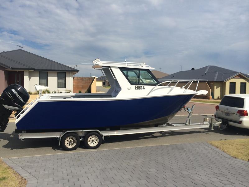

new aliminium boat trailer build
hi gents i thought i would post a few photos of my aluminium boat trailer build its really easy and you can build a 3000kg to 3500kg for under 6k i havnt had a chance to get it licenced yet but will go over easey only thing i need to do it move the winch post back about a foot

Looks good mate ! How many
Thu, 2014-08-28 18:48
Looks good mate !
How many hours to put it together ?
6k finished incl electrics and brakes and stuff?
What boat is that ?
Cheers,
Vinnie

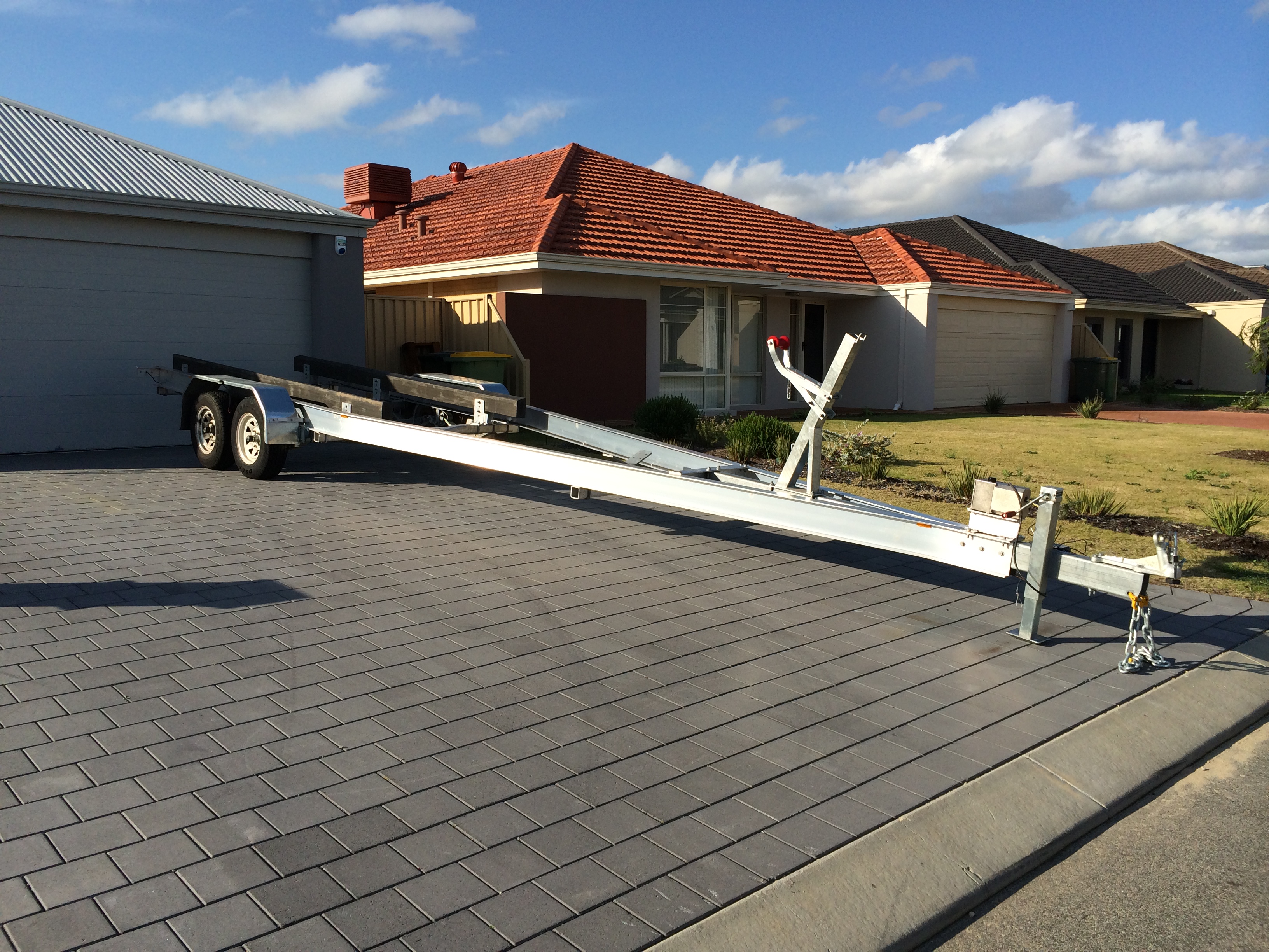

how do you work out the
Thu, 2014-08-28 18:57
how do you work out the positioning of axles?, was it all bolt up any welding required? looks bloody big nice work
skipjack's picture
Posts: 49
Date Joined: 10/11/12
the frame is all bolt
Thu, 2014-08-28 19:46
the frame is all bolt together and i new were i wanted the axels but you can just U bolt them on and try it out
skipjack's picture
Posts: 49
took a few days about 15 to
Thu, 2014-08-28 19:00
took a few days about 15 to 20 hours and yeh with the brakes aswell for under 6k and is a oceanic fab 7.5

Looks great did you get the alloy I beam bent in perth as I am interested in building the same thing.
skipjack's picture
Posts: 49
yeh mate brought the beams
Thu, 2014-08-28 19:35
yeh mate brought the beams from capral aluminium and got them rolled at wenco there is a few other places that can roll it as well

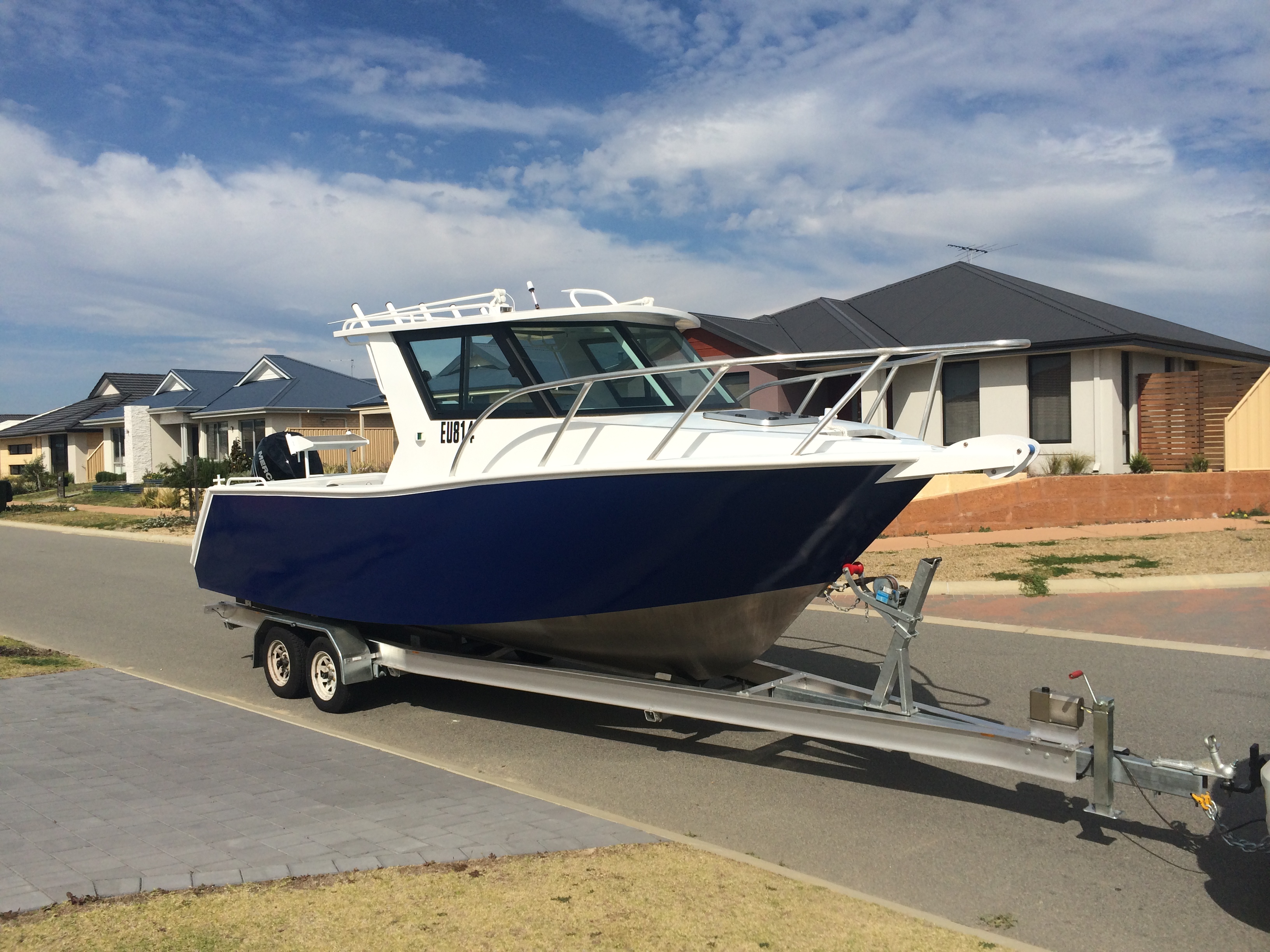

finally got around to getting
Tue, 2014-10-28 08:46
finally got around to getting it licenced for 3250kg the tyres were holing it back from 3500kg but I think 3250 will be plenty

Congratulations looks like a
Tue, 2014-10-28 10:01
Congratulations looks like a great result. Why bolt on the mild steel RHS with everything being aluminium or was it because you couldn't get that type of section in aluminium?
Posts: 15247
 Pretty sure the reason was
Tue, 2014-10-28 14:14
 Pretty sure the reason was ease of construction, no welding. I doubt you'd retain member strength if you 'bumped' ali like that. For question on galvanic corrosion I reckon you'll still get corrosion even if you bolted ali pieces together anyway. I think he'll get plenty of life out of it. I'd just be spraying all the joints with lanolin or lithium to proof them a bit. It's all about maintenance at the end of the day.
Posts: 185
Date Joined: 01/10/14
Just to take it one step
Tue, 2014-10-28 13:56
Just to take it one step further on my previous comment. I look at the trailer and see what I presume are galvanised u bolts and galvanised connecting bolts and then the mild steel runner rails. What thought has been given to galvanic corrosion?
skipjack's picture
Posts: 49
to go stainless bolts I would
Tue, 2014-10-28 17:09
to go stainless bolts I would still be paying for them now and what do you mean runner rails? the only steel parts are the winch post and draw bar and they are galvanized
bradz's picture
Posts: 693
Date Joined: 29/10/07
Galvanic Corrosion
Tue, 2014-10-28 15:01
Isnt that only really a problem while the trailer is in the water? Electrolisis?
Provided the trailer is washed down I wouldnt see that as a problem, but I could be wrong.
I did then the best that I knew how. When I knew better, I did better.
Posts: 182
Date Joined: 23/09/14
 Bradz galvanic corrosion is
Wed, 2014-10-29 15:19
 Bradz galvanic corrosion is the result of 2 dis similar materials coming into or being in contact with eachother.
This being said the paint will act as barrier for the time being slowing down the process if it was to happen.
Mitch
Posts: 5905
 still needs an electrolyte
Wed, 2014-10-29 16:48
 still needs an electrolyte to take off.
Otherwise your car engine which has steel, aluminium, cast iron, copper, bronze, white metal etc all bolted together would cease to exist fairly quickly

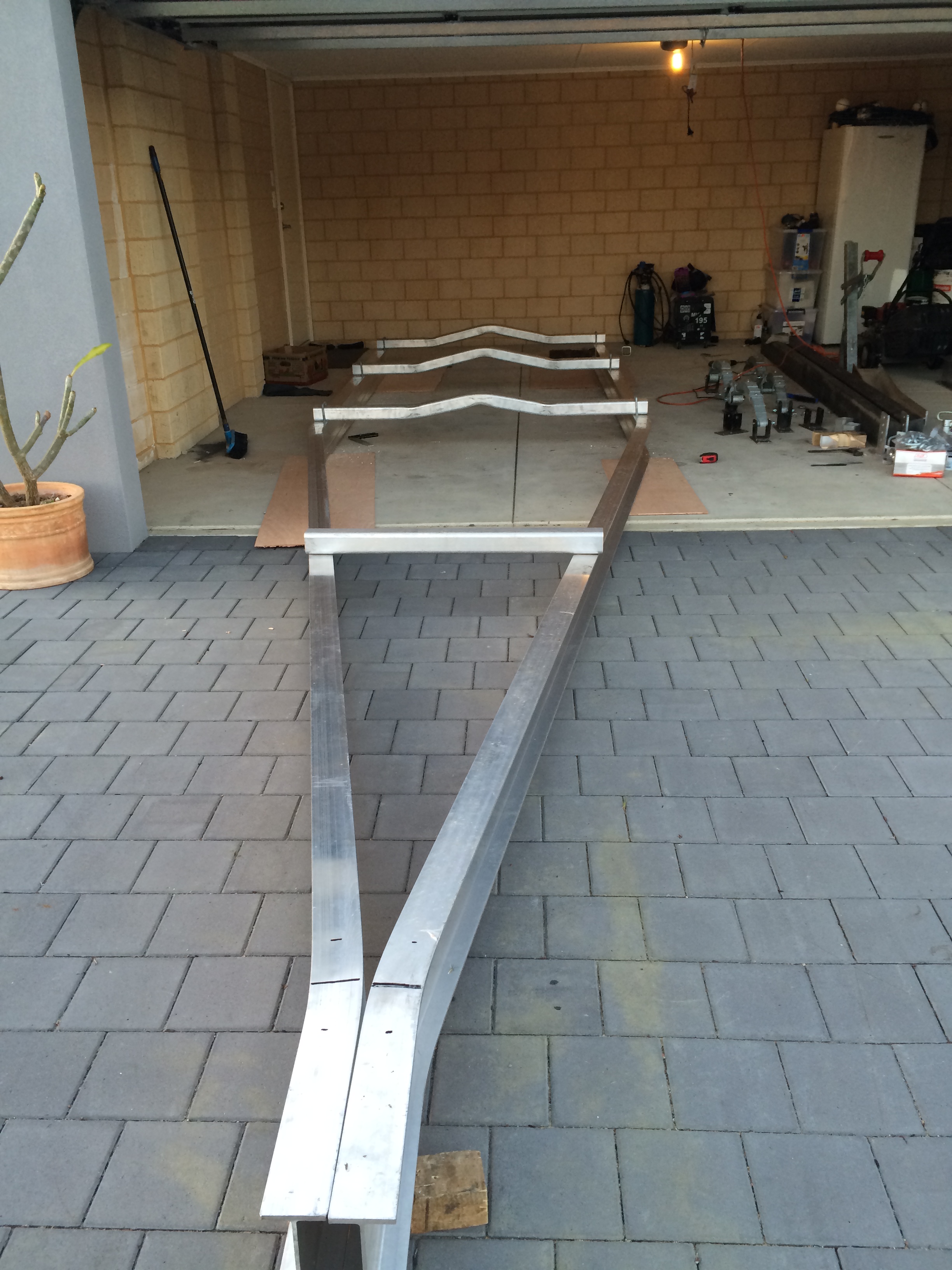

What size aluminium i beams
Thu, 2014-11-06 12:22
What size aluminium i beams did you use?
skipjack's picture
Posts: 49
beams are 178x80X8mm cross
Fri, 2014-11-07 11:13
beams are 178x80X8mm cross members are 76x76x6mm

Looks good - one thing I'd be
Fri, 2014-11-07 11:20
Looks good - one thing I'd be doing though is taking that safety chain down to the trailer beam just in front (or behind I should say) of the winch post rather than the winch post itself.
