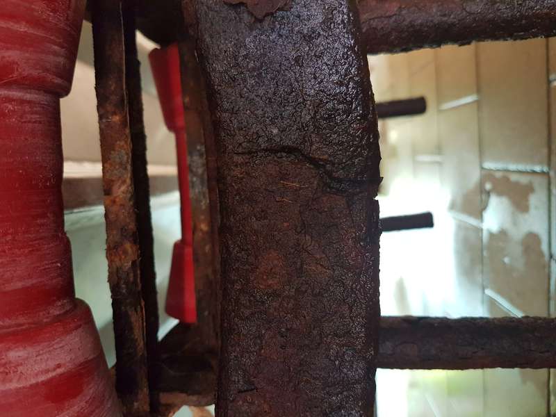

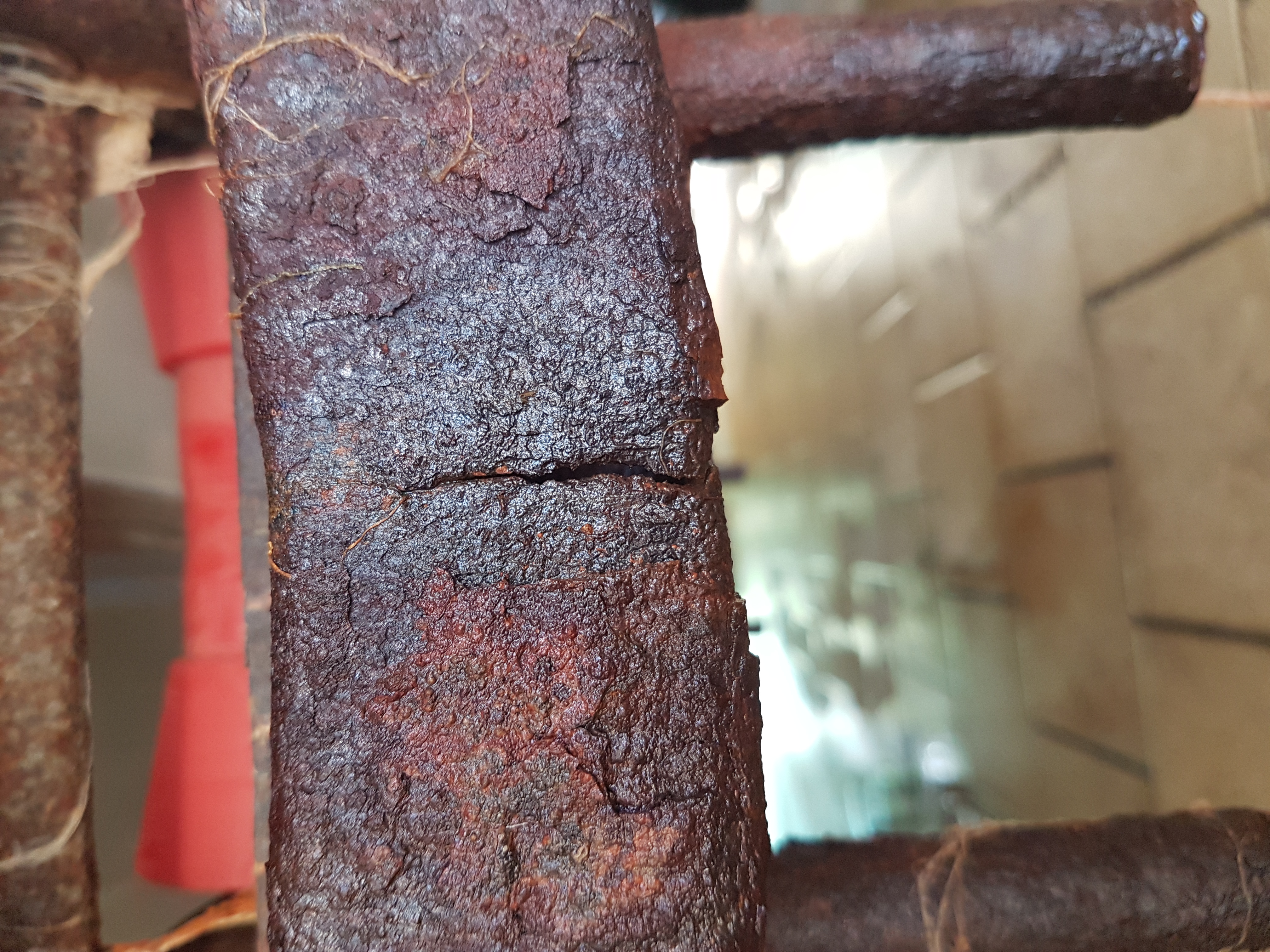

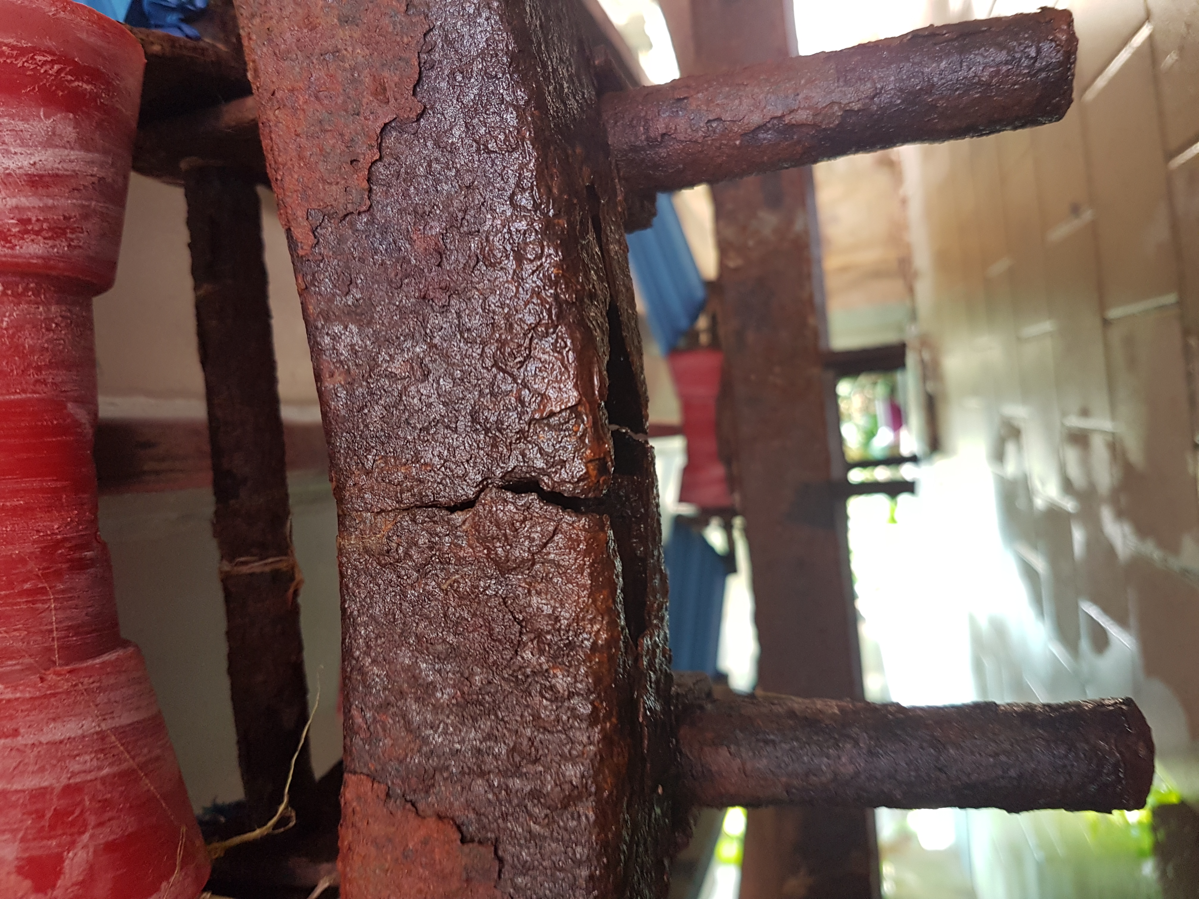

 Hi lads I went out today in the boat and after hitching the boat up and towing it home iv realized something wasn't right had a look at the trailer and the 3 cross bars have cracked( as in the photos below) is it just worth getting a new trailer as a few other things are buggered on it too or should I get it fixed the boat sitting on it is a quintrex 5.7 bow rider any suggestion would be appreciated new ,second hand ,good trailer brands ,fixing solutions etc cheers guys and more annoying is I had my jurien bay boat trip lined upfor the 4th of January

That trailer is toast

 I can definitely see why that cracked. You'd be able to buy a replacement new before the 4th if you have funds and are happy with a dunbier etc. If going custom I'd recommend talking to tezzas in port Kennedy

 Probably lucky that happened
Sat, 2018-12-29 15:01
 Probably lucky that happened when it did and not doing 100kph along Indian Ocean Drive. Looks like a newby is on its way as that one is a throw away.

 Those crossmembers rust thru
Sat, 2018-12-29 17:04
 Those crossmembers rust thru as the seawater probably has been sitting in there.
Usually there is a drain hole at the low point, may have been blocked?

 i def wouldnt trust the
Sat, 2018-12-29 17:54
 i def wouldnt trust the trailor with the cross members like that. i would def be getting a new one or good second hand  especially if your planning a trip away

 Thanks for all your feedback guys after 5 days of stressing on what to do I was given the bad news today from 3 different mobs that the trailer was going to cost nearly as much for a new one than to fix all the issues
So iv ended up going with a new one from Chivas that they luckily had in stock I would have liked to have gone and see tezzas stuff but I barely got the boat to Chivas a 10 minute drive became an hour as the cross bars opened another 10mm on the way there and Im watching the boat sink into the trailer scary to say the least.
