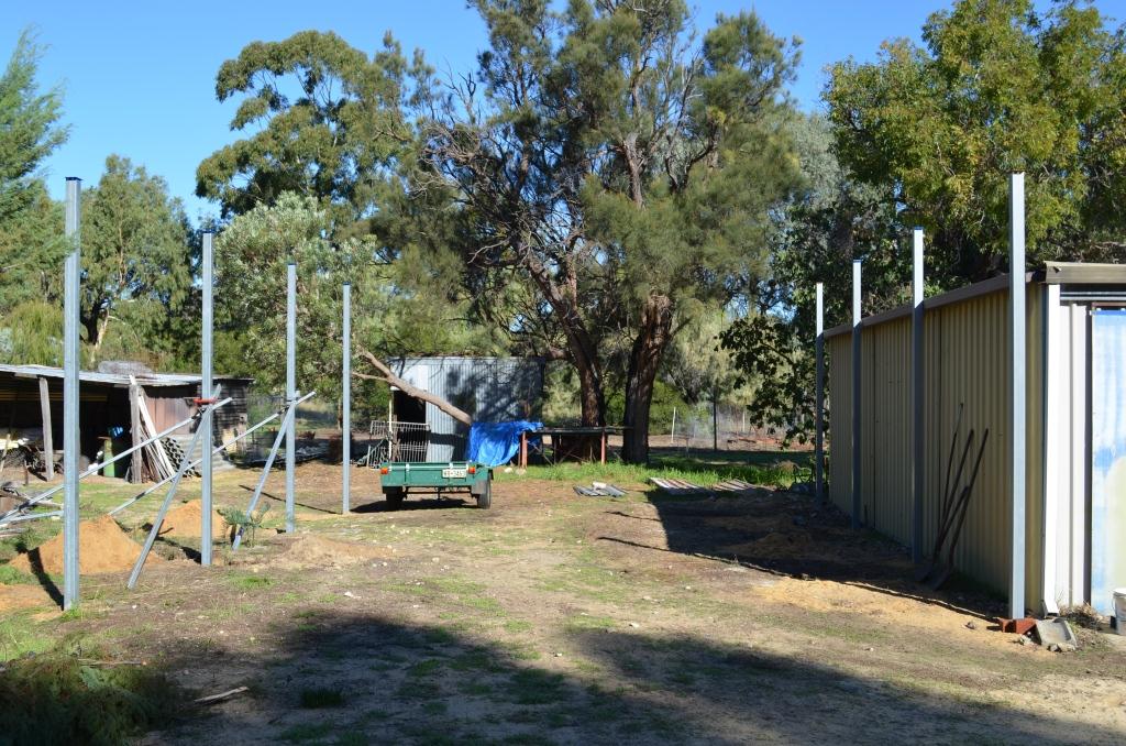

When I bought the Trailblazer 2 years ago, I knew it wouldn't fit under the carport. With that in mind, I started thinking about options for housing it and finally decided that the best option was to build a boat shed next to my existing shed....and make it big enough for both boats, the trailer and the Drover. I also wanted it high enough so I could back it in without having to lower the rocket launchers or take the canopy off...that would be a real pain.
The planning was going along quite well until mrs gates got wind of how big it was going to be....anyway, after some reassurance from me, including the obligatory stakes in the ground to mark out it's size, I finally got her nod of approval to construct the boat shed. Final dimensions are 7.5m wide, 9.3m deep and 3.5m to the underside of the roof truss.
I had to clear the area at the end of the existing shed because it had become a bit of a 'storage area' for anything and everything that was too good to throw away. Work started in ernest in April this year with an expected completion date of July....well, even the best laid plans can go astray and this build was no different. Last night was the first night the Trailblazer slept in its new home...albeit a little bit unfinished.
Here's the specs of the build:

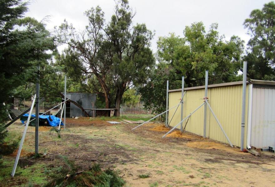

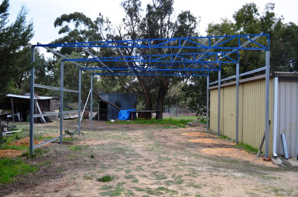

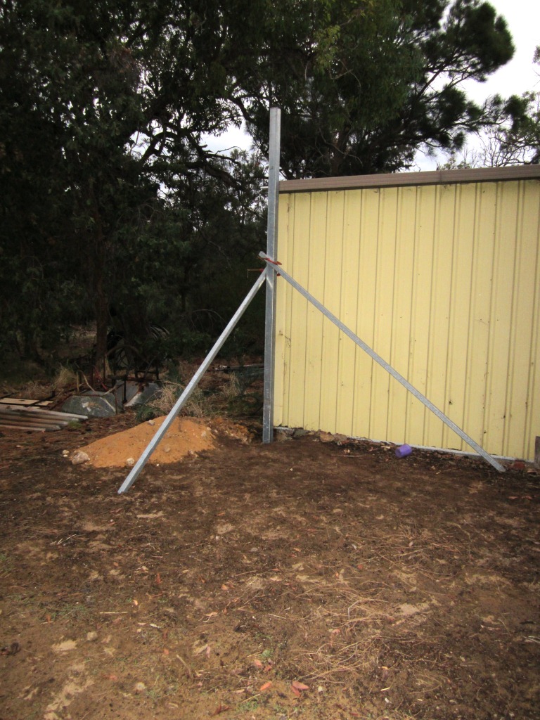

The uprights are 90 x 90 x 2mm galv RHS, buried 1m in the ground and the trusses are constructed of 40 x 40 x 3mm angle...the bottom rail is boxed angle. The sheeting was salvaged from the roof of our house when we carried out extensions a few years ago..which included a whole new roof....I kept saying that the old colourbond 'would come in handy one day'!
Each upright has a plate welded to it and it's matching counterpart bolted in place...when the truss was craned into position, it was welded to the other plate so if we ever wanted/needed to dismantle it, we could unbolt the trusses from the uprights. Top hat was screwed across the uprights and 76 x 38mm patio tube was used for purlins, which we screwed the sheets to.
I fabricated the trusses in the carport and the uprights in the shed, just because I had more room in the carport.
The build was a team effort with all members contributing in different ways....from digging the footings, mixing the concrete, helping with squaring the posts, screwing on the tophat, craning the trusses into place, etc. etc. Thanks to all the members of team gates
The finishing touches will include guttering, some more flashing, adding a door in the side for access into and out of the shed for the Drover, a concrete floor, lights and power points and some shelves and benches will complete the build.
