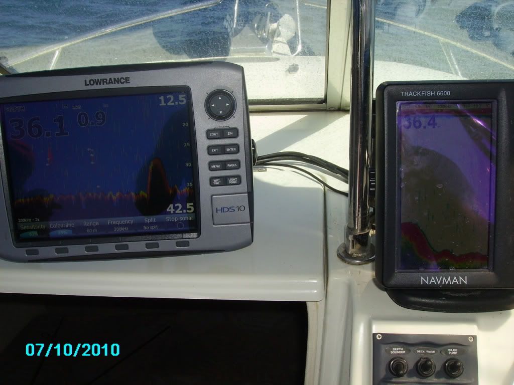

a pic of my 10 compared to
Fri, 2010-10-22 19:24
a pic of my 10 compared to the navman
this is using a p70 wet box tranny 50/200 600w
