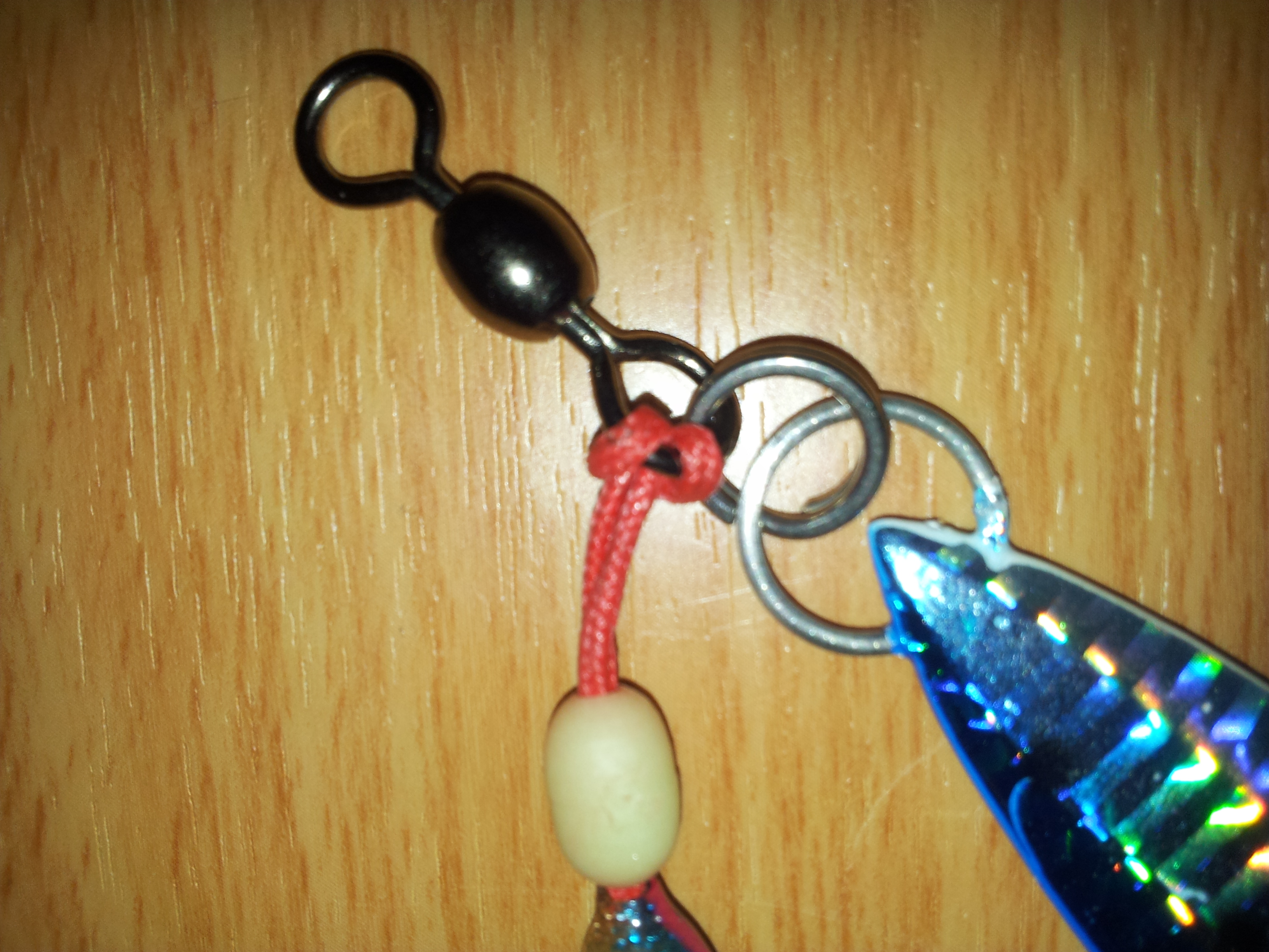

very new to tying/setting up my own jigs and was looking for some thoughts on the following.
have seen many photos of others set up jigs ready for action. with
:leader - swivel - splitring -Jig
then off of splitring - solid ring - assist - hooks
do people setup all their rigs like this. ie new assist/hooks for every rig?
ATM I have leader - swivel - splitring - jig....but assist straight off bottom of swivel.
With this I have the swivel and assist /hooks permanenty attached to leader and I just use split rings to change to any jig I want.
(no split ring to take load) saves dunking ten different lots of hooks when you change jigs
is there something wrong with doing this? something Im not seeing?
cheers for any imput

thanks for the comments guys...just put a photo in to clarify....is it OK to do as in the photo ?
hard to see in the photo but obv attached to the jig is split ring.
my logic goes.....split ring not attaching terminal tackle so just one less thing to fail.
(with solid ring holding assist then load runs through the split ring)

 as Uluabuster said, I use a
Thu, 2013-11-07 09:36
 as Uluabuster said, I use a solid ring to attach my assists. If you are using good quality splits and solids, like Owner etc, you shouldn't have to worry about weak spots etc. The way I set it up is Your swivel, solid and jig all hang off the split ring. Attach asists to solid. Swivels have more of a chance of busting than good quality rings. i found any unusual pressure (like you have set up in the picture), it weakens it. A swivel is supposed to pull up and down. not to the side.

 If you want to use a swivel
Thu, 2013-11-07 14:30
 If you want to use a swivel get some if the afw stainless ones. There about 10 times stronger than brass. Otherwise i use a solid where your swivel is. Ive seen too many splits open up to use them to attach hooks. Ive never had a problem with line twist.

if your using overheads a
Thu, 2013-11-07 15:14
if your using overheads a figure 8 rings with hooks off one side and tie leader on the other and a small split ring to hold the jig, problem solved with no swivels or load on split rings.
