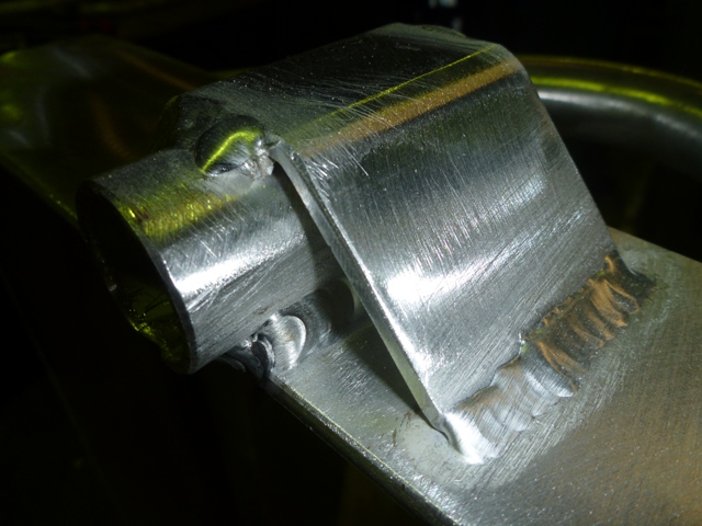

I welded the square frame togeather and worked on the handle bracket. I was concerned it might crack over time so i reinforced the tube with some flat plate .
I added the front foot and welded in the axle supports. Again i added extra plate to make them stronger .

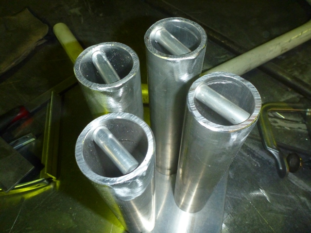

Then i prepared the rod holders . I welded in bars at the bottom to stop the rods sitting too far down the holders.
After alot of welding ( round tube leaves a big gap on a flat surface that needed to be filled ) and sorting out the handle . ( the handle can be removed for transport ) I was happy with the result .

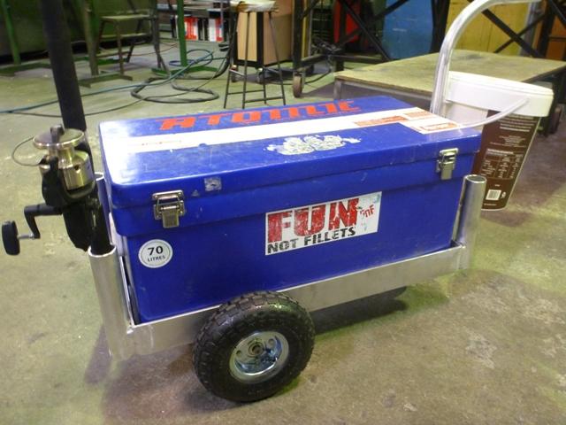

Esky fits sweet and the ballance was good too

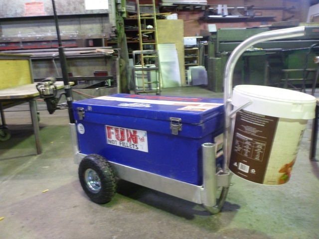

I put a simple hook on the handle for the bucket and i will probaly add a cutting board that fits into a rod holder.
I know it looks like there is no room for tackle, but i will just pile it on top of the esky . A fully stocked esky is more important , i can always carry my tackle bag if i have to .

What sort of welding
Mon, 2013-05-13 08:07
Hi
Is that TIG welding that you have done ? - Really nice looking welds !

Ericl , This time i used the Tig for a bit of practice on the thicker Aloy, the guy's at work are already placing orders ha ha , but i would probaly just Mig weld the next one . It would be alot quicker .

Great job Grant, looks very solid. I reckon I would add a removable set of front wheels to make life easier on the beach but I get a bit carried away with stuff like this. Top job.
grantarctic1's picture
Posts: 2546
Date Joined: 03/03/11
Yeah
Mon, 2013-05-13 10:19
Yeah i looked into that , but the wheels need to be under the cart so they can turn . I thought this made the over all hight too much for loading it into the back of my car .
I will probaly look at few different styles as i develope them . The guy's at work are making plans for their trolleys allready so i will get to experiment a bit . We will probally look at a few add on extras, like bait boards and battery rack for lights and live bait set ups .
