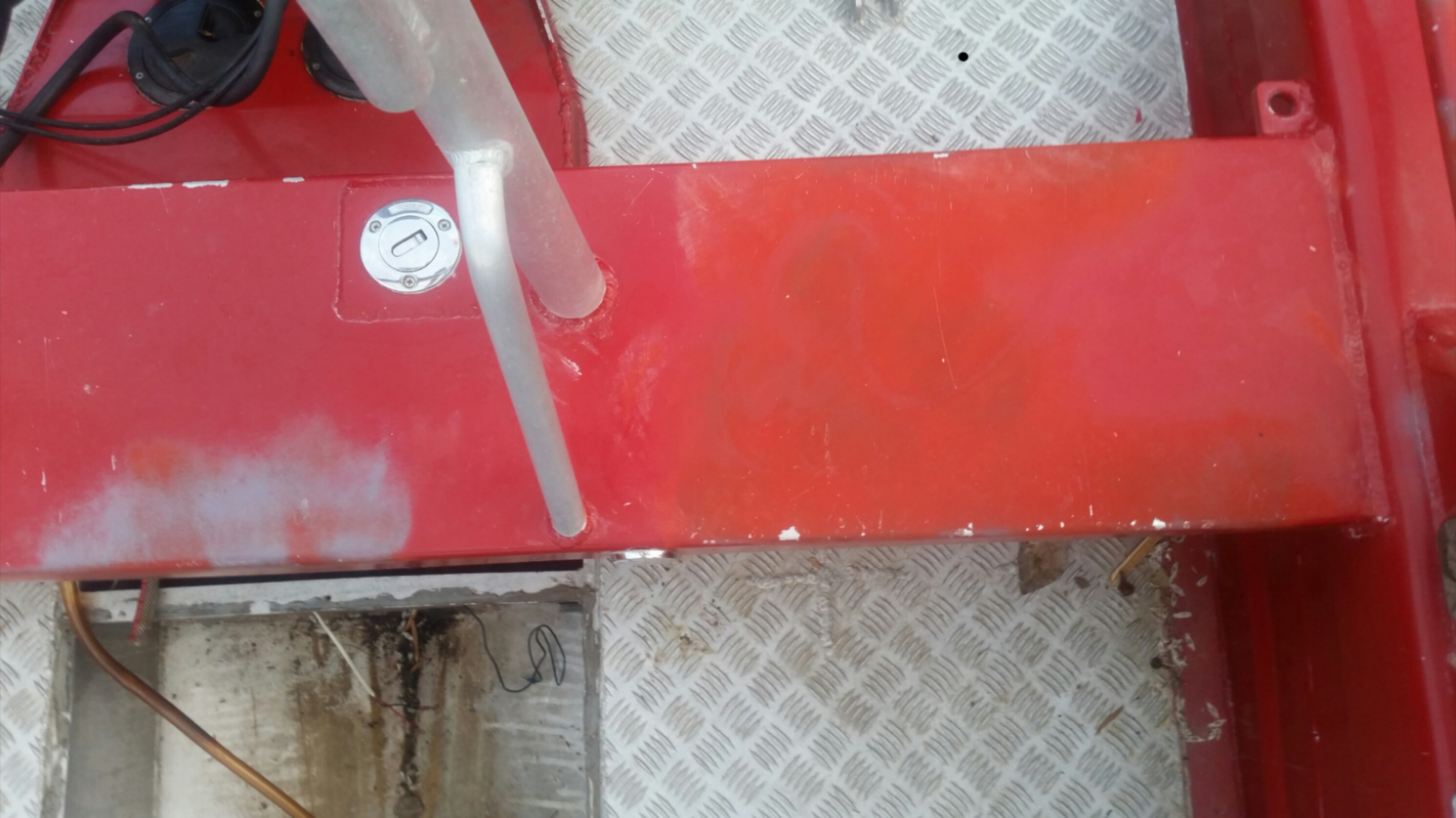

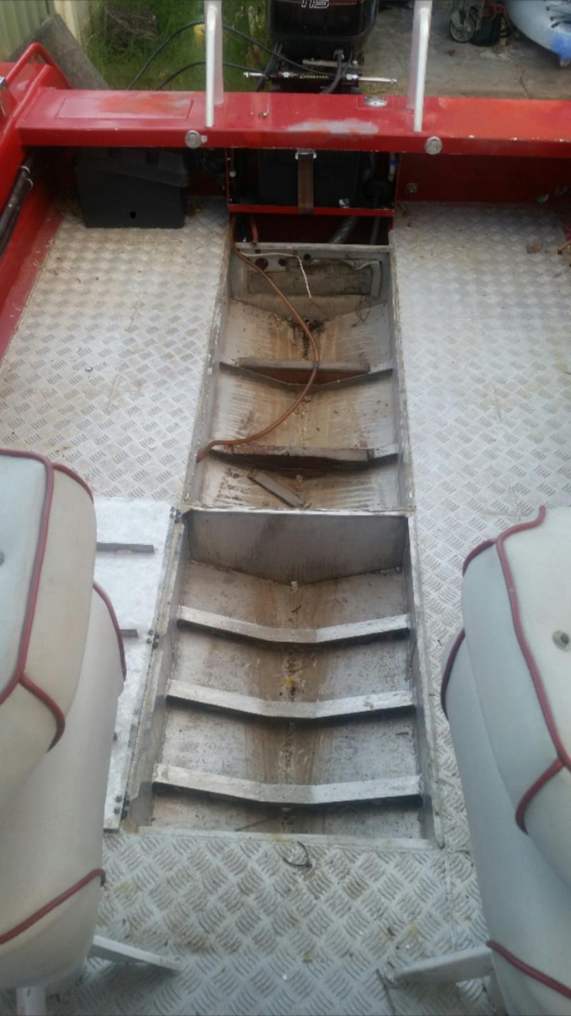

So I have decided to start ticking a few boxes on the project list, Firstly which was a recent box to tick is to get a new fuel tank. Just after the turn of the year I went out towing biscuits for a couple of days. First day went through 40l of fuel. Second say went through 80l doing exactly the same thing and was continually pumping fuel out of the bilge. So I decided it's time to sort out a new fuel tank. This arvo I removed the old 60l plastic tank and found the fitting which is the culprit and re set it into the tank. I do feel as though I could do with another 40l at least, so I am going to look into a custom job.

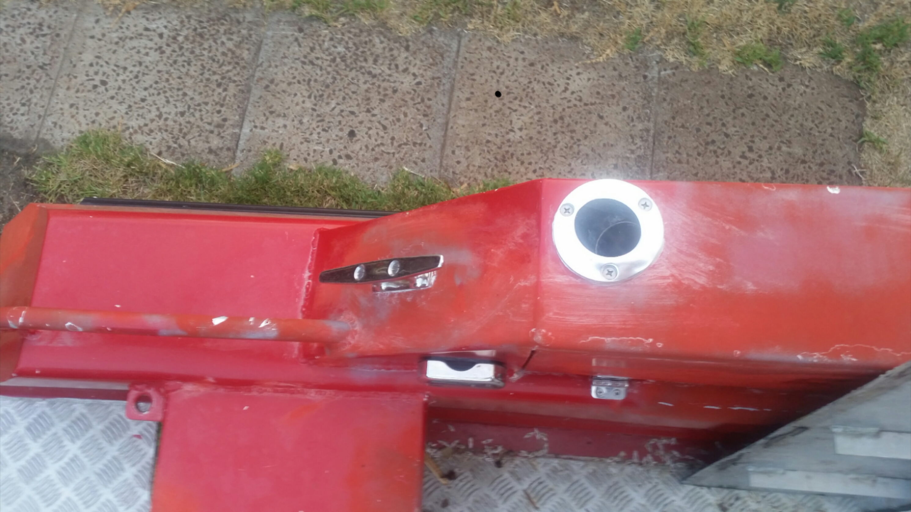

Secondly there is the paint. Someone in a great flash of inspiration painted it red, and now, a few years on, it is powdering off, no matter how much I polish it. So the challenge of removing the old paint and replacing it with some nice cool white/blue on the sides is in order
Then thirdly it will come down to lifting the cab hard top, and strengthening it so that it can easily support the weight of a person, and double as a wakeboard tower for those fun days on the river.
Any thoughts / recommendations / experiences are much appreciated!

fuel tanks, you may be able to find a plastic one suitable from BLA or here http://www.boataccessoriesaustralia.com.au/products/boating/engine-systems-controls/fuel-systems/below-deck-fuel-tanks/default.aspx
