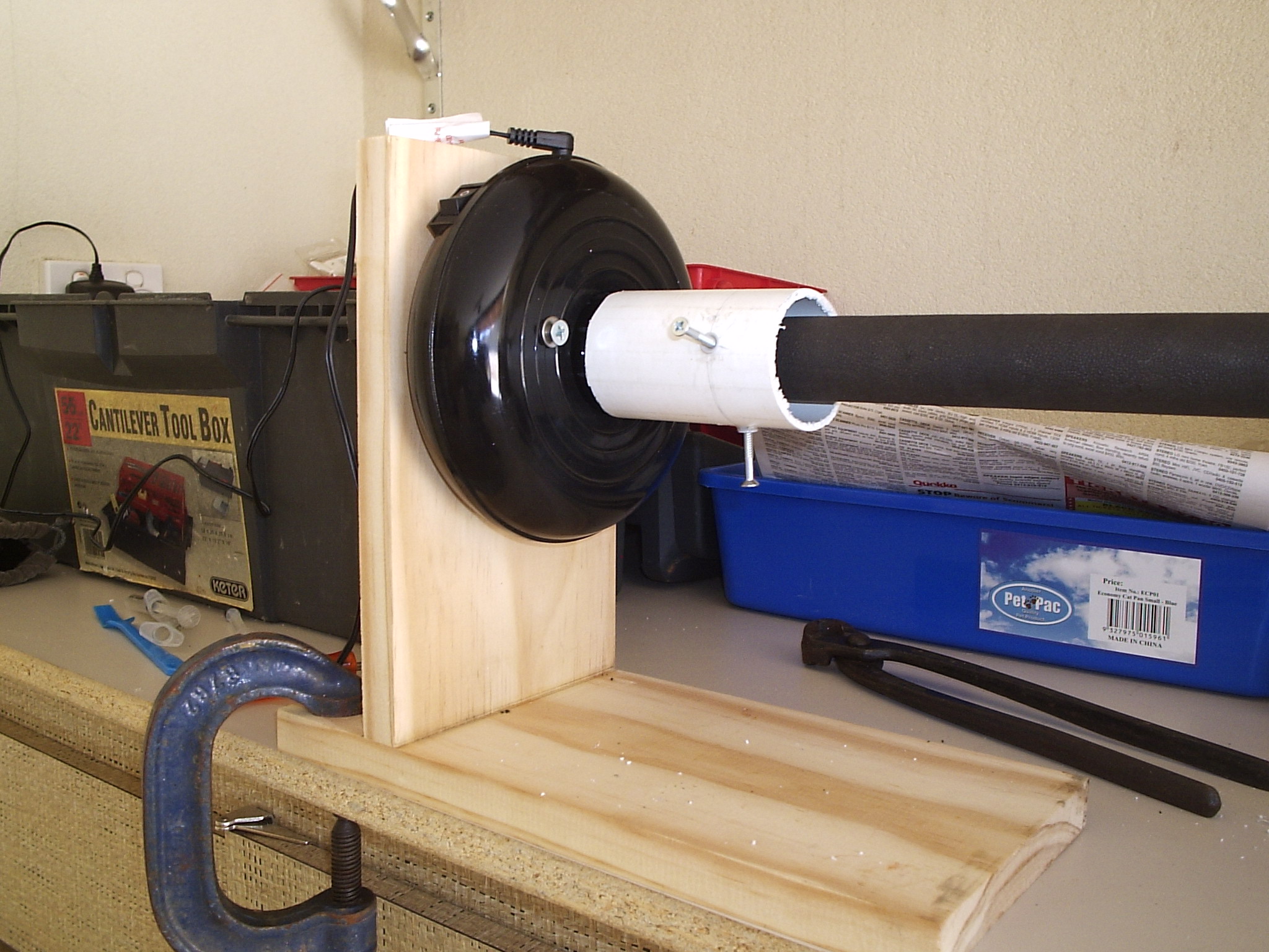

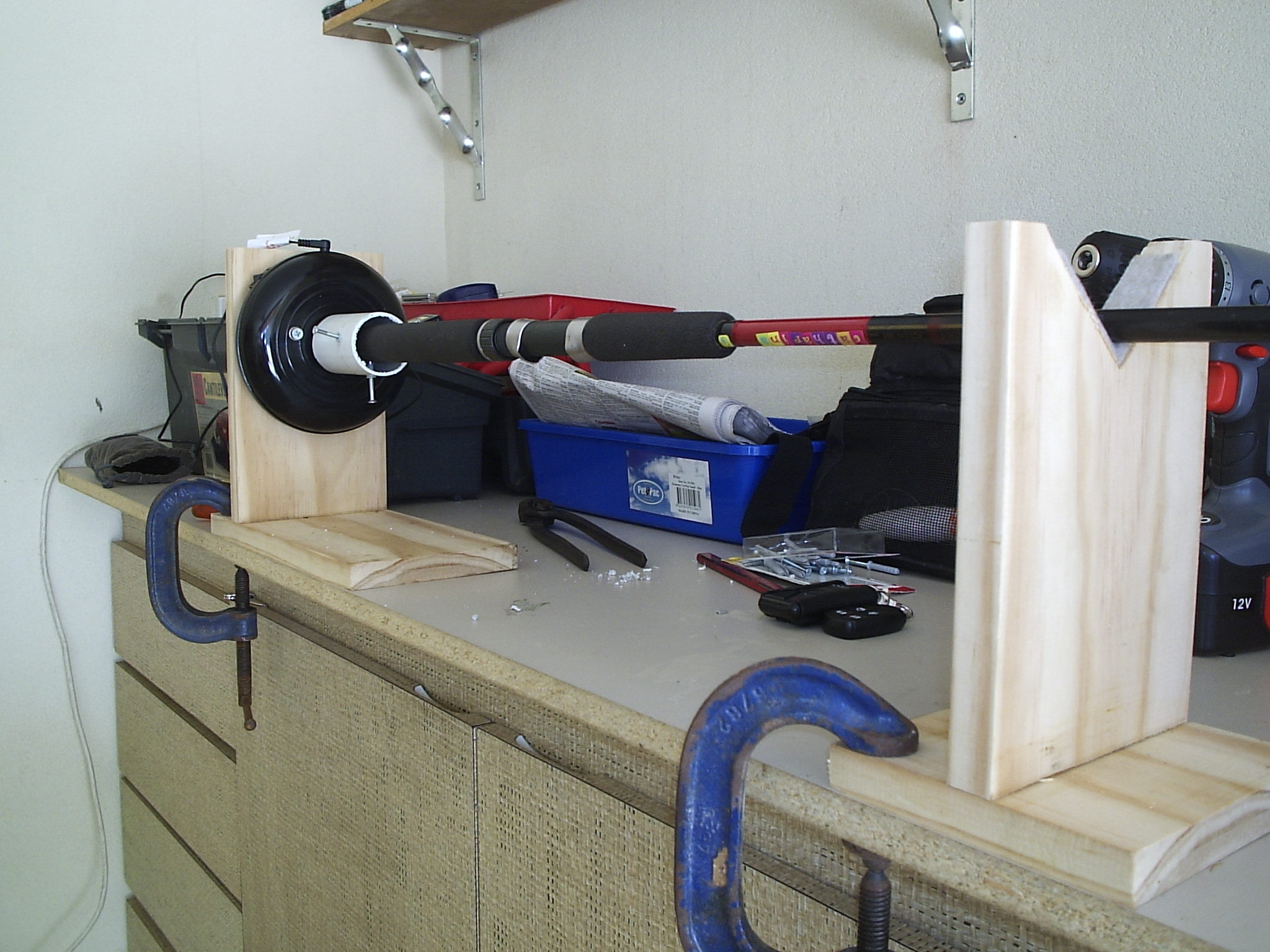

Inexpensive - made my own rod dryer / finisher..
Used a disco ball light as main rotating motor - took light cover off and modified to fit pvc 5cm tube. With main wooden support and 2 x "V" wooden support brackets. My 1st go at this and I am quite surprised how easy and effective this little project has been. Finished 2 x rods, a 10ft surf and 6ft boat rod. Fitted new guides, finished with epoxy. What a gem.

Nice work.

Good idea
Sat, 2011-03-26 13:24
Good idea mate , looks like a little lathe just much cheaper!

Fantastic set up

Fantastic set up

Id also look at getting some
Sat, 2011-03-26 16:42
Id also look at getting some rollers where that "v" is. But nice work. Looking at designing one for my self also.

 well done. great idea for
Sat, 2011-03-26 18:58
 well done. great idea for those that want to build their own without the proper gear. just goes to show you can do anything when you try
