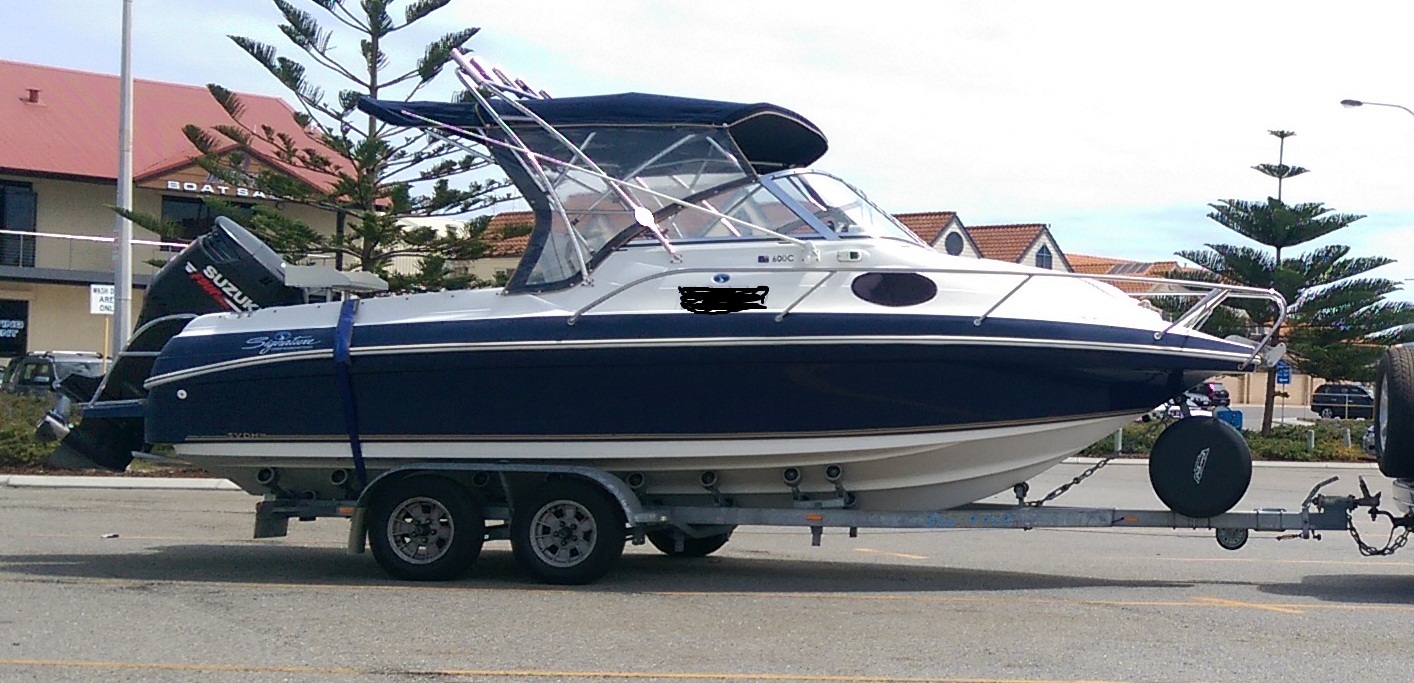

My current canopy set up needs some refreshing and I have 2 options I would like your educated opinions on.
1. fabricate a fibreglass hardtop which would extend slightly forward of the windscreen and have some new stainless steel bar work made up to support it, followed by clears
2. modify the existing rocket launcher made by Brad at West Coast Marine and have a new canopy with a stainless frame and clears mounted off it.
If they both cost a similar amount which path would you go down and why?
Also, if I go the hardtop option I will be selling the current rocket launcher if anyone is interested.

 Nice rig mate, but I reckon I would go the hard top, don't know why, though, just would be better for mounting stuff onto if the opportunity arose.

I've got an Ali boat which I recently changed from a canopy to a hard top.
Should have done it years ago.

Go the hardtop, once it's
Fri, 2015-07-03 12:16
Go the hardtop, once it's there that's it. No need to worry about replacement a few years down the track as will be the case with a canopy.
And as Dale says, better for mounting stuff, GPS antenna, radio aerials etc. (the higher your aerial, the better).
Will add a little bit of weight and change your centre of gravity slightly, but I would expect it to be hardly noticable.

 I am leaning towards the hardtop option. It shouldn't be too heavy so centre of gravity should be ok.

I have a hardtop ex factory on the Signature 632 - more than welcome to have a look. You've got a really stable hull anyway so wouldn't be concerned on stability

 wouldnt cost you anything like the same in reality Id think, but if it was probably hardtop as Dale said.
Id stay with clears as well, personally I hate looking through glass all the time at places like the islands plus even in winter there its nice to get some air through when parked up and summer is way too hot behind a fully enclosed hardtop.

The cost would be dependent on whether I can re-use the current rocket launcher or not.
Also the design will most likely be similar to the kevlacat hardtops but with a slight camber from left to right and tapered slightly from rear to front..
I was contemplating getting full height glass but only for about 2 minutes when I started to think about the lack of air flow and the heat in summer.

do it out of ali, fiberglass costly and a extensive process. replacing existing is just maintenance go hard semi hard top made to suit, you wont look back, has to be light though as top weight on that needs to be considered

I have had hard top and soft top. Can't beat the hard top in winter when its blowing and raining but love the soft top in summer and being able to unzip the clears for ventilation. It's difficult to ventilate a hard top. I had roof hatches and sliding side windows but it still got awfully hot in there.
The hard top is great for storage and mounting equipment whereas these options are limited on a soft top. You can also get a hard top to extend well over the windscreen to provide shade and reduce glare not many soft tops do this, the Cruise Craft being one of the notable exceptions
If you can get a hard top with 300mm clears across the front and sliding windows you might be on a winner. I would prefer glass for looks unless a good ally fabricator can put together the right look.

in all honesty I reckon a hard top following the lines you have with removable clears would look the goods factual and practical

Well it looks like I will be going with the fibreglass hardtop and clears front and side. The SS bar work should be verrry pretty, but not cheap. It will be a bit of a slow build but hopefully will come up looking the goods.
Now the fun starts with making up a mould for the hardtop. This will be my first fibreglass project so hopefull it will turn out nice.
