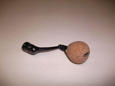

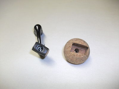

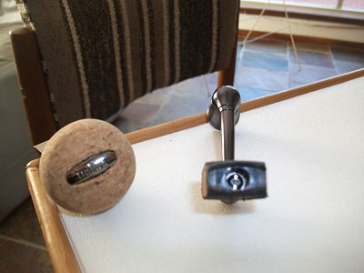

 Cork ball knobs are
Thu, 2013-06-27 08:01
