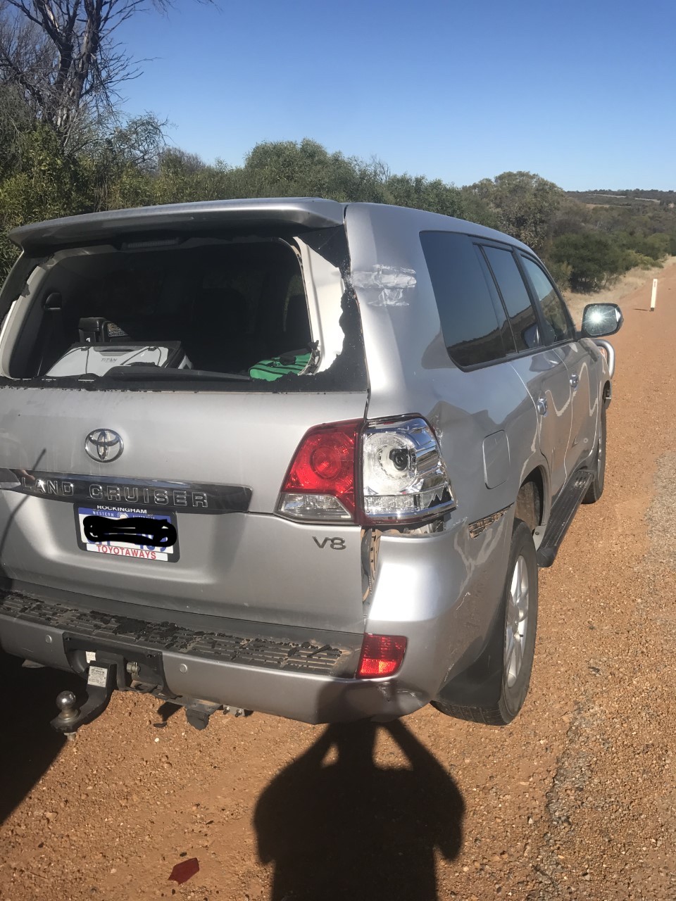

Could so easily have been a disaster
 I am recounting this tale with the permission of the boats owner.   A few years ago he had a 3.5 tonne custom made trailer manufactured for his boat, the boat was weighbridged fully loaded and came well within that load capacity.
Returning to Perth from Coral Bay on the June long weekend and travelling at speed just north of the 440 roadhouse the draw bar snapped causing loss of control, thankfully there was no oncoming traffic of we might well have been looking at more fatalities.  Lodging claims for the vehicle boat and trailer whilst the the car and boat were met by insurers the trailer was denied.  The reason for the denial was in no way related to the trailer being over loaded. An engineer appointed by the boat insurer determined that it was under-designed and that the steel used in the draw bar failed to meet Australian Standards.  Welding near the point of maximum bending stress had further weakened it and it failed through brittle cracking originating around the welded surface and then through complete shear failure.
The owner, through a fishwrecked member, came to me for advice. I had pretty strong views but wanted an engineer to look over the photos to comfirm so Seakem (Andy) was kind enough to review both the asessors report and the photos. Based on his thoughts I asked the owner to pay for and secure a mettalurgical report which confirmed our views. We then proceeded to make a claim against the trailer manufacturer for negligence.  Four months later and after much toing and froing he today signed a discharge securing reimbursement of the indemnity value of the trailer from the liability insurers.  A great outcome all around but it could so so easily have ended in tragedy.
I see regularly when I travel north fisho's treating their boats like glorified trailers, loading them up to the gunnels with camping and other gear, freezers, beer (you name it and they load it) potentially overloading the trailer and risking a similar failure and putting at risk insurance coverage on both the car and boat. Please think twice when heading north even though this had nothing to do with overloading I hope it acts as a cautionary tale.

 bad place to have anything come adrift. A bit hard to tell from the picture, and I know it was put down to poor design, ie, welding at a maximum stress point, but what dimension material was used? RHS or SHS, hard to tell from the pic, what size and wall thickness?
Posts: 2700
It was RHS
Fri, 2019-10-18 16:19
 125 X 75 X 2.7mm.    even at 3.00mm would still have been undersized

Main reason I posted this
Fri, 2019-10-18 16:49
 Was to hopefully encourage everyone to double check their trailers, you can bet I did, so I hope more will do the same .....if it saves one accident it would put a huge smile on my face.

No but luck was with them with no oncoming traffic
Fri, 2019-10-18 22:07
I have little doubt the outcome could have been much worse than some bent and broken steel.
