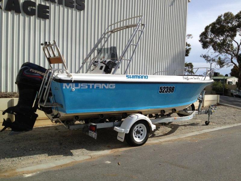

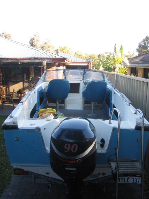

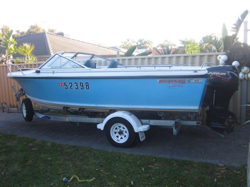

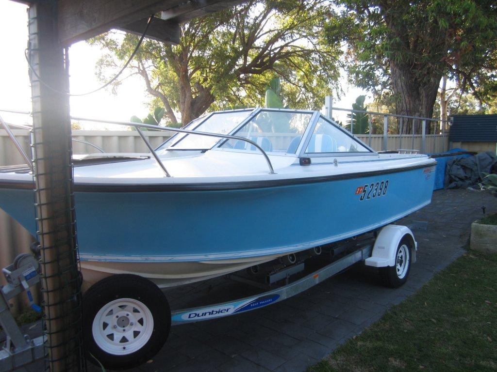

1978 18ft Mustang 1800
90hp Evinrude FICHT (it's ok, the problems were mainly with their V6's)
It had what I was looking for, solid hull which had been garaged most it's life, nice deep bow, new trailer, low hours motor and suitable for chop & change

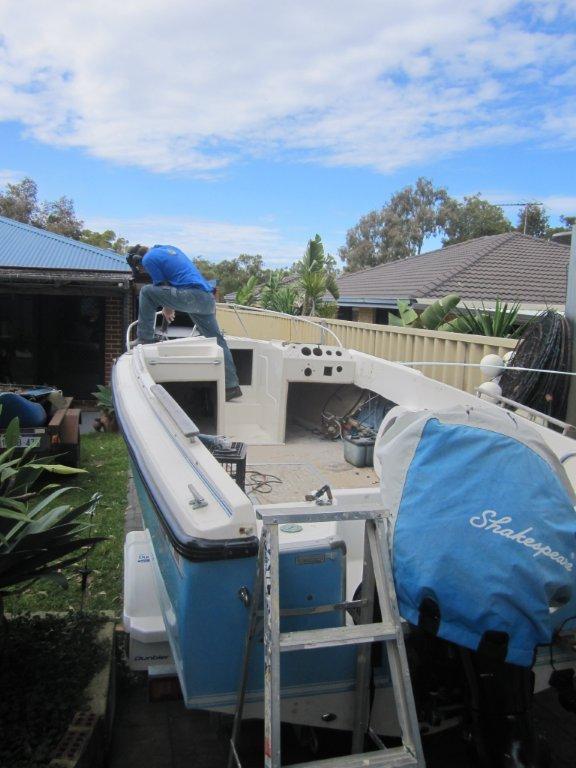

And so the project began. What I wanted to create was a centre rear console boat suited to fishing inshore reef systems, squidding and cruising the river. I wanted the console as far to the stern as possible creating maximum deck space and a smooth ride for the skipper.

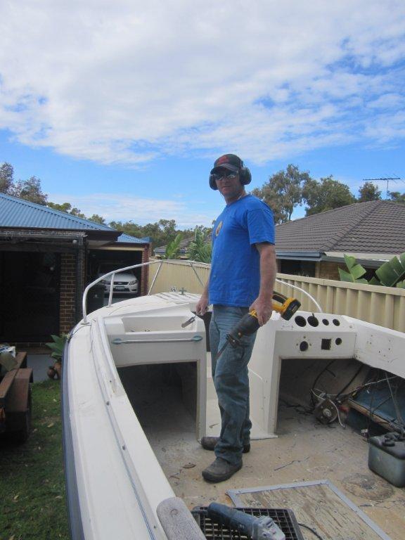

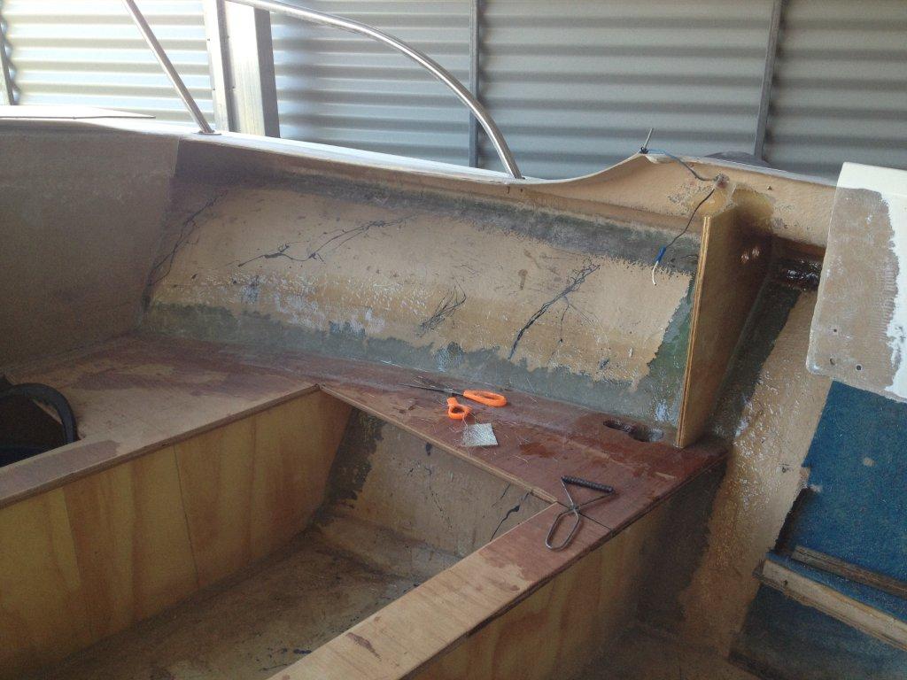

Start stripping and out with the grinder and recip...

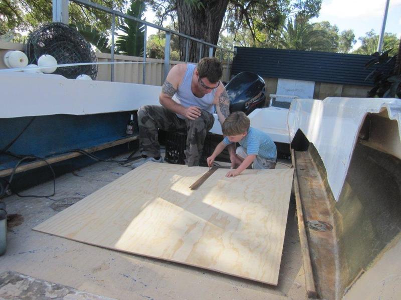

They love helping their uncle

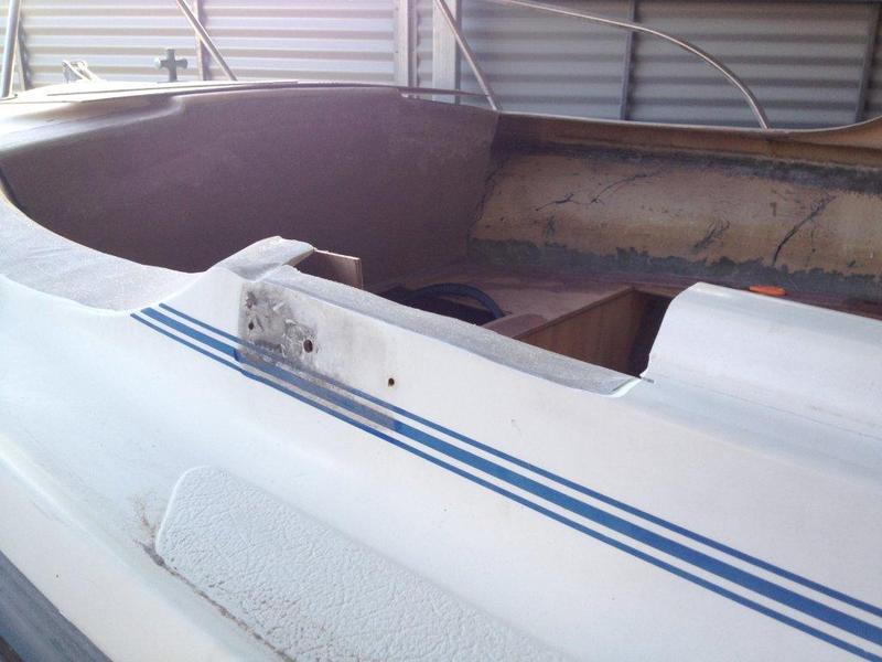

Gunwale detail

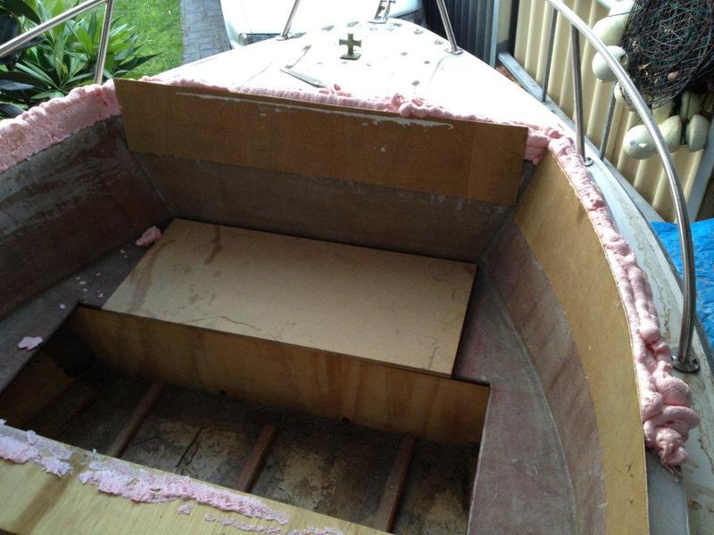

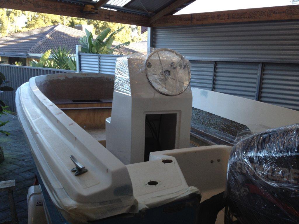

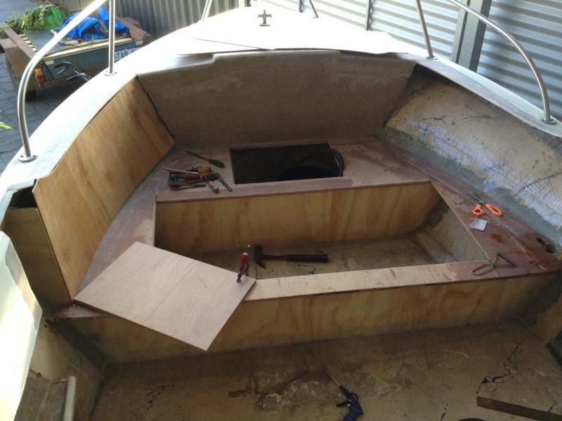

Foward bulkhead, casting deck with floor hatches. The larger for relocating the fuel tank.

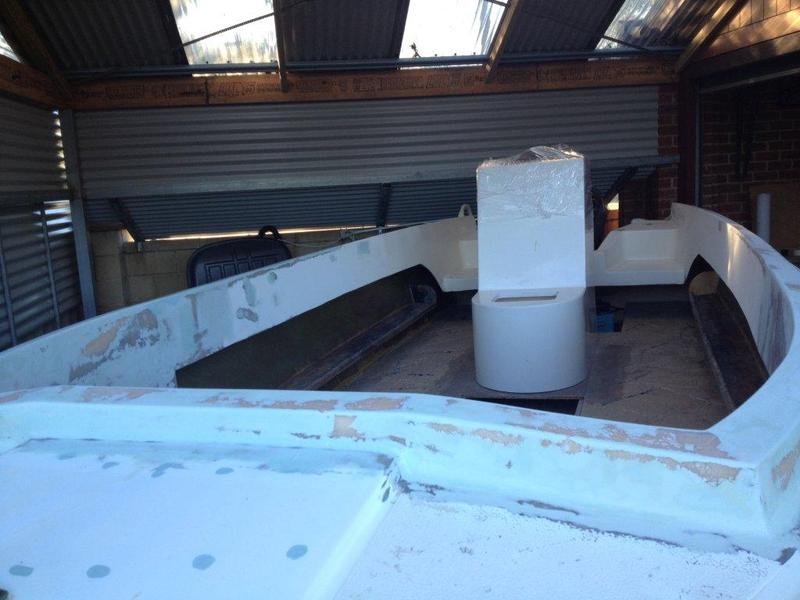

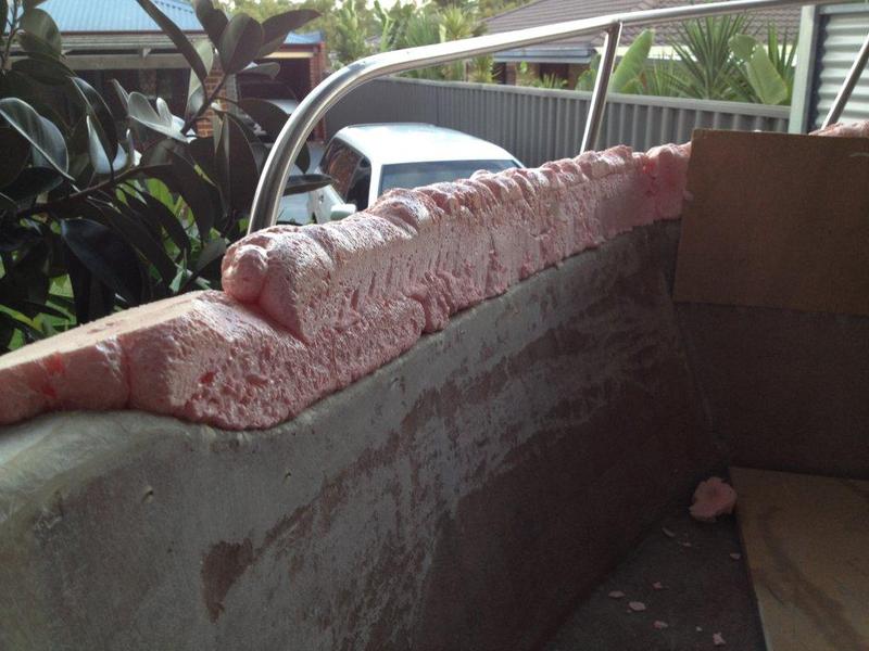

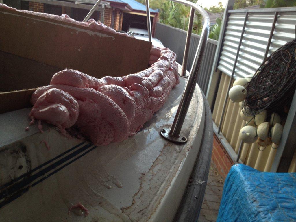

Forming new shape with expana foam

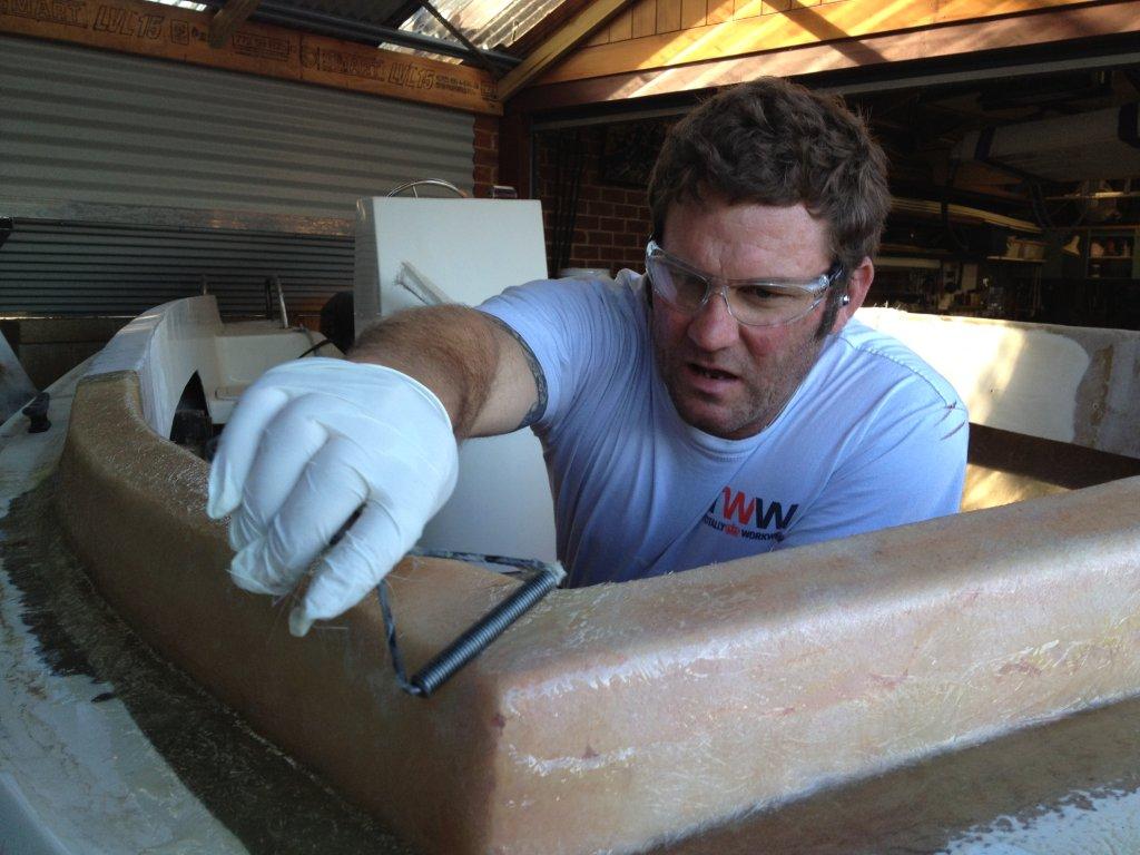

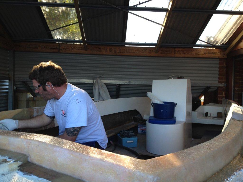

Shape it up & glass it in (middle of summer, had to work fast)
used 200 pair of latex gloves!
A big tin of filler and a crap load of prep work later, ready for paint

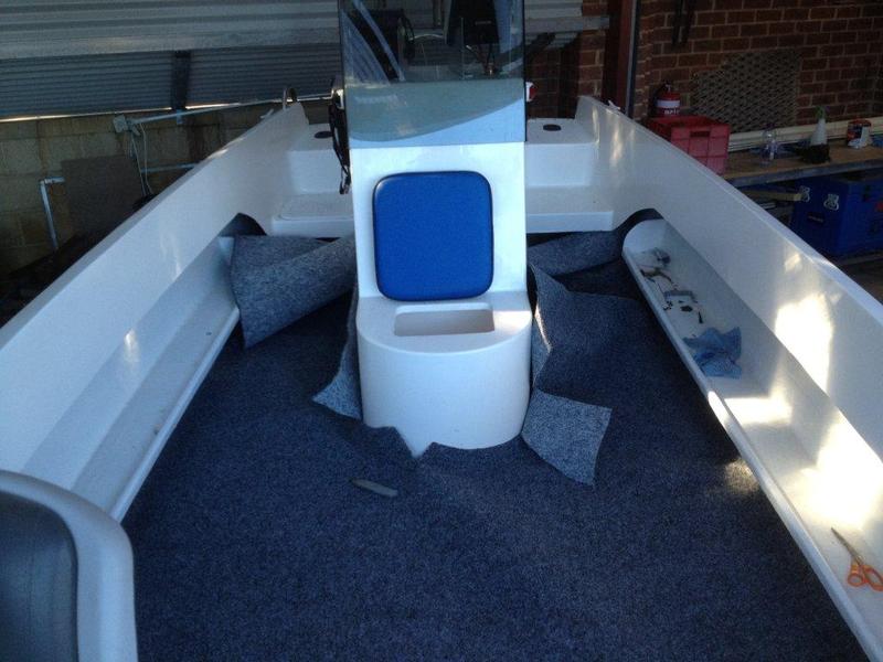

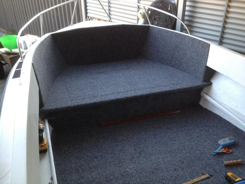

All painted, ready for carpet

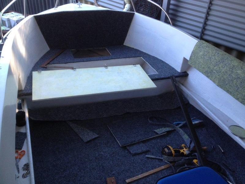

From there I moved onto the fit off, electrical rewire, installing instruments, reconfigure the remote control, reticulate fuel & oil lines, setup hydraulic steering etc. I updated the stickers, added a bit of bling and it was time for a much anticipated water test. It needed the console stripping down again to get it through my garage and out to the street so once out it wasn't coming back in again.

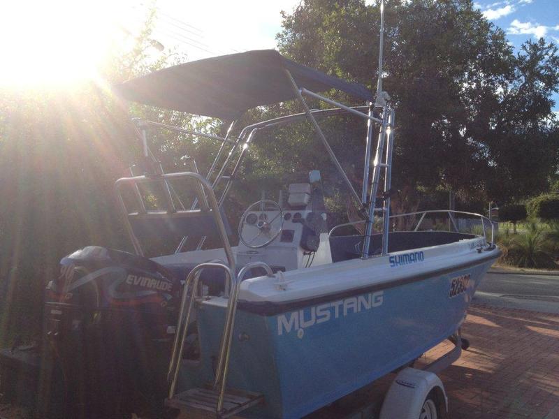

Thanks to trevor @ Nautec Fabrication for building the targa we designed. Sets it off nicely.
I improvised with a pre made bimini canvas and made it work for now, also trimmed the skippers seat with foam from an old boat cushion I pulled from a bin and yoga matting.

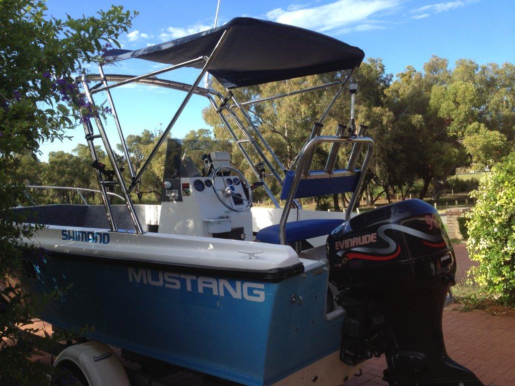

Almost finished -
What it's all about...
It turned out a great boat for what I want. Really glad I did it although it was a little ambitious given my wife was 4 weeks away from having our first baby when I started it. It was a lot of work, you start one job and create 5 more and it absorbed much more time than I was prepared for. I made plenty of rookie errors long the way but thats how you learn. Would love to do it again one day.

Just out of interest -what is the foam you used at the front (expander foam) what brand?

Clint, I tried to give the gel a cut n polish but it was somewhat unsuccessful. I must research it more and have another crack as the faded blue does let the appearance down a bit.
The foam I used was the Fulla brand. Its the fire rated stuff that's why it's pink, not required its just wht I had access to. The foam works well as it can be cut with a sharp knife and then shaped up to suit. I used a rasp similar to a board shaper then glass it in and a skim coat of body filler to get the final smoothness.

Thats just a fantastic job, I like the foam idea.

love that foam idea -has given me some inspiration to get back on to some of the glass projects i have dropped!

ive used the foam before when boggin up a WB 1tonner that had rusty sill panels. Works a treat!
