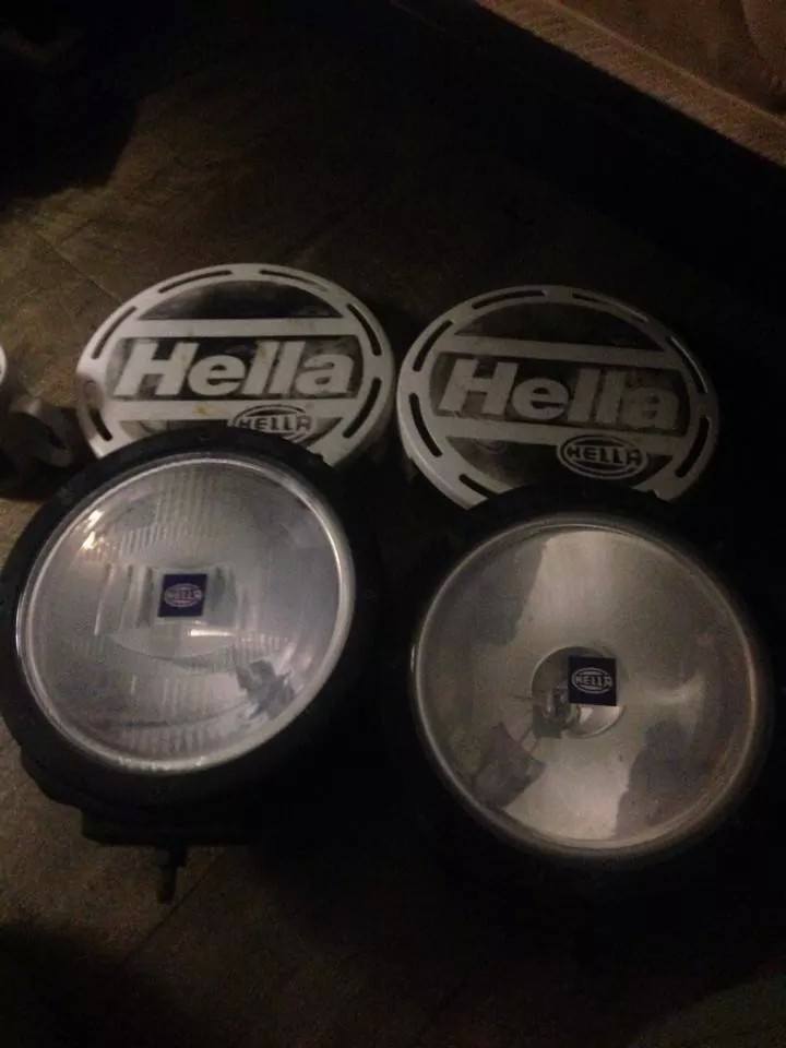

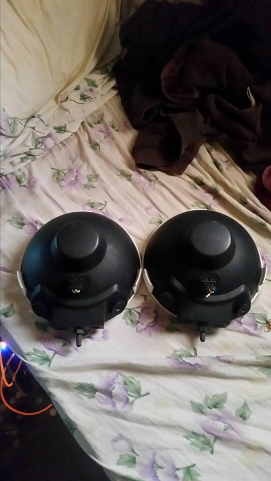

I'm looking at some Rallye 4000 spots (pencil & spread)
They apparently have come off a truck and have 24V bulbs.
The inside of the lens look slightly opaque.
The seller says that it's haze and will clean off!
Now I'm just wondering if this is the case or if these are F'ed
maybe scorched from 24v bulbs....dunno!
I'd need to get 12V bulbs for them anyway or convert them to HID
but my main concern is the glass!
Price is good @ $150 for the pair (no wiring loom but that's no deal breaker!).
Any advice appreciated.

 Dont worry mate
if ur gona change them up to HID then your only buying the shell of the spotties
so the cheaper the better really cos u replace globes and wires anyway.
wont even notice the haziness once the hids are hooked up

 And if I go to normal 12V bulbs?
Just wondering if the haze can been cleaned off as well?

hi salty dog i deal with truckies all wk long mate there are a few of them that have had this happen and managed to clean them up, then i have also heard that when they go a tad foggy its meant to mean that they are on there way out. if you need hids i can helo you out. i work in kewdale at a truck acc shop feel to msg me and we can sort it out for you.

I have 6 off them on 3 vehicles all pencil beams spread are shit IMO. All are 100w HID.
Price is ok but hazey reflectors.. not what I would buy

 If they're polycarbonate or acrylic lenses they should easily buff out, just google headlight restoration.

Saltydog,
I have a set of Rally 2000s that went foggy up on the inside of the lens, sounds like those you are looking at have the same problem.
I managed to clean them up by using pieces of rag tied to a short length of dowel and metho. Took a bit of time but they came up spotless, that was 5 years ago and they are still clear.

 cell, thanks for the offer of help!
the seller says the haze is on the inside, if they can be cleaned with the metho trick then I might still consider them.
out wide, I hear ya mate and have been considering a bar but funds are tight and that'll have to wait
I just thought that for the price and if I can get rid of the haze then that'll be better then the small hella's I have on at the moment
even if I just get new 12V bulbs.
