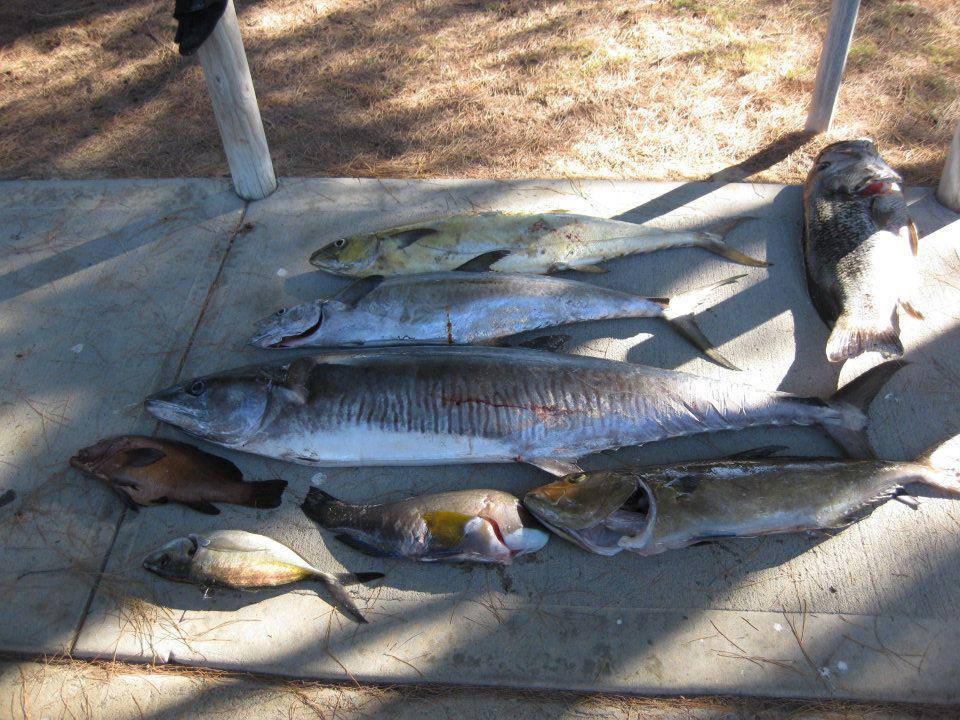

i can put up the picture
Mon, 2012-04-30 12:23
i can put up the picture showing his whole bag but then thats the only other one i have. so is a grey a broadbarred?? or differnt fish?

I reckon its a broad bar.

Lucky that they won anyway, broadbar and grey mackerel are the same thing!

that mouth gives it away,rather catch one of those pound for pound then the other 2 types
