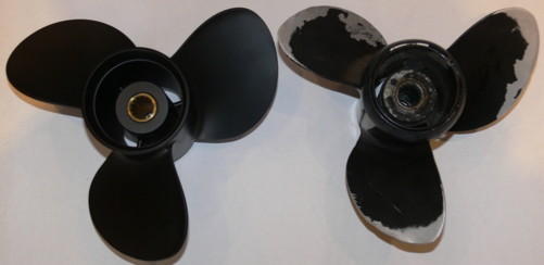

Bought new prop
 Was going to Perth for the weekend so I took my prop with me, thinking I would get a second prop with different pitch rate
went to "Just Propellers WA" in Osbourne Park, Michael looked at my prop, that I thought was 'ok' and put it on the test machine he has there and spun it like it would on the boat.
To my amazement it was running all over the place, it was pretty well stuffed as the photo suggests, but to a total novice it looked ok on the boat LOL
I decided there an then to replace it, so bought a 10.3 x 12 instead of the specified prop, as was advised this will get me out of the water and on the plane faster, going to test it out as soon as I finish this.

did they really tell you that
Wed, 2011-02-16 09:08
that prop looks fine apart from the obvious scratches and dings you need to do a lot more damage than that for it to be stuffed sounds like that machine of theres is a great sales pitch

what about the 4/5mm
Wed, 2011-02-16 13:02
missing around the edges

its quite obvious its a different size prop you just dont lose 4/5 mm

Have trust it is stuffed
Wed, 2011-02-16 17:44
 They did tell me, then showed me how it was stuffed.
I was not there expecting to buy a new prop, just get it looked at and maybe machined
It was definately not even and it wobbled on the shaft with no play on the rubber, as it was the blades that were bent and way outa shape
The 'machine' they use verified their opinion as I was invited to check it all out for myself, they set it up in my presence, it was not a set-up in any way..
Lets say I have 100% full TRUST in the company, this was all done after hours for me.

yeah i dont get it either - a
Wed, 2011-02-16 11:11
yeah i dont get it either - a bit of paint loss shouldnt affect it. and even to a novice, having something that would make it run all over the place should be fairly obvious (i.e. bent prop, twisted shaft or whatever)...
did they run the new one and the machine?? and if so how did it run differently...
now you have me worried about the bit of paint coming off my prop....

I dunno. that bottom blade
Wed, 2011-02-16 13:06
I dunno. that bottom blade looks like it's been hit good and twisted.

 all blades on the old prop are identical in size and shape, must be the angle I took the photo
all blades on the new used to be too

do they 'bend' when they hit the concrete ramp
I will knock the blade back and file off the rest so each is the same, next time I go to Perth I will take it back to "Just Props" and get them to make it perfect again

The old one looks pretty
Wed, 2011-02-16 17:21
The old one looks pretty nackered to me.  I was told once that the slightest nick, dent etc on a prop causes big power losses due mainly to cavitation.  Not sure if it's true or not but sounded logical to me?

 I would have to agree, I
Wed, 2011-02-16 17:34
 I would have to agree, I knoticed the difference in acceleration and planing performance is amazing in the 10 minutes I played with it this afternoon
