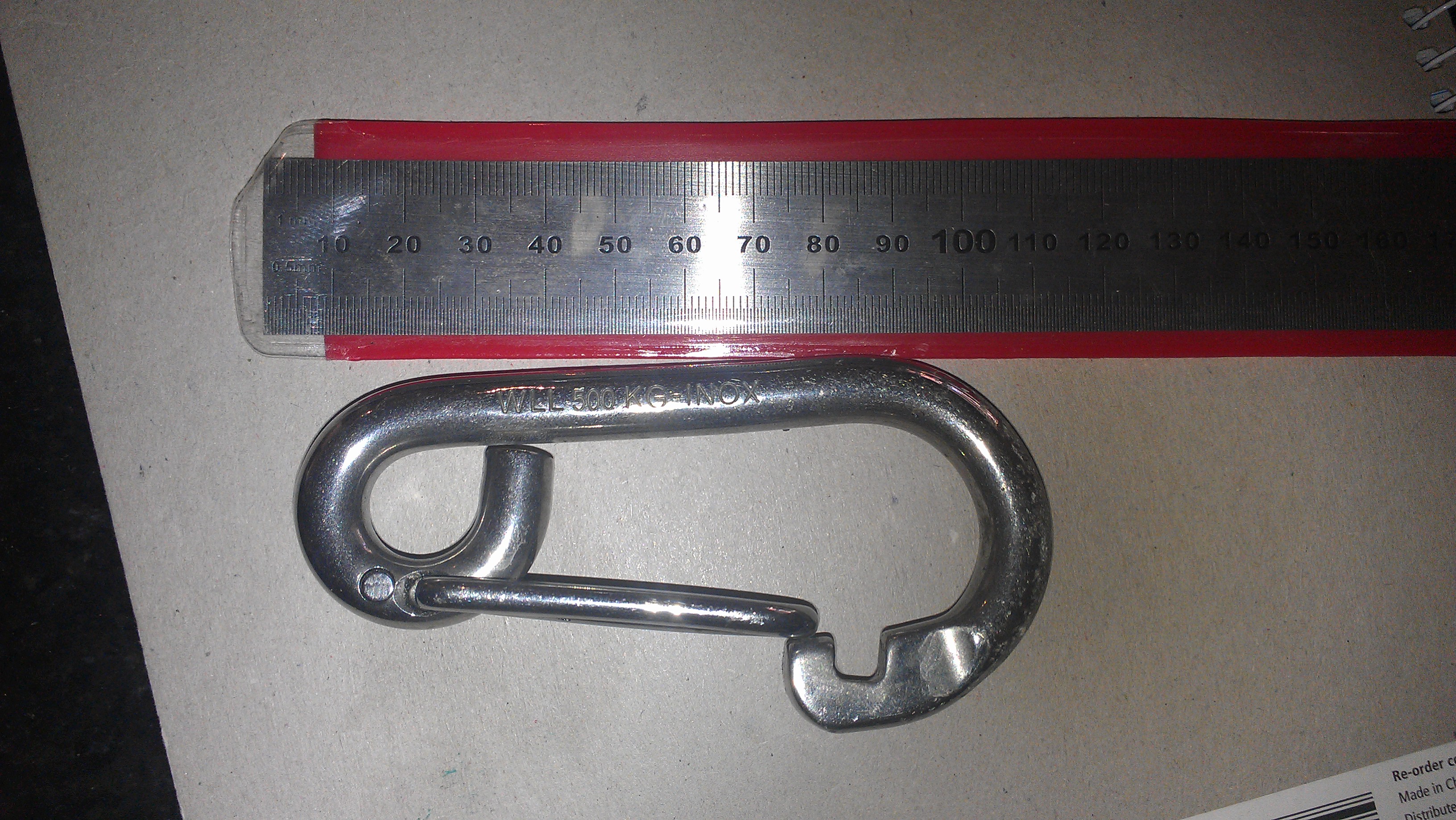

Hi guys
Here is a question for the engineers amongst us.
What size hook do you need for a boat that weighs 1500kg? This may sound dumb, but you arent loading up the winch with the full 1500kg when pulling the boat up the trailer. Somehow I have managed to bend (deform) a 500kg rated hook on this boat. It didnt bend on the retrieve (I dont think), but it is bent now so it may have happened while towing. Obviously 500kg is not enough.
So, the question is, for my Haines Signature 600c, what size hook should I use?

Got a photo of the hook ?
http://img.gg/BQ91Sys

Ill take a photo of the snap tonight. It isnt anything too gnarly...but it is definitely deformed.

bradz's picture
Posts: 693
Date Joined: 29/10/07
Thu, 2014-01-16 17:04
a photo of the distorted hook has been added to the original post.

Would definitely be upgrading
Thu, 2014-01-16 17:19
Would definitely be upgrading that hook (stamped 500kg) Bradz to one rated at least 1500kg consider the strain put on it winching in certain scenarios such as extra load or water on board. last thing you want in an urgent/emergency retrieval (heaven forbid it happening in the first place) is for the winch to fail/snap.

Hook
Thu, 2014-01-16 17:48
 Yep that type is no good for heavy applications

bradz's picture
Posts: 693
Hook
Thu, 2014-01-16 17:55
Believe it or not a large local boating shop recommended it to me knowing which boat I had.
I'm looking for a stronger one as we speak.
