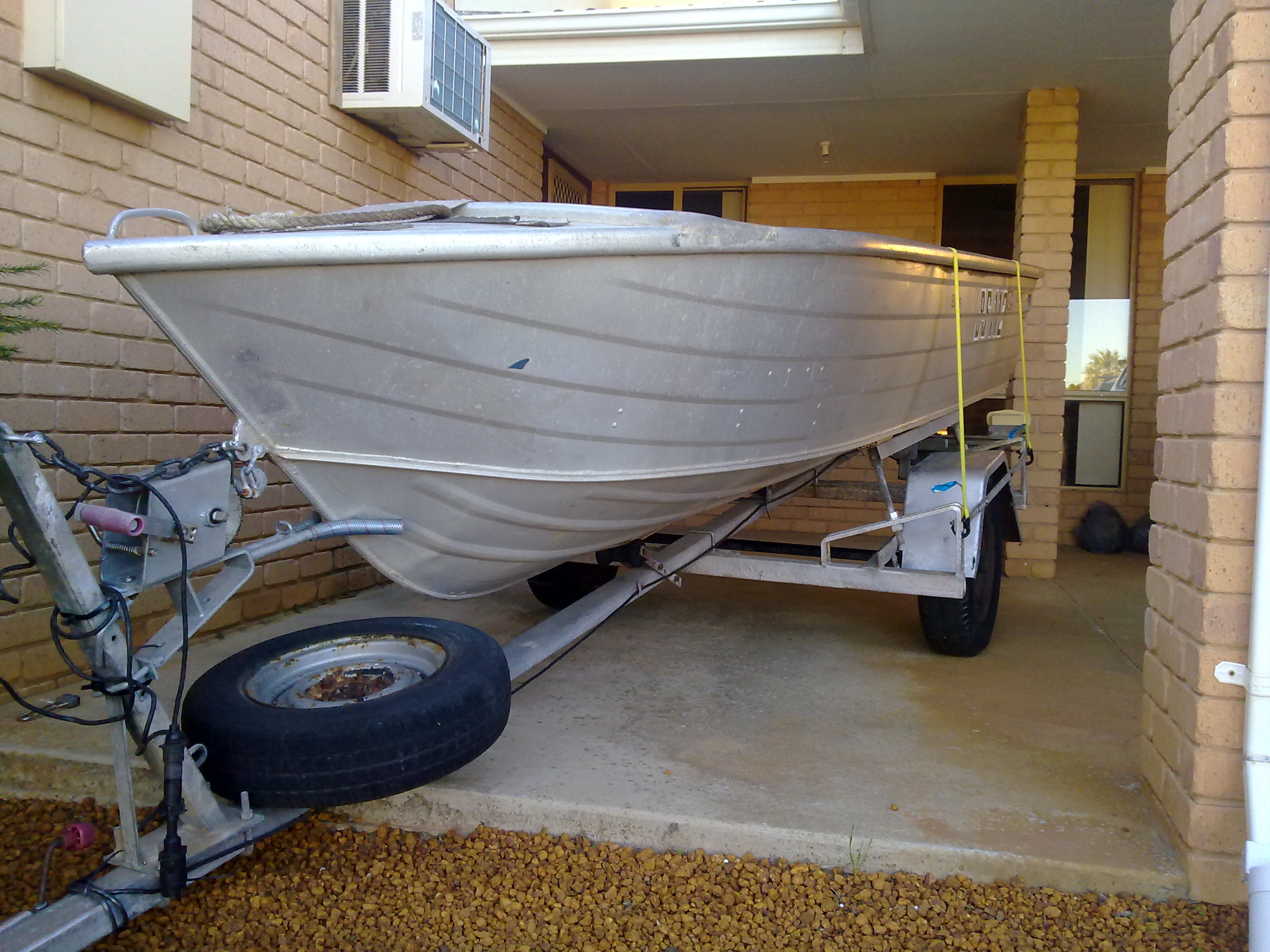

I have just purchased a un licenced dinghy and trailer (cheap) and was wondering if anyone on here has ever had to re register a boat and what is required to get it on the water and if anyone has had to take a trailer over the pits and what they look for?
I know with the trailer that i need to put on a few reflectors on the front, side and back, replace the chains with stamped approved chains and also install a number plate light. Other then that all the lights work and bearings seem to be in good condition. Is there anything else that might catch me out???
With the dinghy, Where do you take them to get inspected? There is a couple of cracked welds and the rear seat has copped a bit of damage. Are these the sort of things that will fail? Also gotta install lights. Is the anything else on the boat i will need?

Looks like a great buy for the coin you outlaid ringy.
Check that trailer link the supervisor put up in Jim1's trailer post. I've just built one according to those regs.
You don't need to have nav lights to register a tinny either, but you are then breaking the law if you use it at night.
Ps. Looks heavy on the drawbar. LOL

You need the usual things like lights, chains, guards etc on the trailer but the only thing on the boat is a HIN number if one isn't already fitted to the hull.
All the safety gear you must have depends on where you wish to use it with the exception of life jackets which you must have for each person on board and anchor and rope.. If you want to use it at night then if I remember correctly for a vessel under 5 metres is an all round white light.. For off shore, a radio, bailer and flare kit will be needed.
