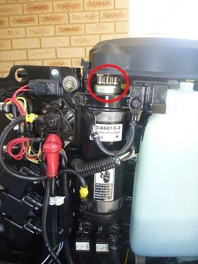

Pretty hard to explain since
Tue, 2011-01-11 10:37
Pretty hard to explain since im about 2% mechanically minded, il take a picture. Had someone tell me the part is not available is all.

The cog looking thing,
Tue, 2011-01-11 10:59
The cog looking thing, everything runs fine its just for some unknown reason one of the teeth has snapped so  its a tad louder when you start the motor as its skipping that tooth. Just has something to do with starting the motor that cog. Ive gotten Leah to turn the key and i saw the snapped tooth.

Also, you can just see
Tue, 2011-01-11 11:01
Also, you can just see pictured my oil container....the lil breather cap, not a biggy but that was gone when i bought it so wouldnt mind getting another one just to have it perfect.

id say thats part of the
Tue, 2011-01-11 11:16
id say thats part of the starter moter should beable to get a cog direct from merc

you'll need a starter motor
Tue, 2011-01-11 11:23
you'll need a starter motor mate.

should be able to get a new
Tue, 2011-01-11 12:39
bedix gear from  most auto sparks or try ASHDOWNS just give them the number of the starter

merc dealer
Tue, 2011-01-11 15:22
Any merc dealer will be able to get you you one its just the starter bendix. they sell it is an individual part, part number is -685753.

Thanks to all info massive
Tue, 2011-01-11 17:31
Thanks to all info massive help, quote was $98 +$13ph from marine direct, will call a few more tomorrow...Having that part no helps greatly Andy, cheers

Ended up picking the part up
Tue, 2011-02-08 13:38
Ended up picking the part up today from Noel in Rockingham $72. Only problem is when i try and take the bolt off the whole mechanism spins. Im guessing i need a powerful ratchet to override the spinning? Anyone know how to help?

Sounds like you need to stop
Tue, 2011-02-08 14:24
Sounds like you need to stop the starter motor from turning at the same time.

Yeh thats it, Noel said he
Tue, 2011-02-08 16:11
Yeh thats it, Noel said he just uses a ratchet gun to get the job done. Didnt want to tow the boat from Heathridge to Rocko just for that though, will get it done somewhere here this week.

I ended up getting it fitted
Wed, 2011-02-09 19:09
I ended up getting it fitted properly mate, Thanks heaps for the offer. Thought best to get it done properly, running perfect!

socket
Wed, 2011-02-09 19:33
for future reference you put a socket between pinion gear and flywheel
