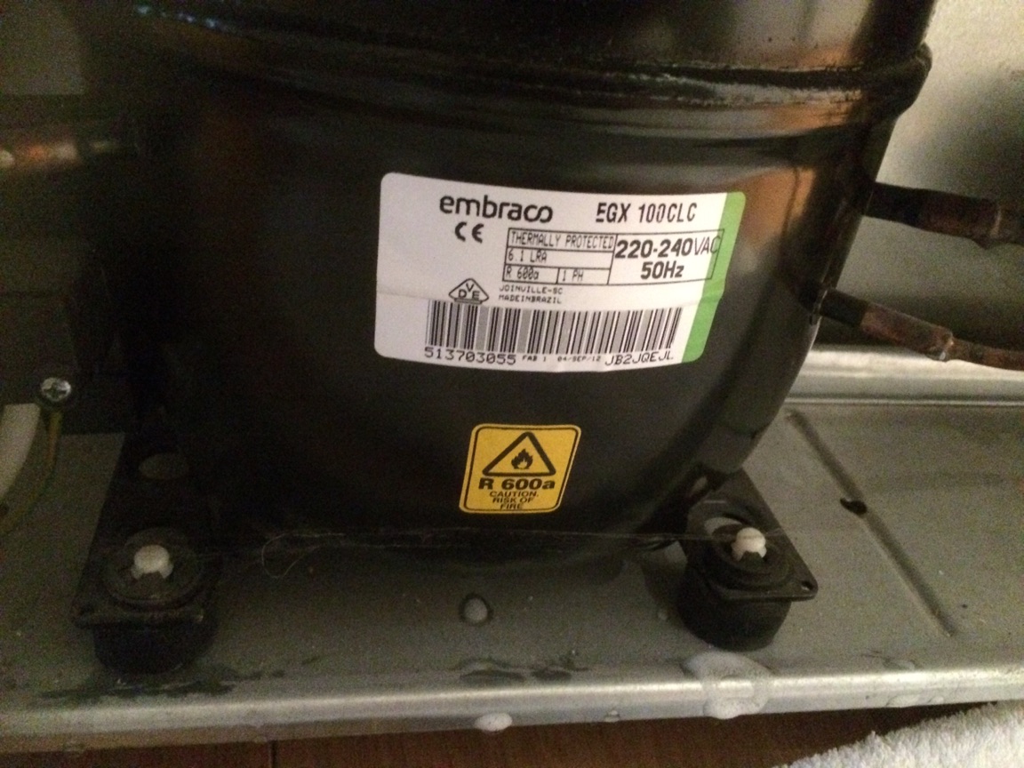

Have a ~4 year old Fisher and Paykel French door fridge (double door) with freezer underneath
got home around 5pm and noticed the fridge was warm - freezer was a nice slurry - everything working (lights, compressor, fan etc) pulled out the fridge and the compressor was really hot (have read that this may be normal)and water in the tray above compressor
Turned it off and emptied the whole fridge/freezer - at the rear of the fridge there is no grill or cooling fins - just a compressor and copper pipes that go into a sealed section of the back of the fridge - (and by sealed I mean spot welded)
It was turned off for about 2 hours - I turned it back on and it straight away started getting cold and left over night it now seems to be working fine (ice maker making ice, freezer freezing)
Can anyone advise what may have caused that and more to the point what may still be wrong with it? (ok for compressor to get that hot? -could not hold my hand on it)
pic below is all that is accessible behind fridge (there is a plastic tray that sits on top that water drips into - there is also a small copper tube that snakes its way around this tray)

Posts: 5905
 The tray is to evaporate the
Tue, 2017-01-31 23:04
 The tray is to evaporate the water from a defrost cycle, otherwise you'd have to plumb it to a drain.
As above probably iced up the evaporator.
Pretty much all new fridge/freezers dont use coils as such but an FDC setup (forced draft cooler) hidden behind a panel.
A fan which circulates air inside.
But as said humidity or plenty of unfrozen product can frost up the evaporator and ice is a great insulator.
Its normal for the compressor to be pretty warm and itll have a thermal overload.
Condensor is often in the base where you wouldnt see it normally and reduces the air gap needed at the back.
