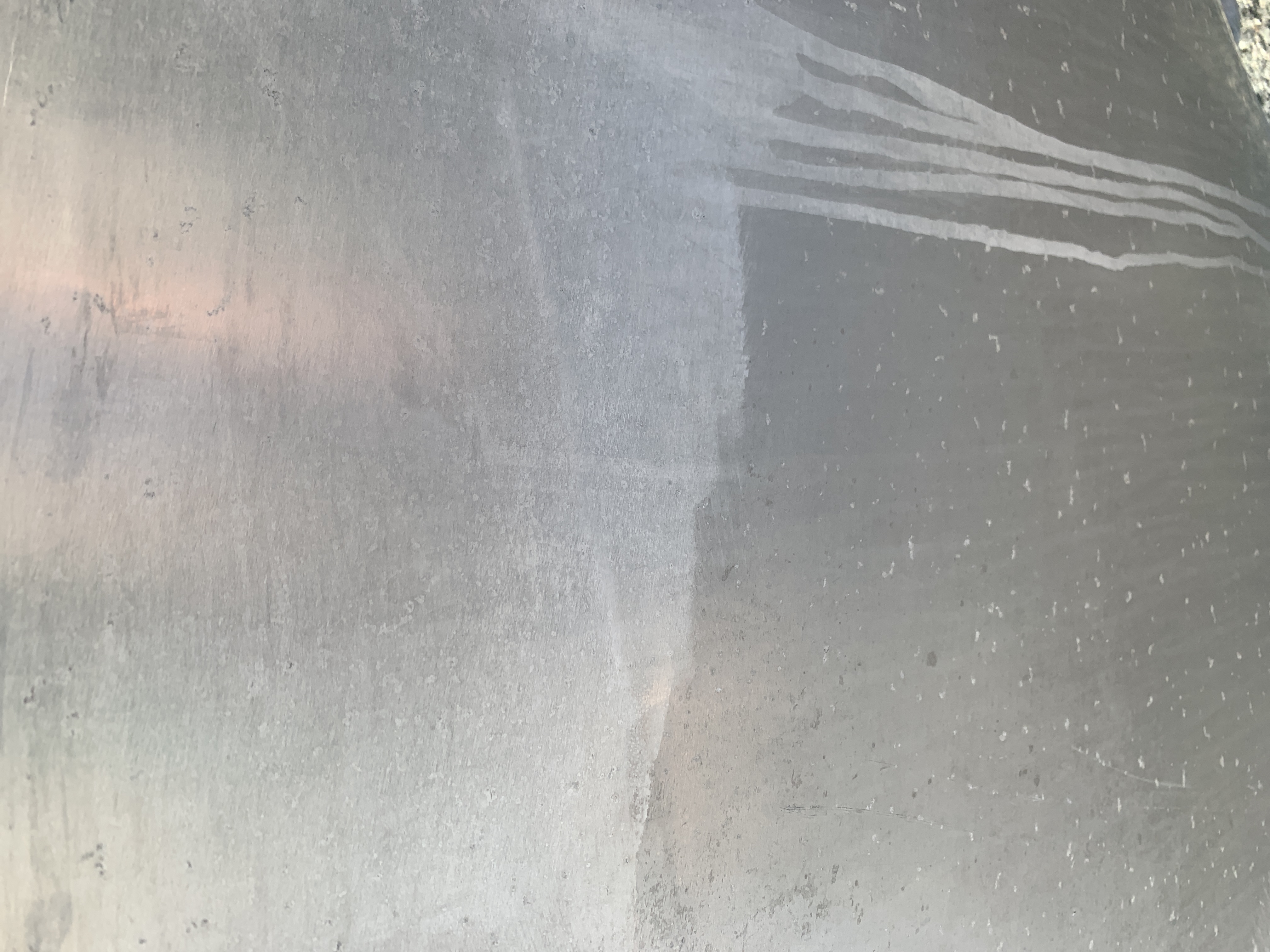

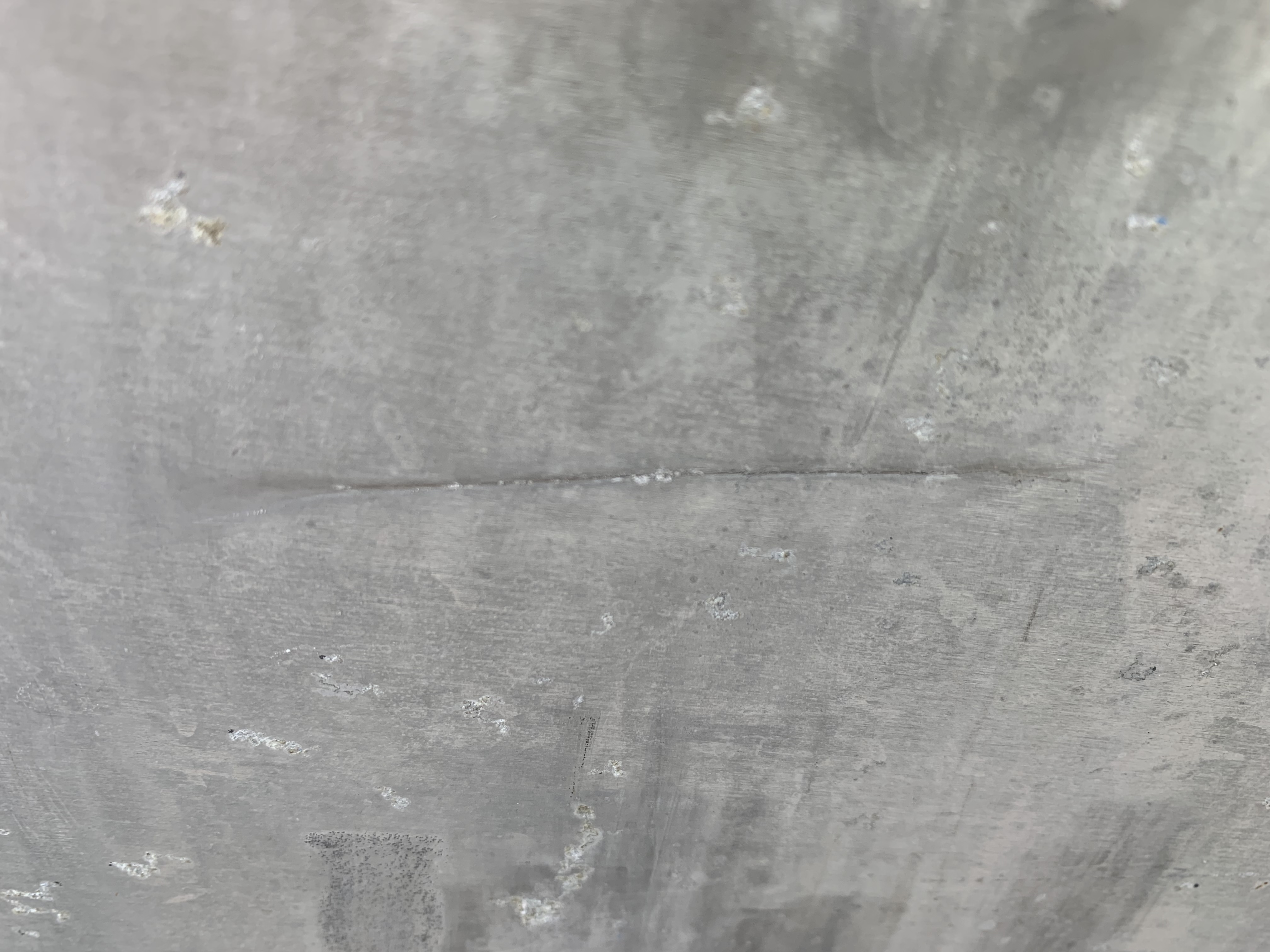

needing a welder/ally boat builder to do an inspection on my boat for insurance purposes. I know it’s Christmas time
but really could use a favour off someone so I can get this claim accepted. Little crack in the hull after hitting something out wide :(

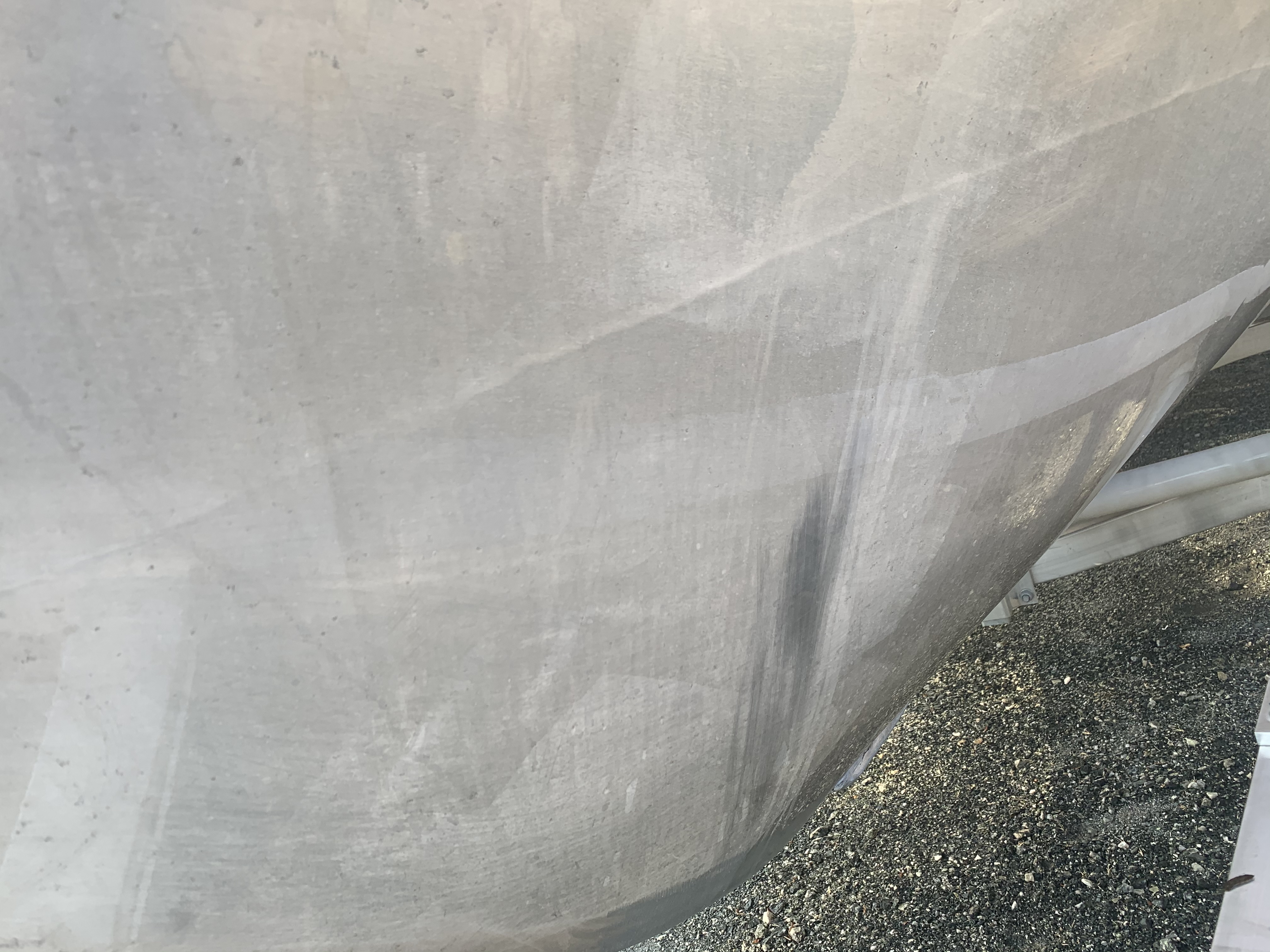

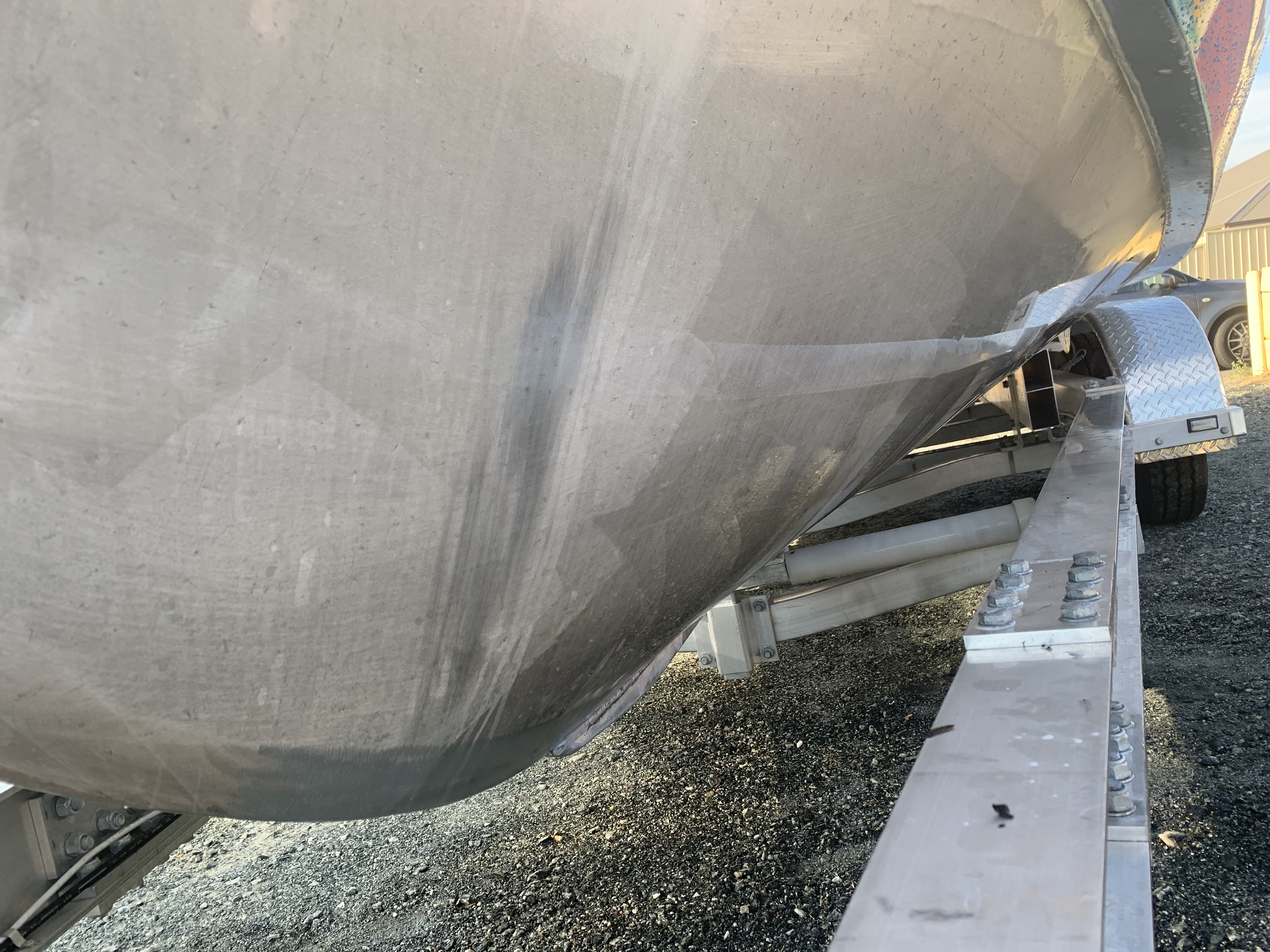

second pic is for the possible corrosion comments. Just dried salt. Abit of acid wash and it's gone.
added a couple pics of the hull after an acid hull clean for the guys that think there is corrosion. It was a quick one only took about 3 mins so wasn't a proper clean

does look like fatigue
Wed, 2019-12-25 11:50
 surely if you hit something there would be fresh marks on the Ali, Looks like Fatigue from the photo to me. I'm sure i have seen this boat for sale recently    cheers ACE

Corrosion
Wed, 2019-12-25 14:48
maybe I’m seeing things, but there seems to be a bit of corrosion going on there.
Can you get to the inside to see why?  I had two holes appear in my boat and when I got to the inside (by putting in a new inspection hatch) I found some old salt water that simply ate holes in the 5mm plate

 Nah it's just salt/Calsium
Wed, 2019-12-25 15:00
 Nah it's just salt/Calsium build up. A lot of people think it's electrolysis but it's just dried salt. Had a bloke come over and say that then got some Hull cleaned out and did a square patch and it all came off.

Yes, but its the dried salt, sitting inside that does the damage
Wed, 2019-12-25 17:15
 it just sits there, inside, unless washed away, and eat holes. And please don't blame "cheap chinese ally", this has been a problem long before we started importing foreign-made rolled product. I've had a lot of experience with keeping ally hulls going, had two ali crayboats , plate dinghys, tinnies--I reckon I've seen it all.
I take it this pic was taken from the outside of the hull? You've certainly had a bit of external corrosion going on. Blowing the picture up, it appears there is a bit of a gouge forming the basis for that crack? Edges appear to be a little chamfered, before the crack runs off in a slightly different direction on the RHS of the pic. There is what appears to be corrosion along the crack, as someone else said, but that could just as easily be salt water which was trapped in the crack, and then dried out, giving the appearance of corrosion.
How much is your insurance excess? if you are up for $500, you'd be a lot better off just paying for a repair, unless there is a lot more going on. Apart from that, your biggest challenge will be finding a fabricator to do it between now and new years--most businesses will be closing until next Monday, I would think.

Hate to say it mate but that
Wed, 2019-12-25 18:10
Hate to say it mate but that isn’t a impact crack that is a fatigue crack impact crack would of caused a massive dent where impact is. That is from the ally constantly flexing in and out when you hit waves/slop. I’m a welder by Trade. I hit something in my old genesis and it caved the front section of the hull in didn’t crack or puncture but made a massive dent. This unfortunately is not from impact

Mine wasn’t cracked it was
Wed, 2019-12-25 21:03
Mine wasn’t cracked it was dented from impact damage. Impact damage would have a dent and if
it was a sharp object you hit
would be a gouge cut not a straight crack
Fatigue cracks are usually straight lines like yours.  Kind of like if you bend an ally can back and forward eventually it will tear

 Not a boat builder but spent
Thu, 2019-12-26 07:51
 Not a boat builder but spent the best part of 25 years playing on a 60 foot aluminium boat.
impacts in Alumnium cause dents. That's the advantage of it. You get a lot of forgiveness before it lets water in it. I am sorry but I am confident that this isnt impact damage.
Personally, I would be cutting into the deck to see what is behind it as my thought goes to thin plate and an isolated pressure point.

 To fix that properly you
Thu, 2019-12-26 08:04
 To fix that properly you will need to access the other side and see what's going on behind. Can't just run a bead of weld right over the outside and assume it's fixed.
If it was making a sound like a wobble board it may of had an internal rib let go and that whole section is flexing. Needs a proper inspection.

Ha Paul, How did the repair
Fri, 2020-01-10 21:03
Ha Paul,
How did the repair go....any photos, cut floor to repair internal stiffener as well ?
Posts: 290
Date Joined: 22/05/19
 Yeah all went well. Found a
Sat, 2020-01-11 08:00
 Yeah all went well. Found a local boat builder who welded the 20mm long crack which was good and insert a inspection port for me also. 300 dollar cash job for that time of year I'm happy with. But after like 2 months of trying to sell it. Sold it like 2 weeks ago and just got a all-rounder 670
